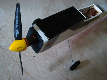

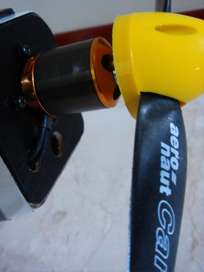

      I might try a 9x6 and do some static testing to see if the esc can cope. Is a 4s set up commonly used for planes or do people tend to use 3s (i.e. does a 4s set up have a history of frying esc's)?

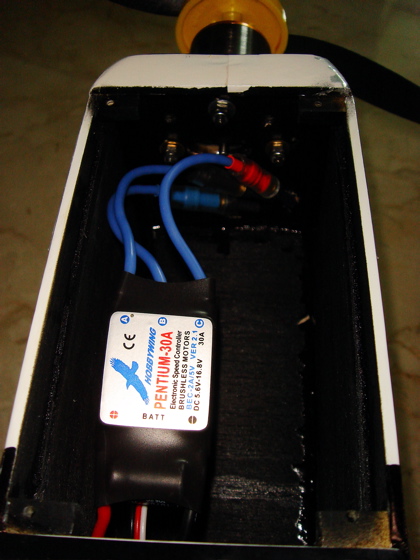

        If you want to go 4s, you must have a matching esc. I.E. a esc that is designed to work with 4s. Most of our esc today can work happily with 4s if you do not use/stress the bec in the esc and keep within current limit.

            I've seen ESC specs being quoted with BEC enabled and disabled... now I know why, so thank you. The motor calc will be very useful but I need to be in the office before i can download it (I use Mac at home ).

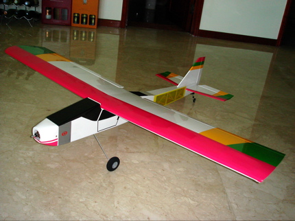

            Ok, looks like I'll have to do some prop shopping next week... here's the current state of the plane minus the prop and spinner. BTW, she is designed to use stardard servos on aileron, elev and rudder... so your point about stressing the BEC is well taken
