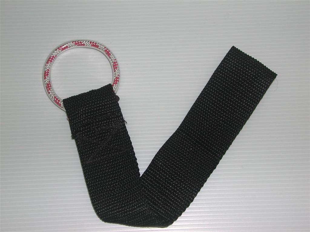

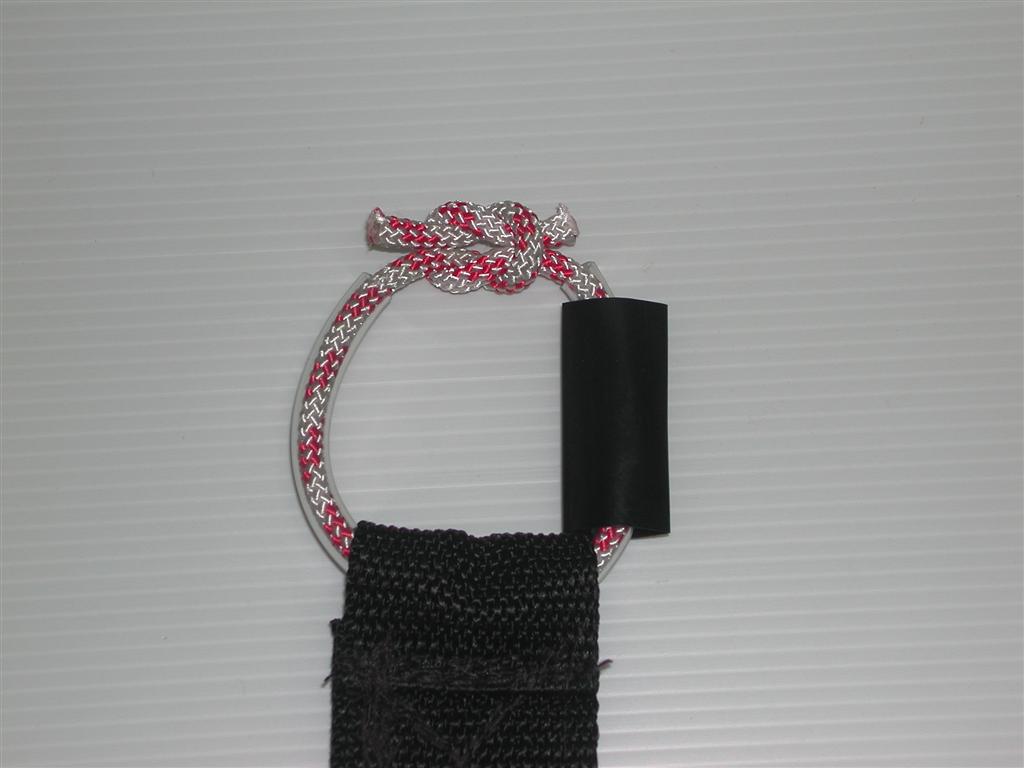

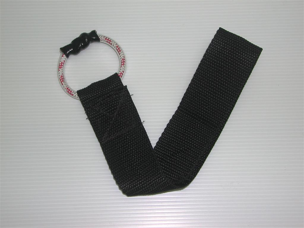

            DIY Kite Killer
            Just finished my Kite Killer.
            Materials
            1. Nylon webbing from discarded bag. Sewn to similar shape as the straps.
            2. Plastic tubing - from neighbourhood aquarium.
            3. 4mm/450kg dyneema blend cord - Marinetech.
            4. 6mm bungee with external polyester braiding - Marinetech.
            5. Some shrinkwraps.
            a. Thread dyneema cord through the plastic tubing.
            b. Thread cord through the strap. Tie up the cord.
            c. Shrink wrap the knot to tidy up. Also helps to secure the knot.
            d. Rotate the finished cord to hide the knot.

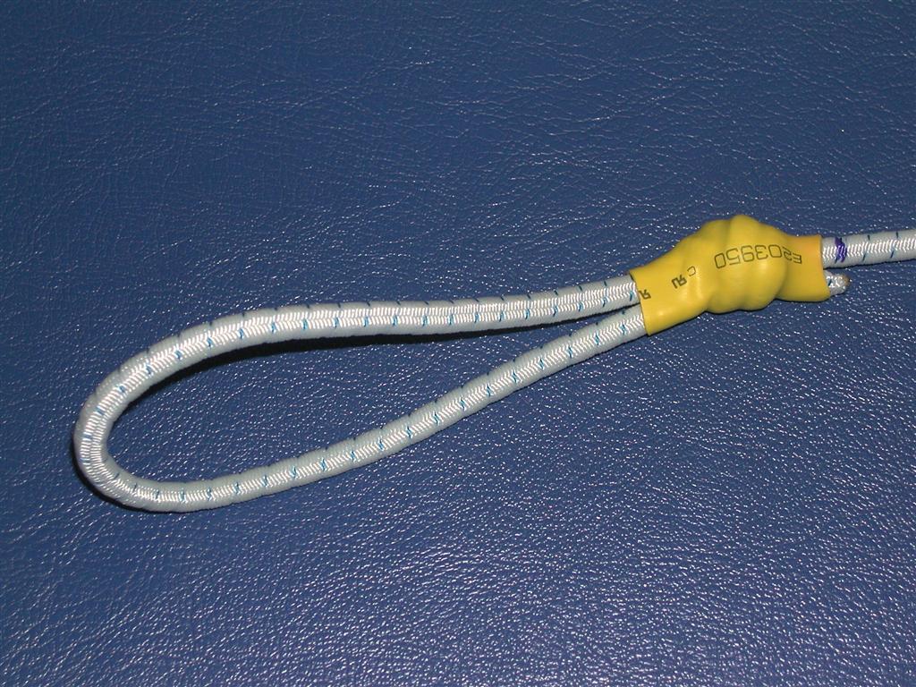

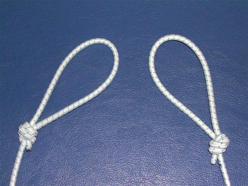

              Con't.......bungee cord.
              e. Knot bungee cord at both ends to make loops.
              f. Tidy up and secure the knots with shrinkwrap.

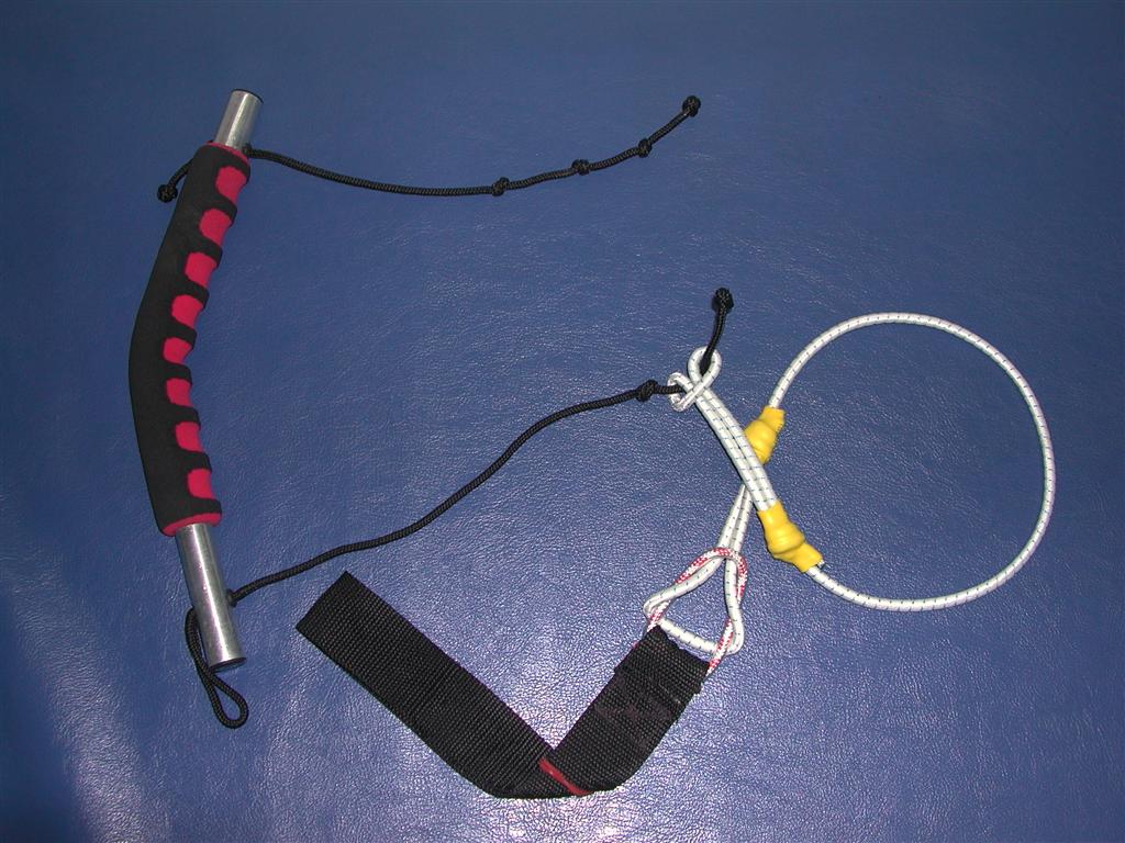

              g. Larks-head to the strap and viola! DIY Kite Killer!
              h. The other end is larks-headed to the brake lead to complete the picture.
                I guess the next thing to do is wait patiently for July.
                MA, it really looks good! I shall file this post for future reference!
                I can haz diving?
                  No choice but to improvise. Difficult to buy kite killers here. Ozone has nice ones but Bilbo doesn't sell them loose. Don't think I want to order a set of handles just to get the KK.
