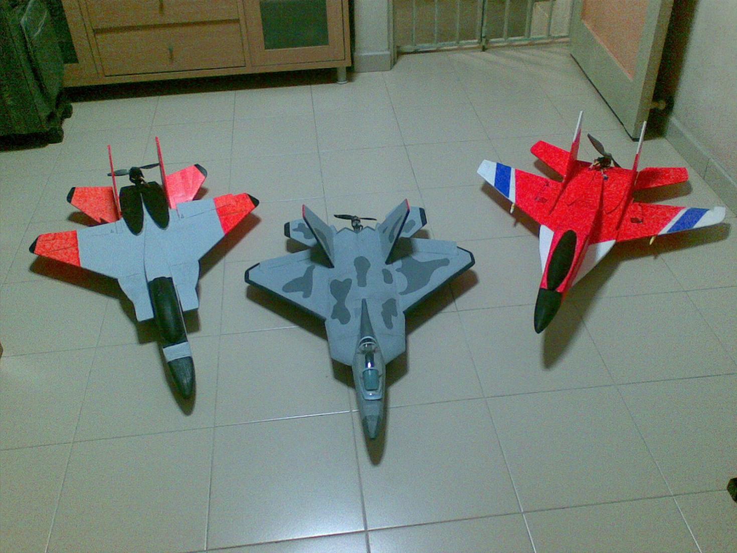

                        for you
                        Originally posted by romihensem View Post
                        opps... thanx to helichoo for the recommendation too...
                        Hi no mention it,
                        Share with you my toys.
                          hmmm
                          very nice bro... maidened mine today. sweet flying... hehehe

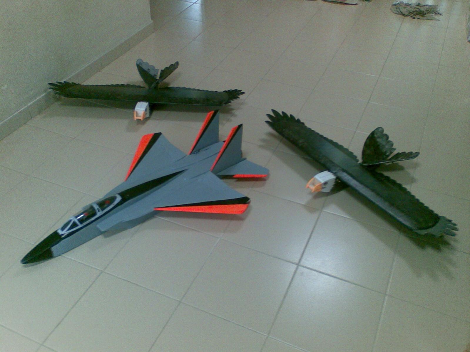

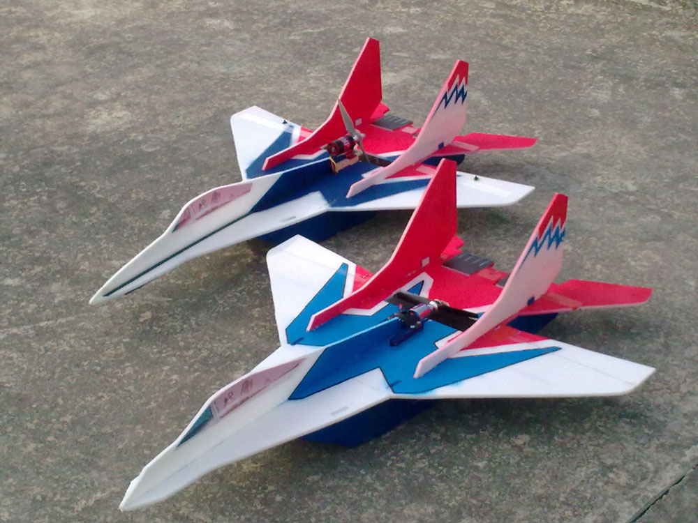

                            some snippets just now too...
