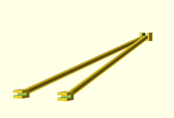

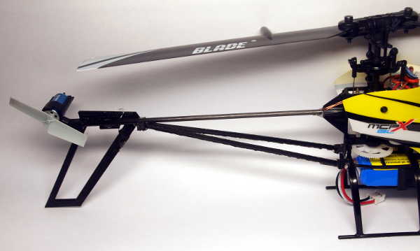

Got an MCPx BL? Tired of that tail wagging? Part of the reason is the flexibility of that carbon fiber shaft. Here's a quick fix:
All you need is to somehow support that tail boom, and the wag goes away. If you have easy access to a 3D printer, PM me for the stl files, I can't seem to upload them here.
