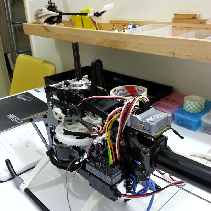

    Hello, had setup my Atom 500 with the HC3-SX (had made a larger plate to mount the HC3-SX). However, the "look" isn't very "nice" (please see picture) as way the wires goes up and down isn't great even when the wires are cable-tied neatly.
    Does anyone have any suggestion for mounting the HC3-SX onto the Atom 500 that make it look "good"? Appreciate your sharing.

    Bro, any updates at yr end? I would love to see the bailout feature on yr atom.
    Heli-ADDICTION:
      go to sim lim towers to buy cable mesh tubing. as the mesh is expandable, you can slip the cables through it. on each end of the
      mesh, you can finish it off with heat shrink.

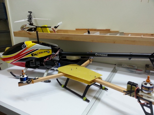

        Hi guys, thanks for the interest and advice. I managed to build a new "platform" to mount the HC3-SX on the side frame and make it look neat (and nice to me). Anyway, too much work and too little time left for hobbies this few weeks. I also crashed my Tricopter so am building a new Tricopter at the same time reworking the Atom
        So hope to test flight the Atom this weekend - keeping fingers crossed to have time to do it. Will keep you all posted once I try the bail out function. Then perhaps we can find a place to fly together and share.
