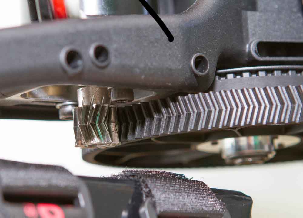

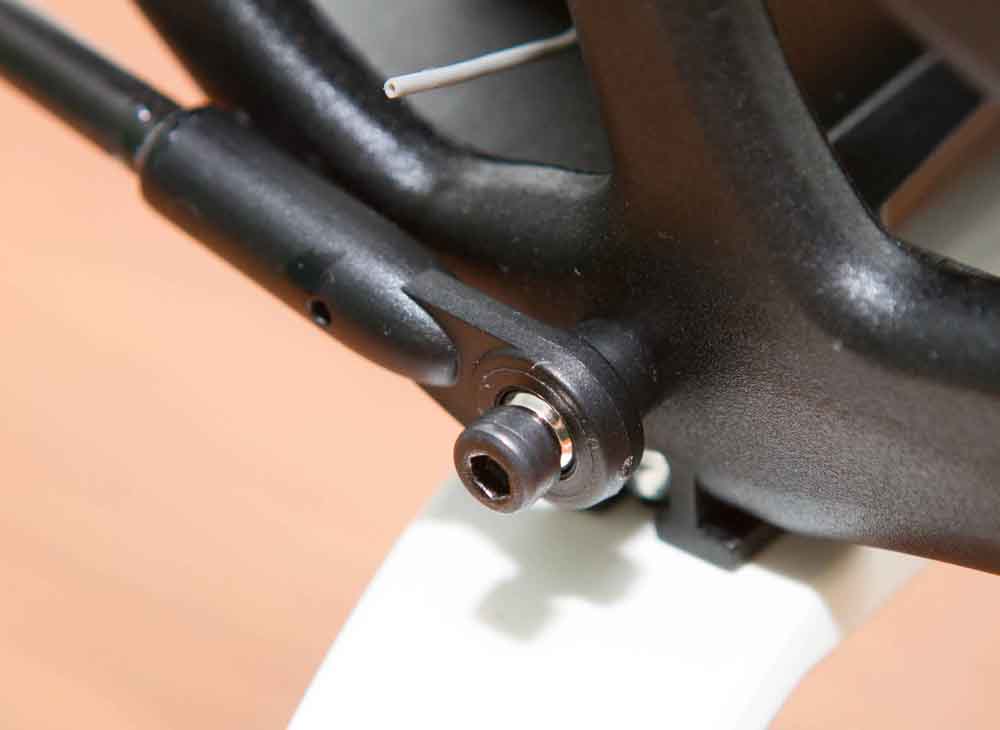

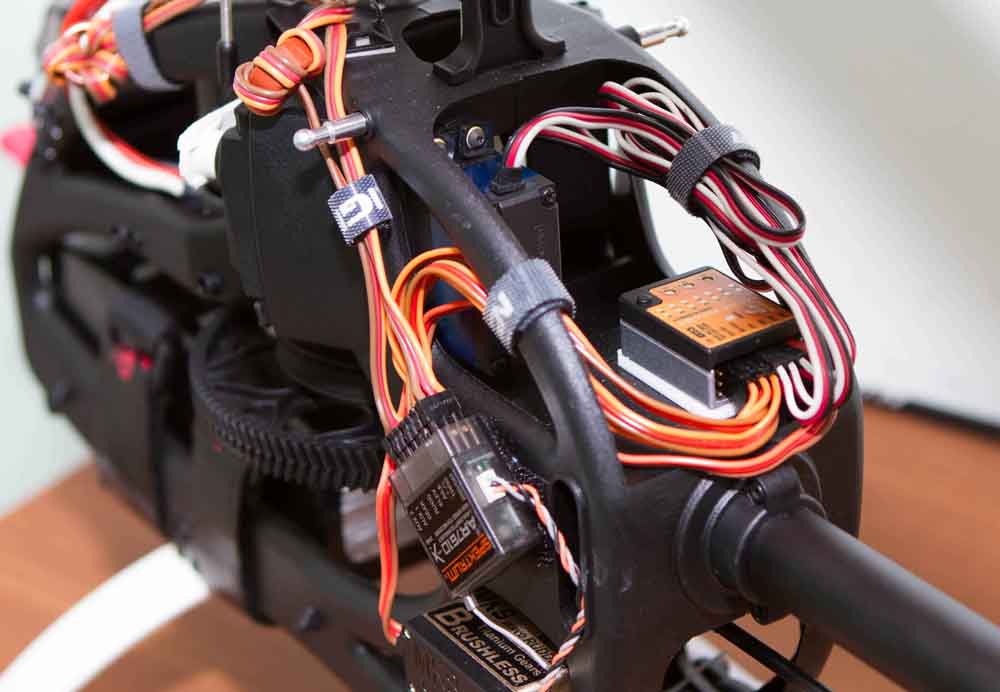

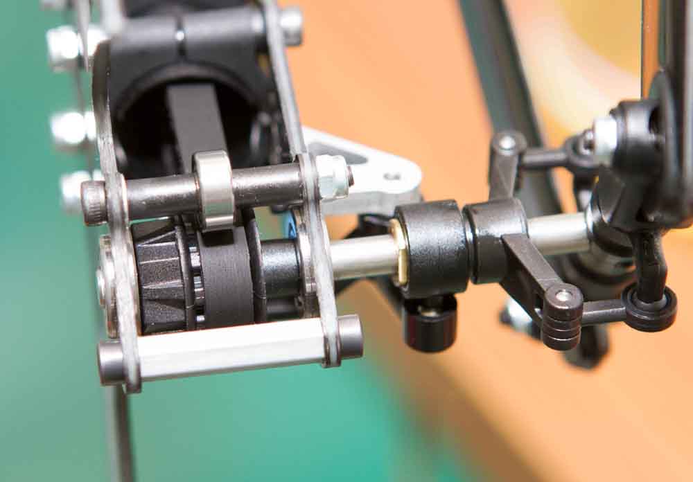

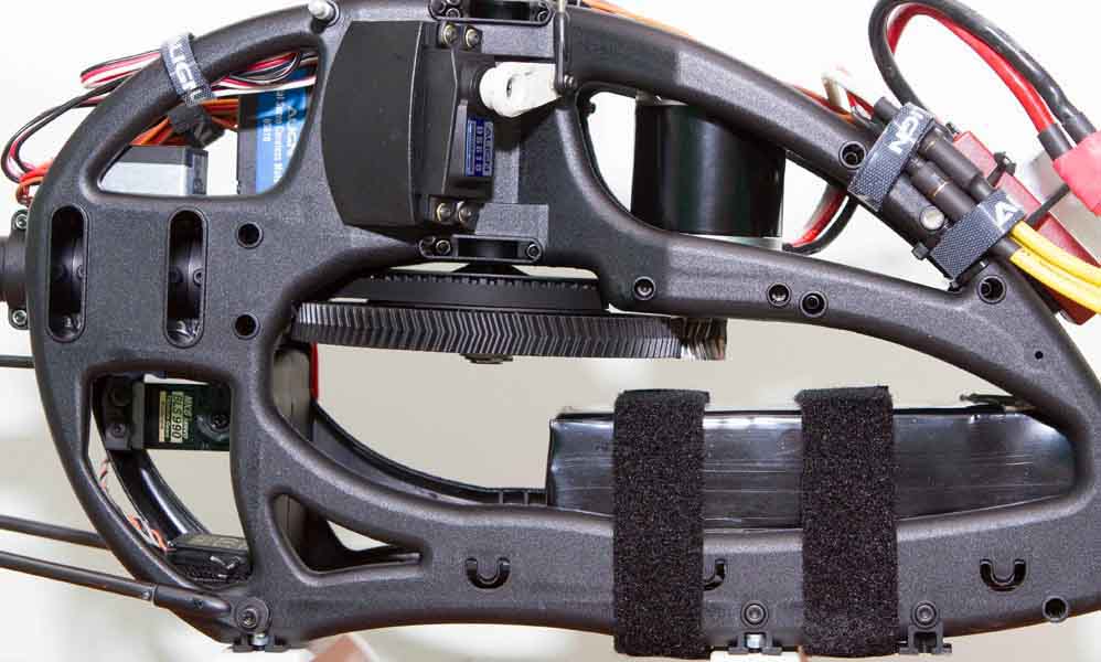

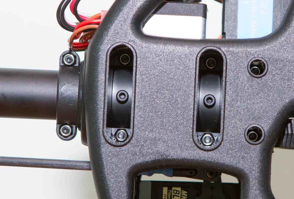

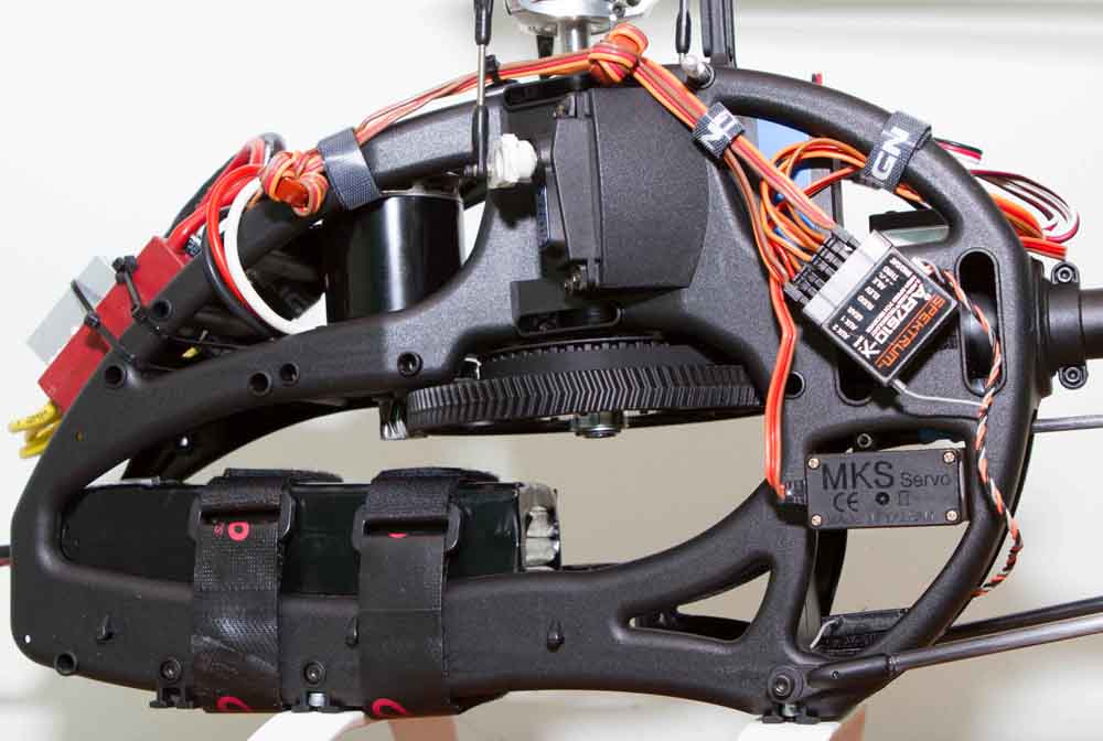

Maidened my first Logo 500SE early this morning, very happy with the flight performance.
Just to share my setup :
- Logo 500SE Kit (from RCS)
- Motor: KDE 600xf 1175KV (6mm Shaft)
- ESC: Kontronik Jive 100LV with heatsink (ATV Calibrated)
- Gyro: Microbeast X V3
- Servo: Align DS610 (cyclic) , MKS BLS990 (tail)
- Main Gear 106T Mod 1. Pinion 11T.
- Main Blades: Align 600mm
- Receiver: Spektrum AR7610
- Transmitter: DX7
Heli Settings:
Headspeed: 2035rpm (normal)- 45% Throttle / 2200rpm (idle 1)
Tail gain : 45%
Collective pitch: 12˚
Cyclic pitch: 10˚
Motor temperature is about 47.5˚ c.
Overall impressions: Quite happy with the build, went smoothly for me. Took about 3 days to build and set everything up. Heli is significantly lighter than those of the same size category, mainly due to its plastic construction. (the plastic is very tough).
Maiden flight was a success, no complaint so far.. Only complaint is the manual (not that easy to understand, some of the diagrams are not detailed).
