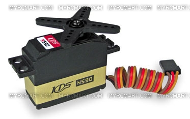

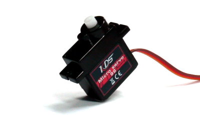

                          How "high end" is the tail servo? Maybe you can give the brand/model number? Gyro too?
                          Learning to setup on your own is not too difficult, and better for the long-term. There are excellent video guides on helifreak forum by this guy "Finless".
                            Stock: KDS 9G
                            Upgraded: KDS N590 Digital Tail Servo
                            • Digital servo
                            • Speed: 0.08/60 4.8V 0.07/60 6.0V
                            • Torque: 2.0kg/cm 4.8V 2.5kg/cm 6.0V
                            • Operating frequency(Hz): 300
                            • Dimension: 35.5mm x 15mm x 28.6mm
                            • Weight: 25g
