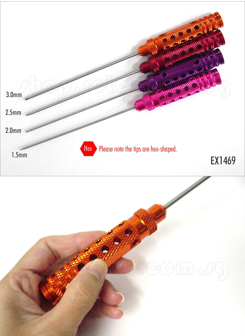

                            rotor screw set?
                              missed out a word.
                              I meant the screw driver set.
                              http://shop.rotor.com.sg/show-detail...D4BA2F47}&pn=2
