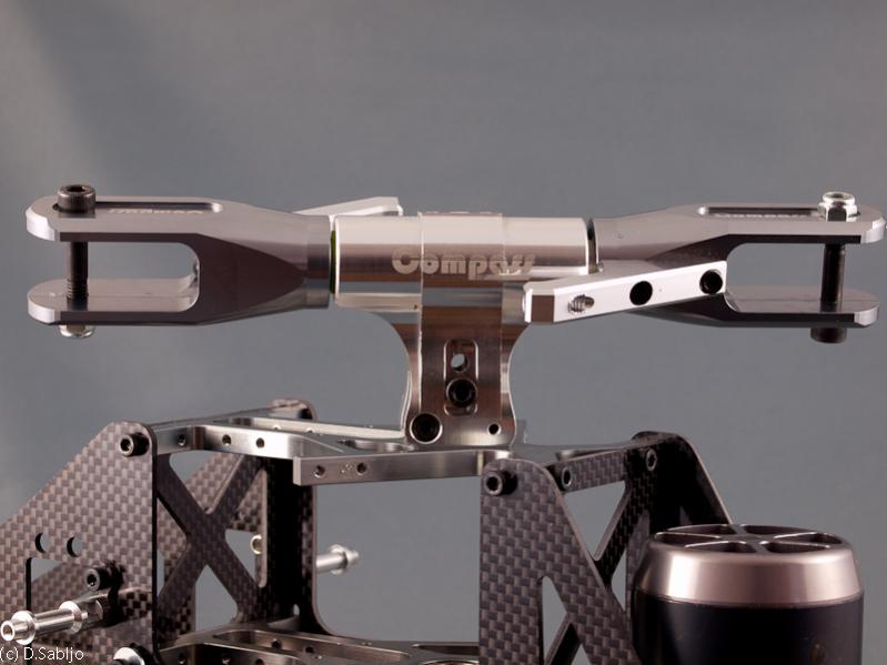

    ■The helicopter has been designed by Sebastian Zajonz, who incorporated many years of experience in the design. This design avoids unnecessary complexity. Thus, the 7HV no push / pull servo linkages, and it has a relatively low parts count.

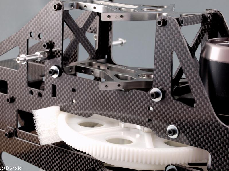

    ■The single-stage transmission with large diameter and 1.0 module gear takes the punishment of the strongest motors and provides an efficient transmission.

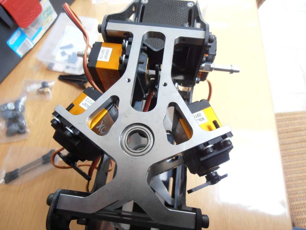

    ■Direct servo-to-swash linkages are equal length and have linear movements. Angle-Error and uneven movements found on many other products can limit performance, and is therefore eliminated.
    ■With the future in mind, the Swash Plate and Rotor Head geometry was optimized for flybarless.

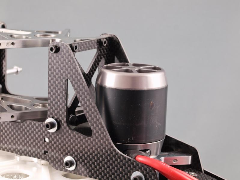

    ■All servos, the speed controller and the motor have been placed at the height of the tail boom and the battery is very close to center of gravity.
    This arrangement ensures a very high center of gravity, which increases the performance, so the 7HV can achieve efficient maneuverability and utilize the flybarless systems fully, yielding great results.

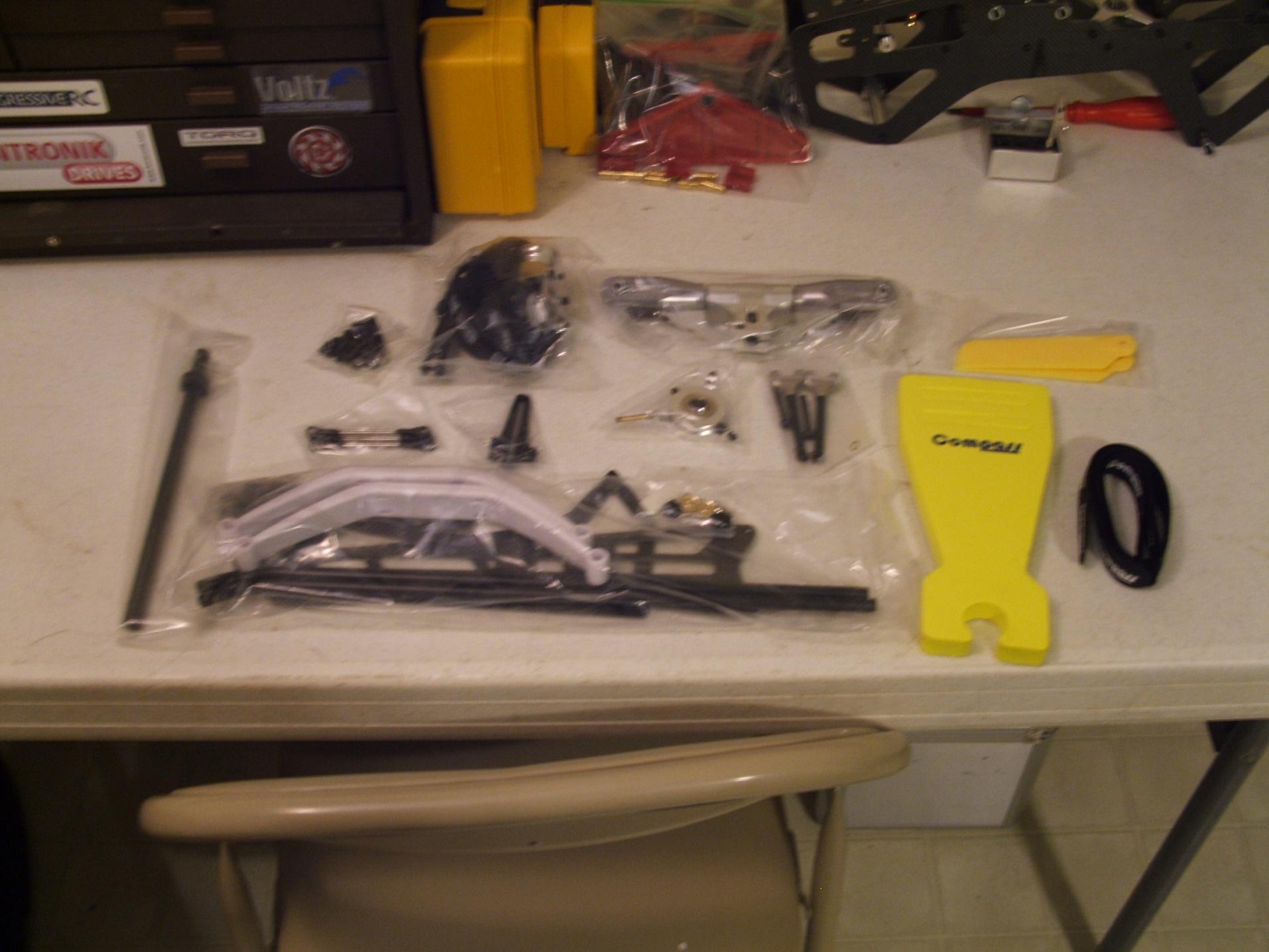

    Parts are well-packed, almost all assemblies are locktite enough. Only needs certain parts for re-confirmation locks. Internal body are reinforced with CNC machined cast high strength cross blocks. It has the lowest part count & came preassembled unlike Align. What I can say is this is one of the toughest beast to beat....

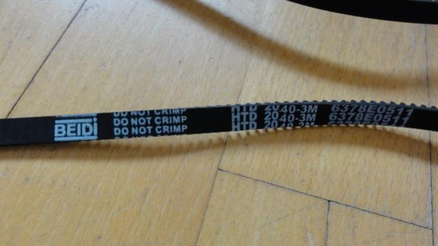

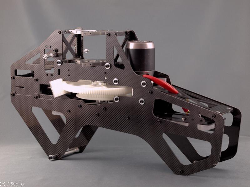

      Compass 7HV Frame is 2mm thickness and the Belt is "Beidi" 2040mm length x 8mm wide. This constitutes the tensile strength & holding power for this large beast. Moreover, the added flexible belt allows adjustment with due slack preferences for the tail.
