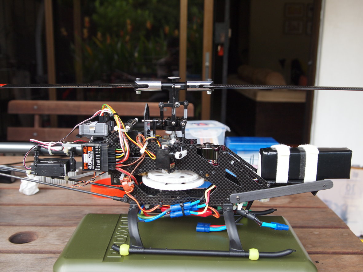

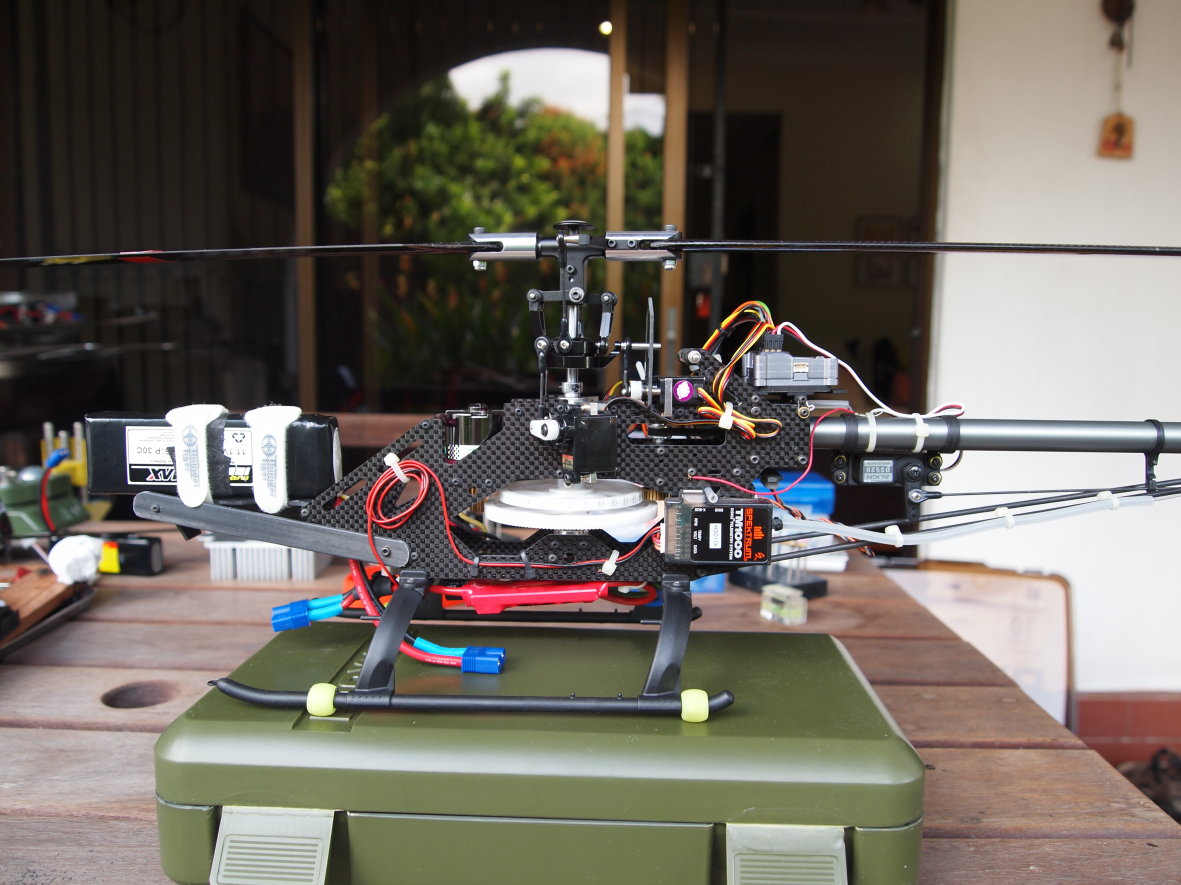

    Modification to FBL of course. I used a RJX FBL head and a TREX swashplate. I have also extended the battery bay instead of the need to put 90g to have a proper balance. The only problem now is the canopy don't fit anymore.

          The mtt v2 is inherently tail heavy and made worst with my tail servo upgrade to Align DS520 and the addition of HC3sx for the mod to fbl.
          Prior to the mod, I just move the battery way forward to get the balance.
