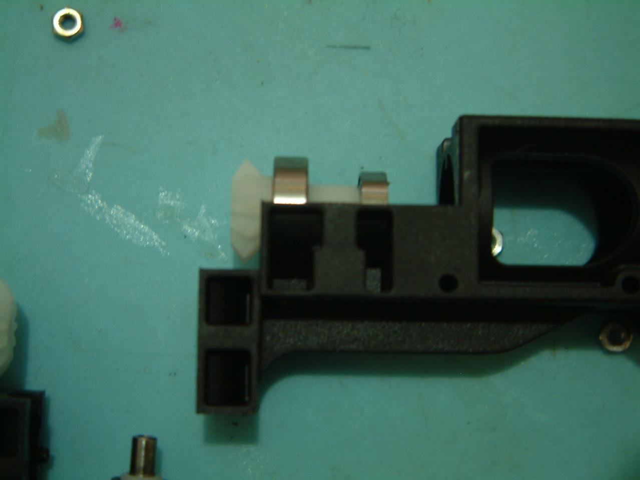

I am using Mini-Titan heli for this scale. Due to this scale heli is a "low boom" type, that mean I need to modify Mini-Titan (MT) so that to "route" the tail drive downward instead.

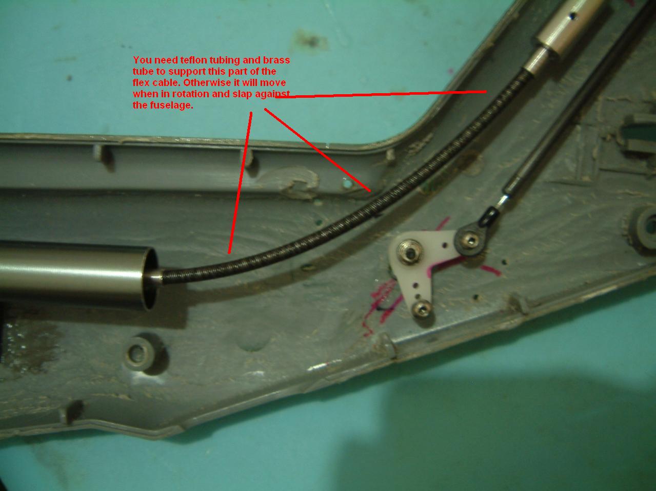

This time, I decided to use drive shaft method instead. But in this case (due to "low boom" heli), I use flexible cable instead. The normal usage is for R/C Marine (Boat).
MT's drive shaft is 4mm diameter. I can't find 4mm diameter flex cable in local hobby shop, so I use 3.17mm or 3.18mm diameter flexible cable instead.

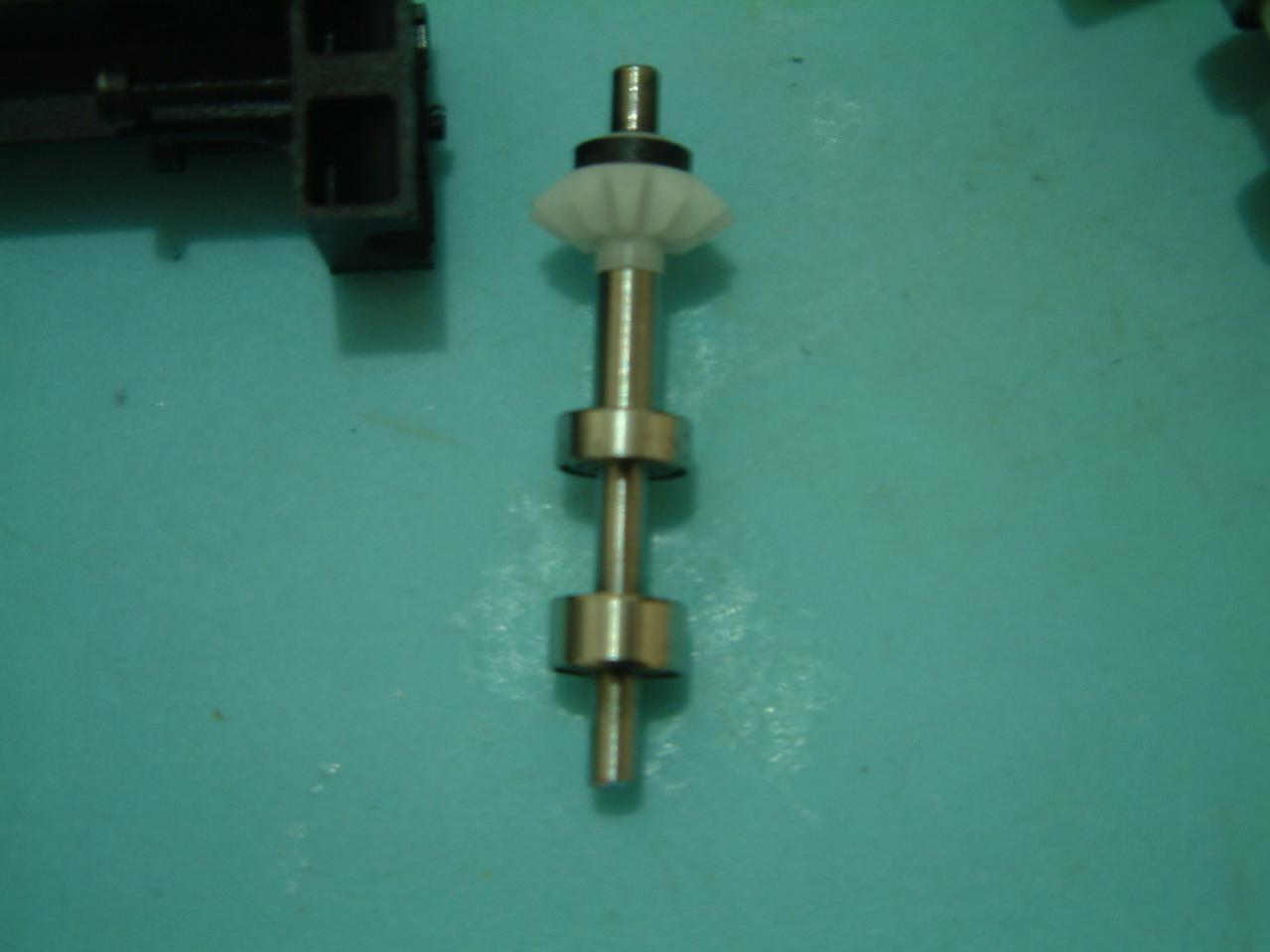

Why I did not use TRex450 Pro (also shaft driven tail), is because TRex450 Pro's main to tail rotation ratio is 1:4. This is considered way too low for multibladed heli. For shaft driven tail, to change tail rotor is to change the bevel gear...which is very difficult to achieve.
MT's main to tail ratio should be higher than TRex450Pro. That is why I decided to try MT with shaft driven instead.

By using MT with shaft driven (but in this case, flexible cable), if minicking of main and tail rotor rotation, the tail drive system required to be reverse rotation in order to achive the correct rotation.

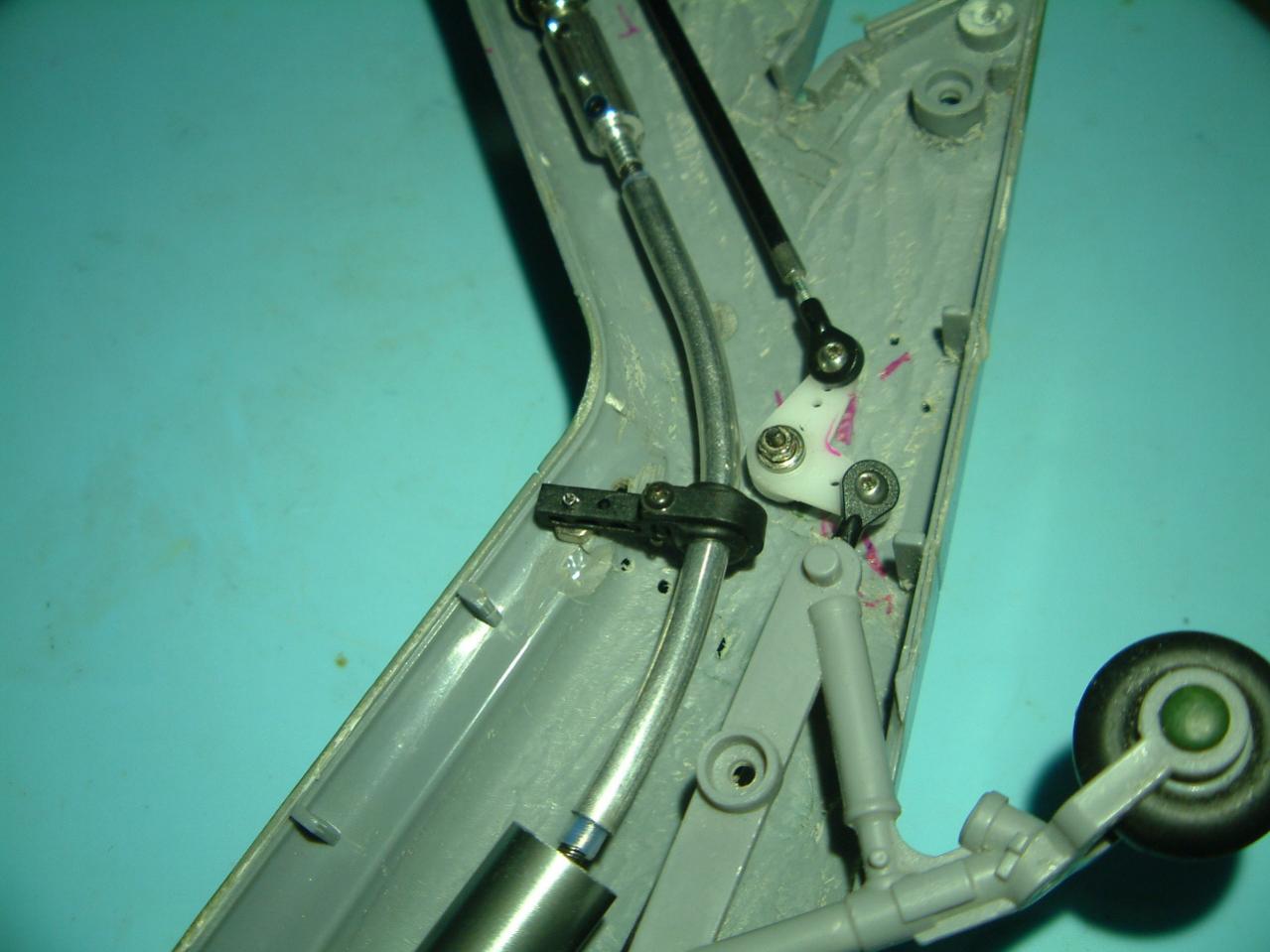

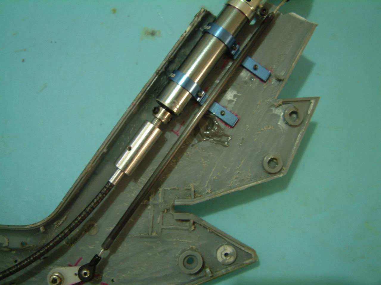

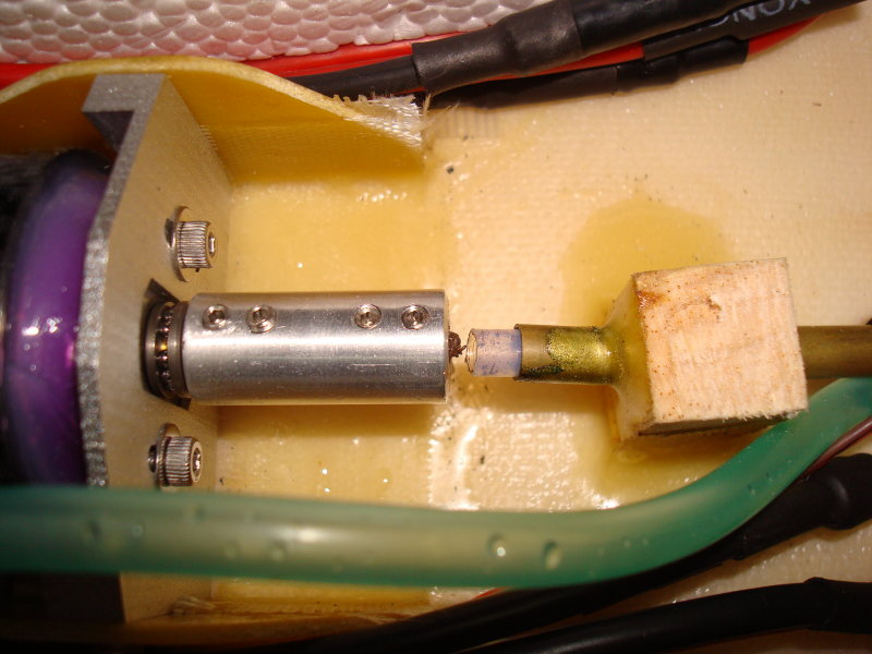

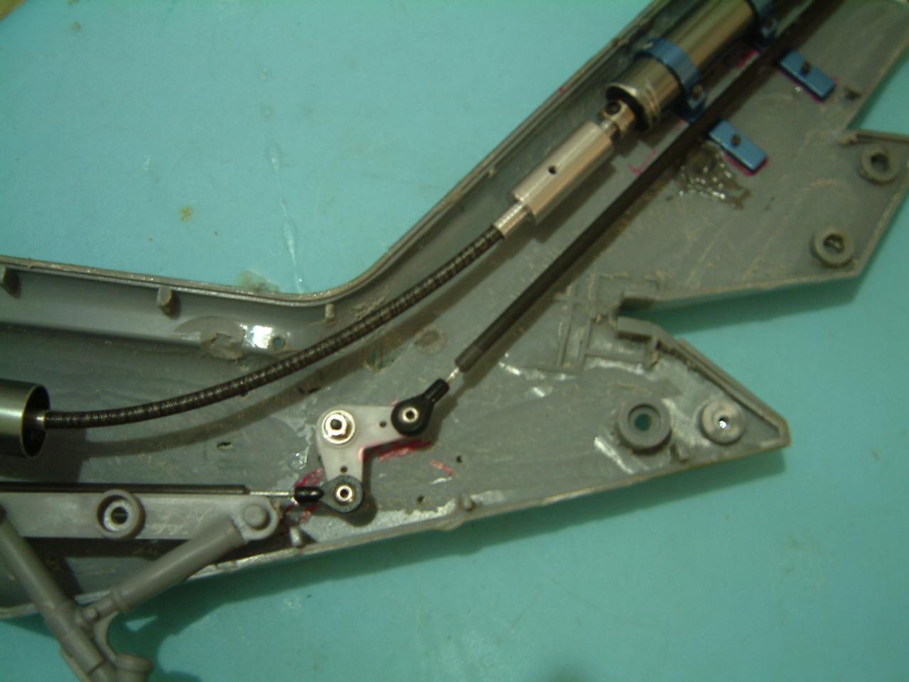

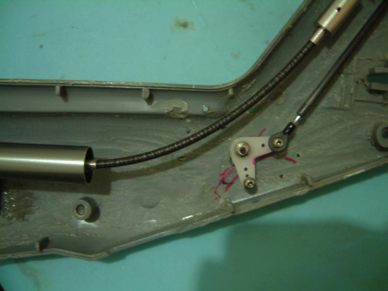

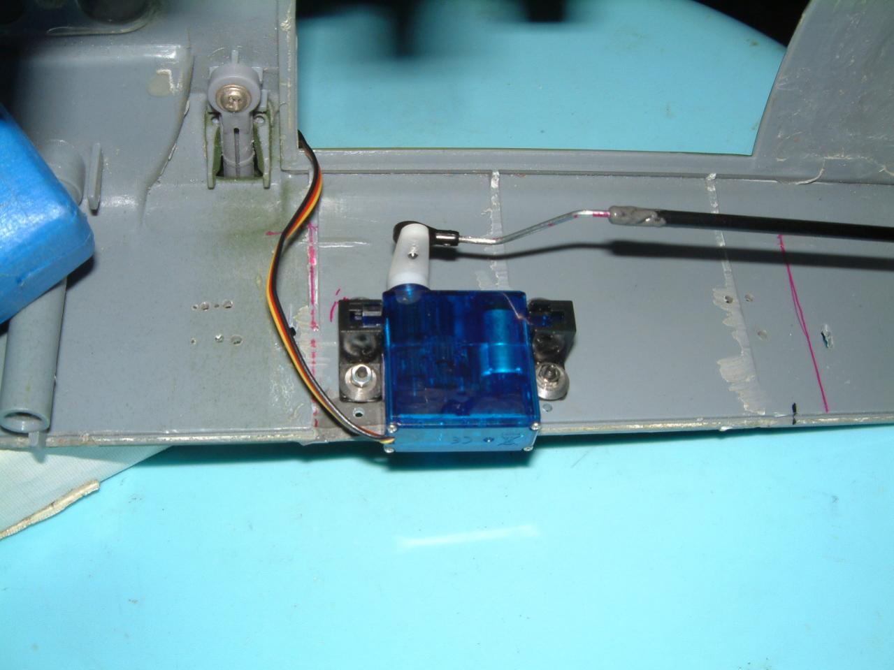

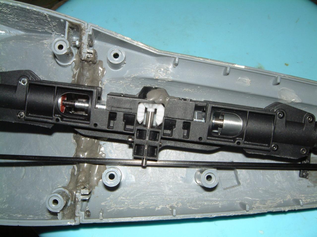

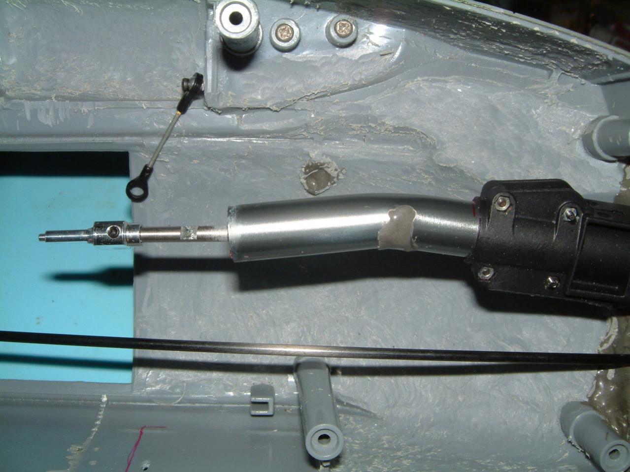

Here are the photo I took this afternoon.

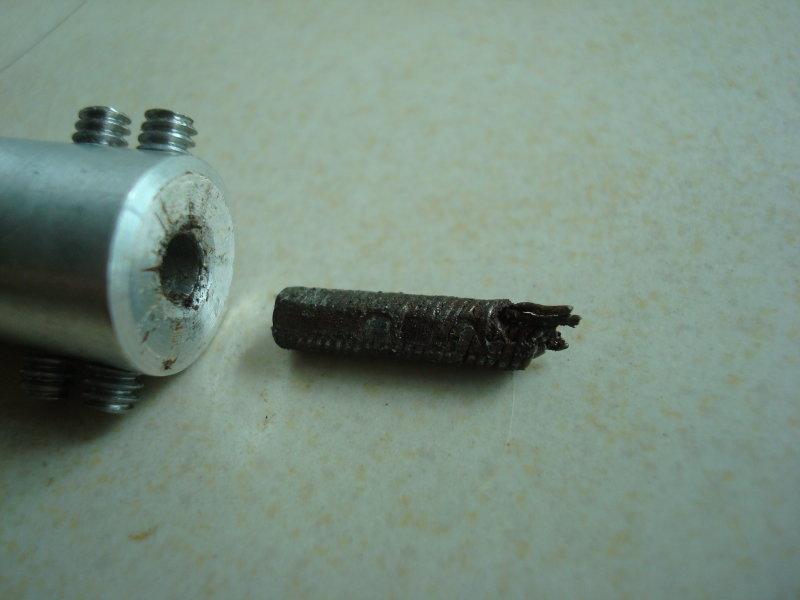

BTW I run my flex cables at ard 30,000rpm.
