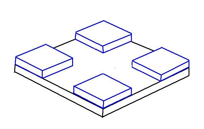

    I am using a 20x20mm piece of the above tape at the bottom, with another 4 pieces of 7x7mm squares at each corner of the 20x20mm. Effectively double layer.

        Arranging the tape in this manner is goood...
