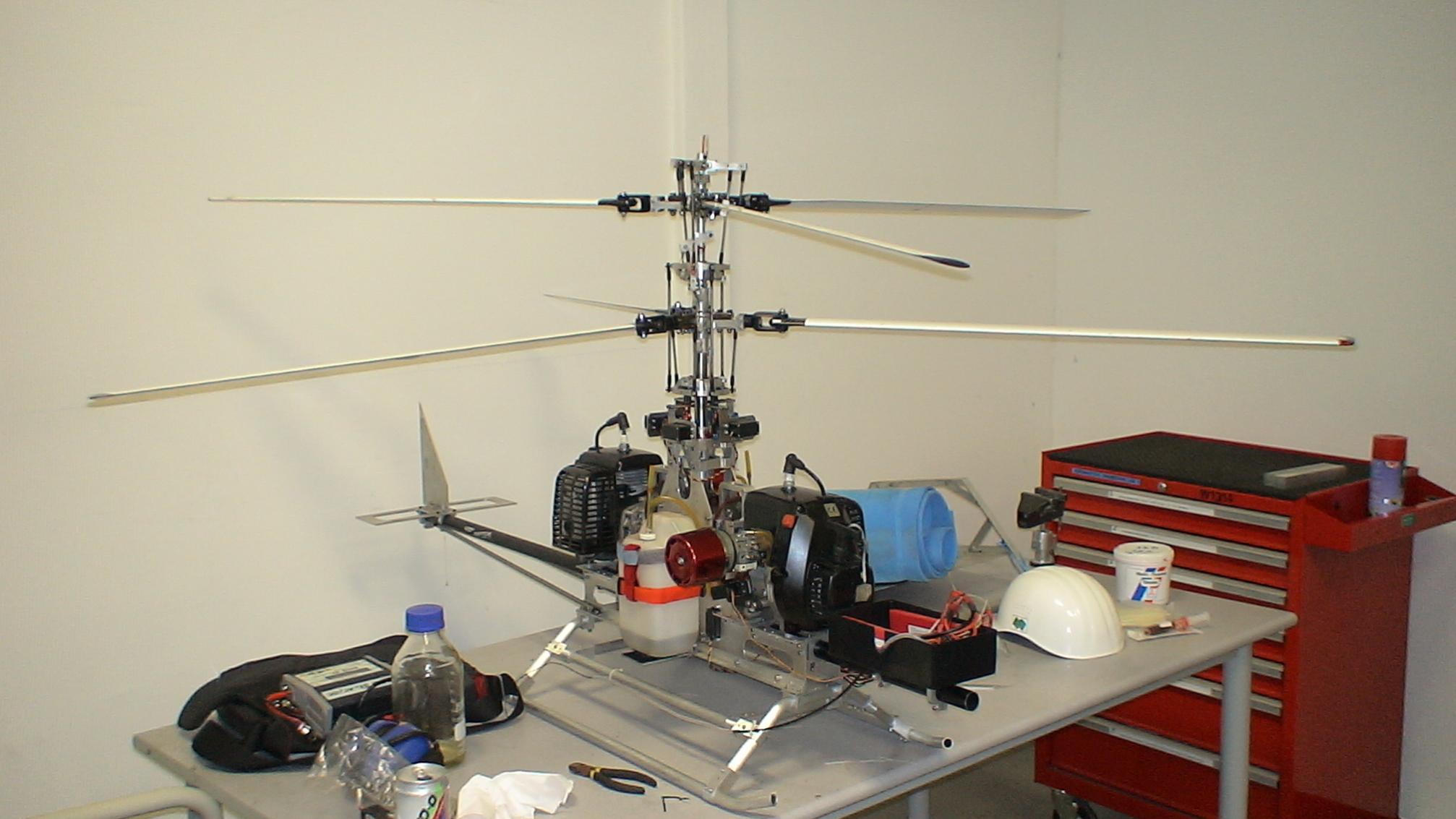

    project of mine.

        Question.
        Why is it a three bladed coaxial??? Wouldnt a two bladed coaxial with FBL electronics do?
        What is the flight duration???
        Is it noisy than say a 600size electric heli???
          What engines is the heli in the first two pics running? Petrol? Could be a stable platform for aerial photo or video

            Engine looks like 1/5 gas buggy..(Petrol). My guess it should be a 26cc.
            Looking at the tank, should go at least 30~40 mins.. Hope i'm right.

              project of mine.
              Test flight already ? Bro , can update the news ?
                flew many times already. duration is approx 40mins. fly until shag. two bladed coax is not as easy as a three bladed one due to the weird geometry of passing links through the lower head to the upper swash plate.

                    Almost everything is custom machined

                      not that fun to fly leh...kinda boring one
                      all the differential pitch coaxial helis in the market including those from kamov and other full scale coaxials use three concentric shafts in total. i've got a design that uses only two shafts, is very compact and significantly simpler than the current version..
