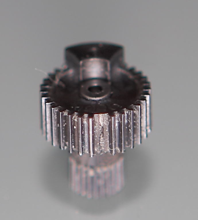

                  Thanks for all the help..the mystery is solved.
                  The problem lies with the aileron servos, one gear teeth is missing and couldn't hold the neutral position properly.

                    We always get to learn from each others problem. Will add this to part of my problem solving.
                      That is the so-called "karbonite" gear of the hs56!!
                      hahaha.. power man!!
                      Anyway, glad to see problem solved!
