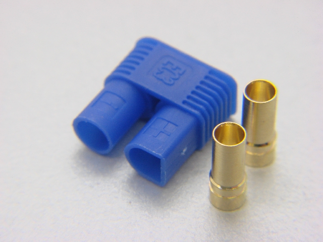

        erm , i suggest you get rid of the deans and change it to something like EC3 styled connectors ... like this : (pic below)
        Advantages:
        A: they are alot easier to solder than deans ...
        B: red coloured ones can handle up to 80A/100Amps depending on which type you buy..
        C: they are easier to pull out and attach
        Disadvantages:
        A: you gotta resolder alot of connectors if you got alot of batttery packs
        B: gotta find the connector for your charger. or resolder your charger port.
        honestly , after buying some turnigy backs from .. with EC3 connectors its really easier to connect/disconnect

          Bro: where can get in SG ?
            Not sure if jet hobbies have them. I bought mine from Hobby City (HK) but mine is EC4.
            You might want to consider Anderson Power Poles (sermos). No need to solder. They work efficiently even rated for 45A I've used them for even high AMP application. I have it on my 450 and my Monster Trucks...Singapore Hobbies have them...
              does it look like this
                Yup the connectors at the bottom of that photo. They have the connectors only at the store but not on the website. You might be able to get cheaper ones online.
                this is the actual connectors...
