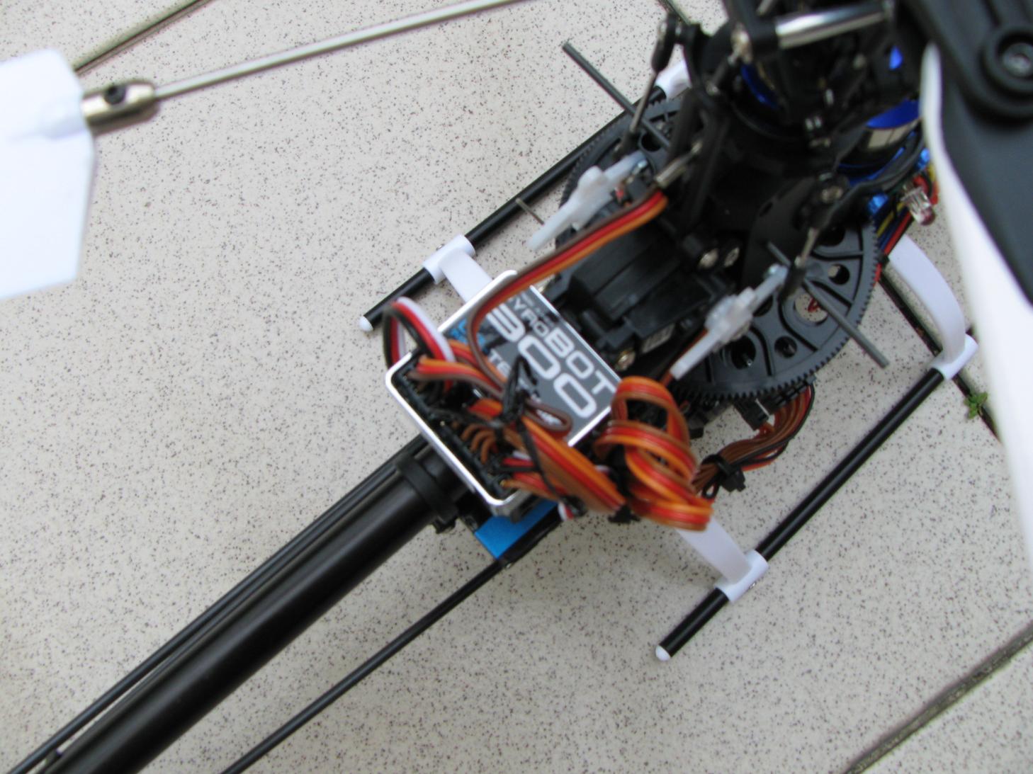

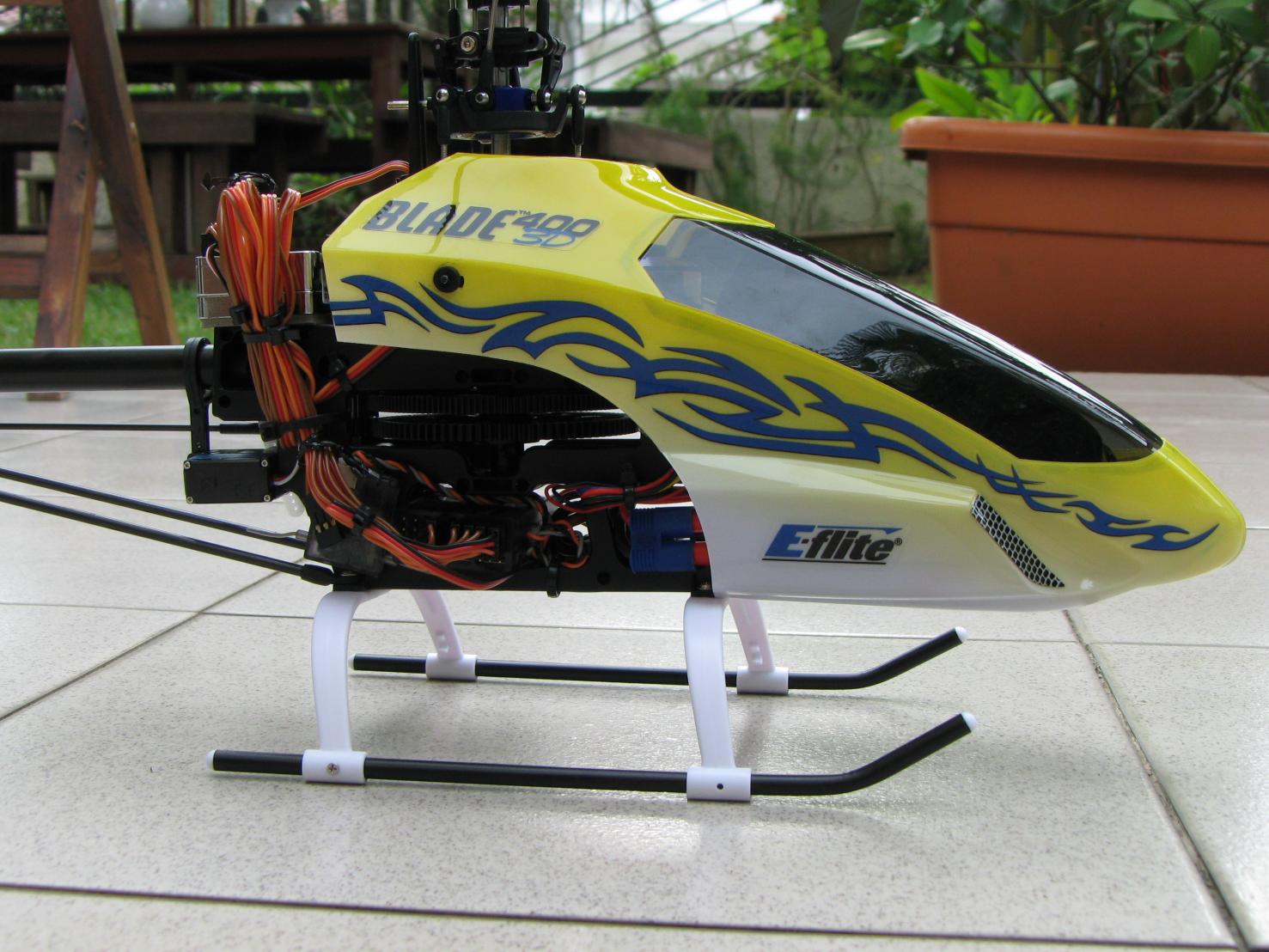

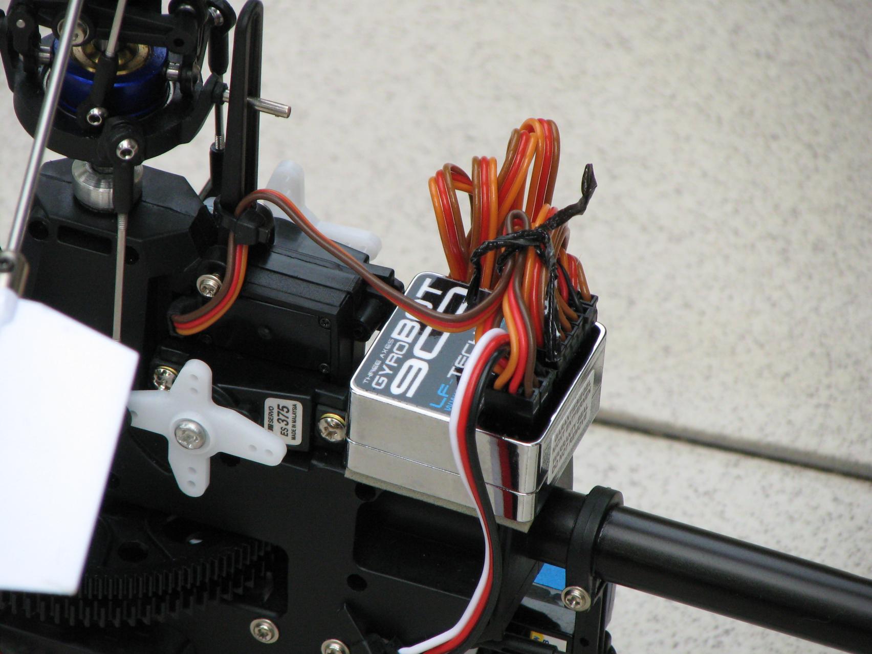

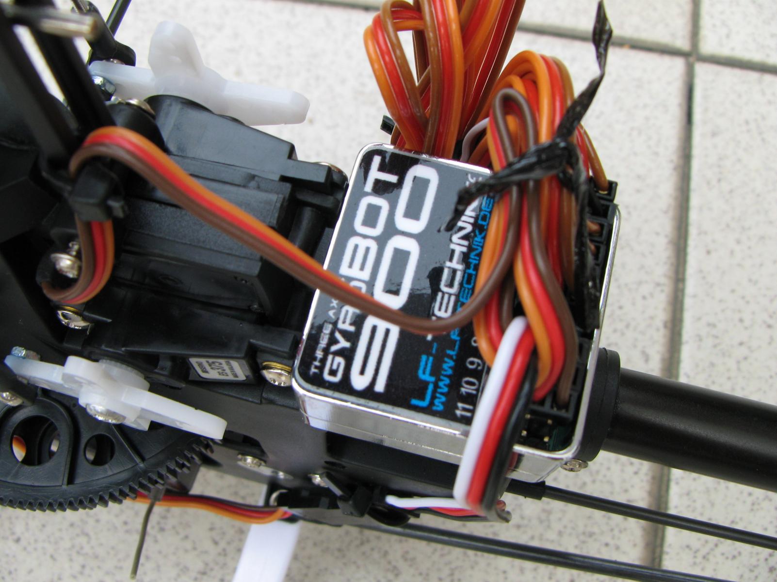

                    I am using beginner mode with flybar on a flybar Blade 400 heli. I had flown from a truck car park which is paved using concrete and that is as level as I can get without using spirit level. I had made sure my swash is set properly and absolutely perpendicular to main shaft. When I start the hover the heli start to oscillate as if I am moving my cyclic in a circular motion.
                    It is not steady that I can have a hands off like the video.

                        [ATTACH]70231[/ATTACH]
                        [ATTACH]70232[/ATTACH]
                        [ATTACH]70233[/ATTACH]
                        [ATTACH]70234[/ATTACH]

                            The tail is perfectly steady. It is like you move the elevator/aeliron simultaneously in a circular motion putting the head downwards tilting to the left then back the right side then head down.

                                Looking at one of your 3rd picture...it seems like pin 10 is not used. But I believe it was only when you took that picture.
                                If blade 400 is a eccpm heli, your pin 8,9 and 10 must connect to all the three cyclic servos. But I believe you have already got this right, but good to double check.
                                I also assume you can fly with Beginner Mode=OFF and flybar=ON without any issue. correct?
                                What are the three setting on swash tunning for your beginner mode?
