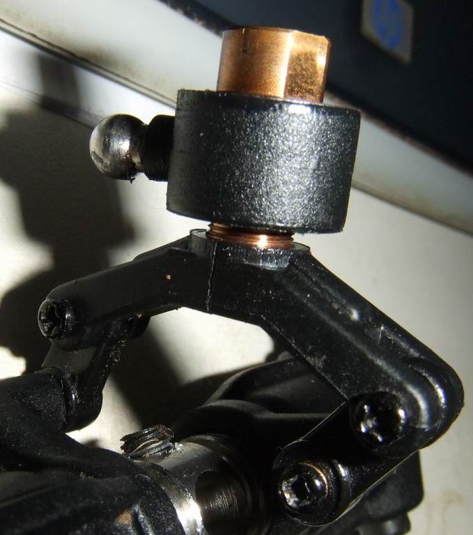

Found a crack on the tail fork, not too sure if ive over tightened something or just too much stress.. either way .. ive already upgraded to metal version.
