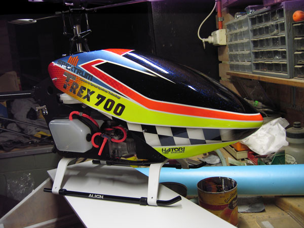

    Hey by the way I found a kick butt canopy that totally changed the shape of the trex 700..the one that comes with it looks nice too but this is really killer.
    wow nice canopy.....Wonder if there is one for the 600N
