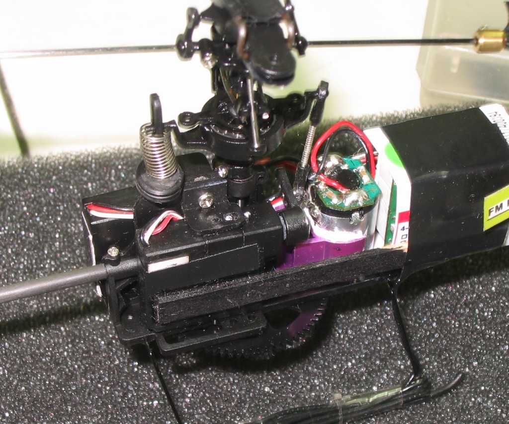

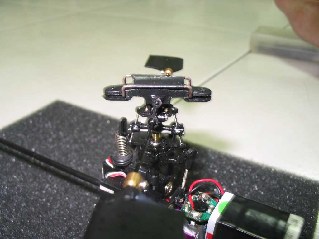

            manage to "free up" the fly bar ......
            this is how it works like , hope is good enough

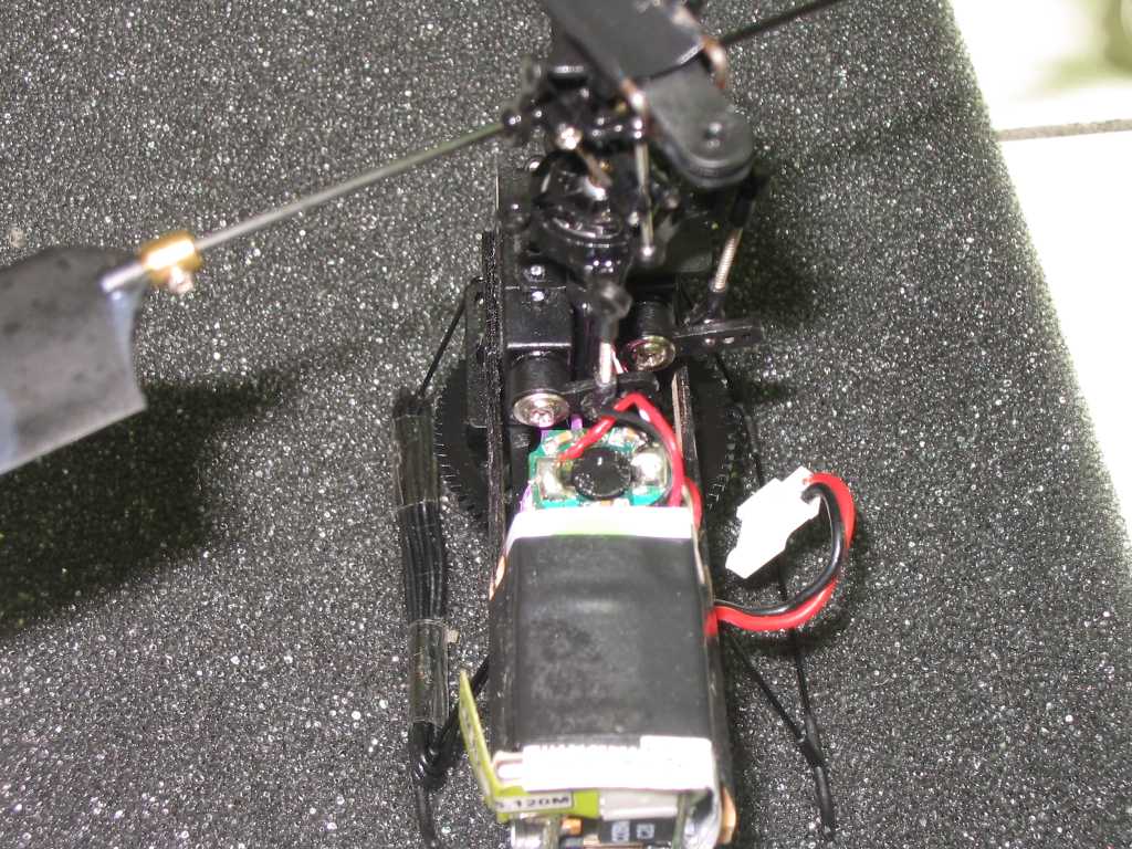

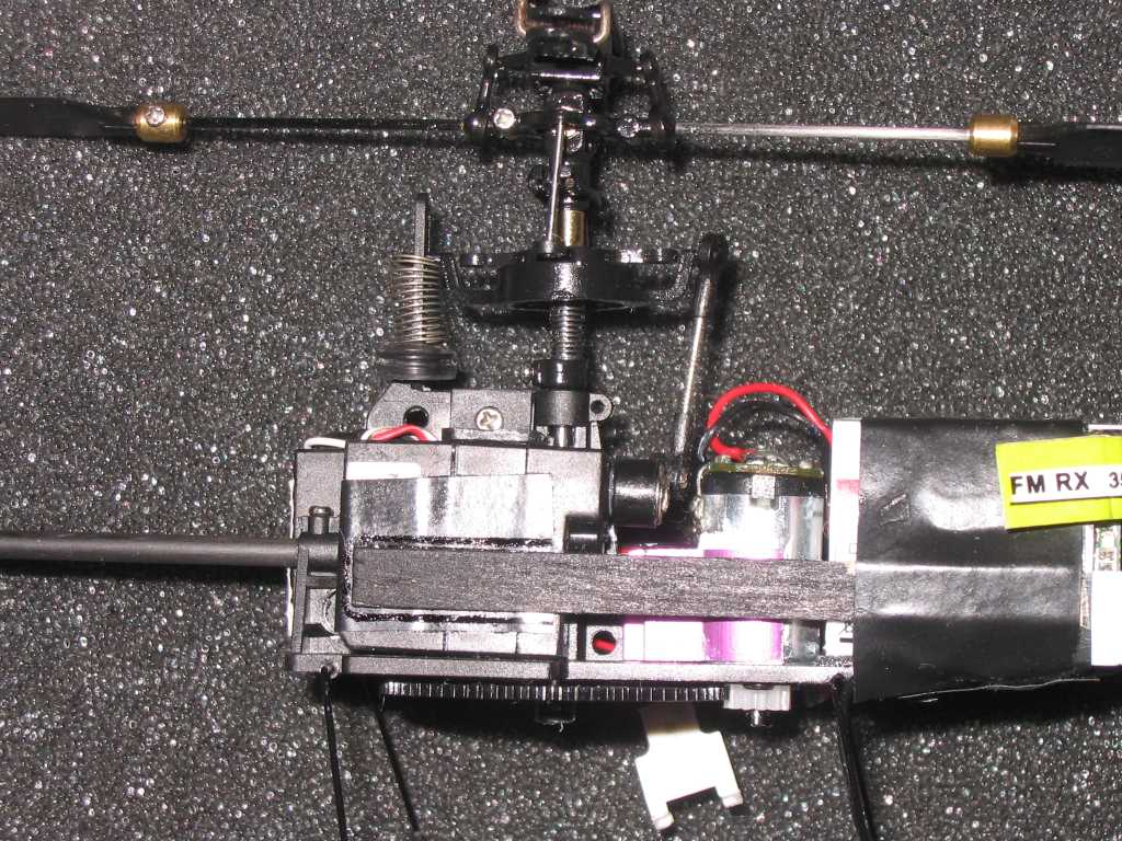

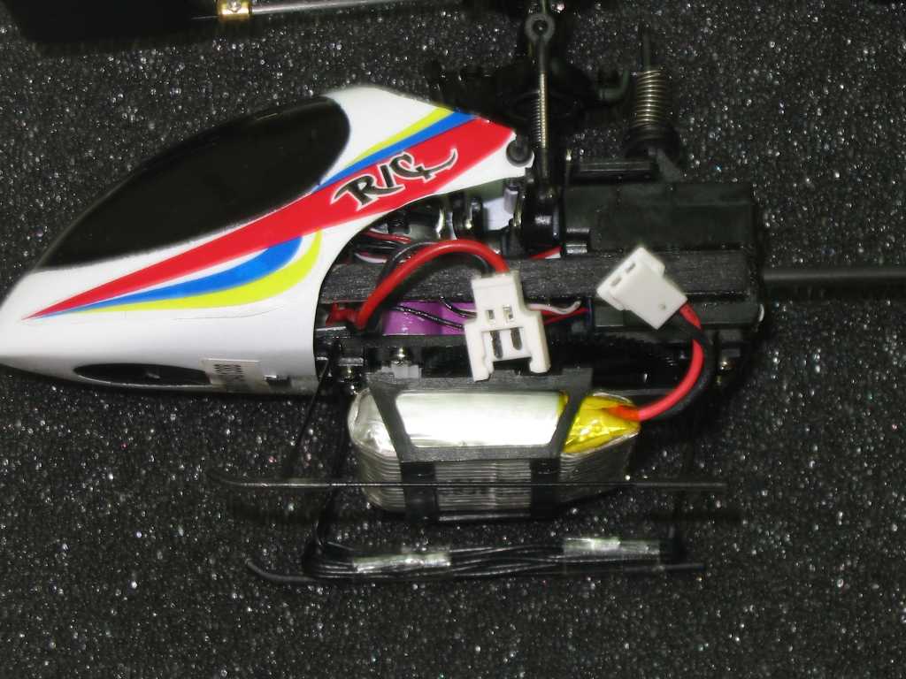

              This are the mods I did on this little heli
              1) swashplate mod to hold it in position
              2) shifted the aileron servo in
              3) heat sink for motor
              4) balsa strip to strengthen heli frame
              5) tape 4 in 1 to prevent vibration
              6) wire at blade holder for strength
              7) battery holder mod to load battery from the back for proper CG
              8) servo link move in by one hole
