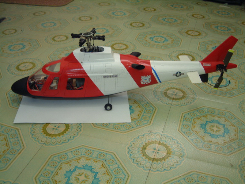

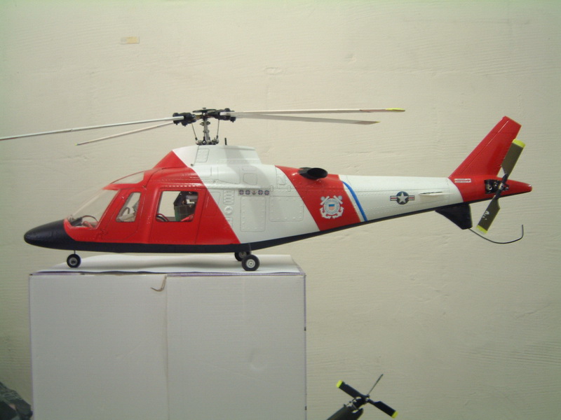

    Here is my MH-68A Stingray scale. It is Align A109 with TRex 450XL.
    Feature:
    Four bladed main rotor.
    Tilted main mask/shaft for realistic effect.
    Because of the main mask/shaft is tilted forward like in real A109, it can do taxing before take off or after landing and do parking.
    Things haven't completed are:
    1. The "U.S. Coast Guard" wordings and some other wording as well.
    2. Two small wing on the wheel.
    3. Painted tail rotor. (Current tail rotor is from other heli theme)
    4. Route antenna outward at the tail.
    Things that might add/modify/do:
    1. 'P' Shape upper vertical stabilizer
    2. Navigation/Collision LEDs
    3. Cockpit
    4. Speed sensors and misc sensors.
    Photo Date: Sep 16, 2007

      Thanks! Actually the "Red" color is wrong color.
      Sell? No Way!! I WANT ALL MY SCALE HELICOPTERS!!!

        Is your 450XL using the push-pull linkage?
        Align TREX 600 N Pro With Skookum 720
        Align TREX 500 With TT GT5 FB
        HK 600 GT With EC 145 Fuselage Flying On Turnigy VBar 600
          It is eCCPM 120Degree with only 3 servos. Direct linkages.
          Tail is using home made flexible cable.
          SH

                To bad the Align A109 is based on Agusta A109C series. The real MH-68A is based on A109E series and there are some differences in the design/look.
                According to Rotor Hobby, they are bringing in Align's scale but don't know when will it be arrive. With that, if u want the scale now, u have to online order.
                Whether Mini-Titan can fit into or not.. I not sure because I do not have Mini-Titan.
