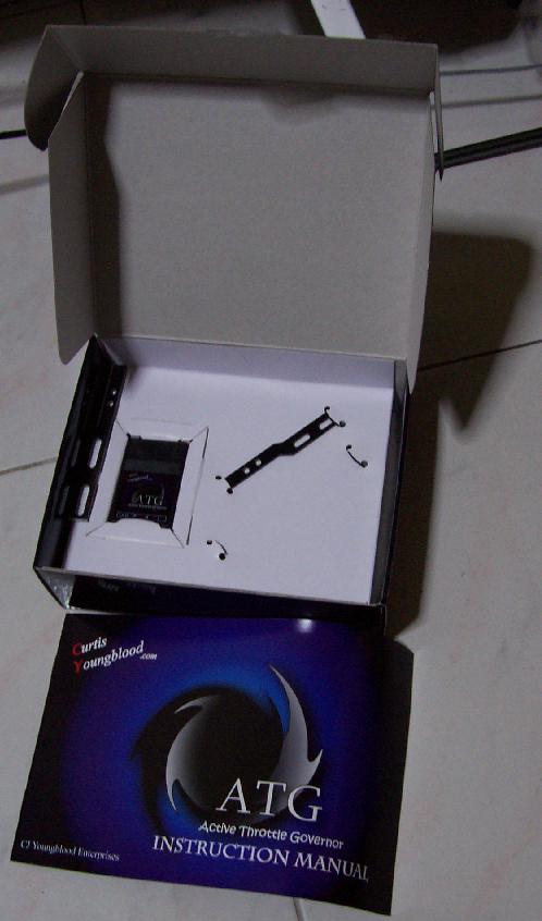

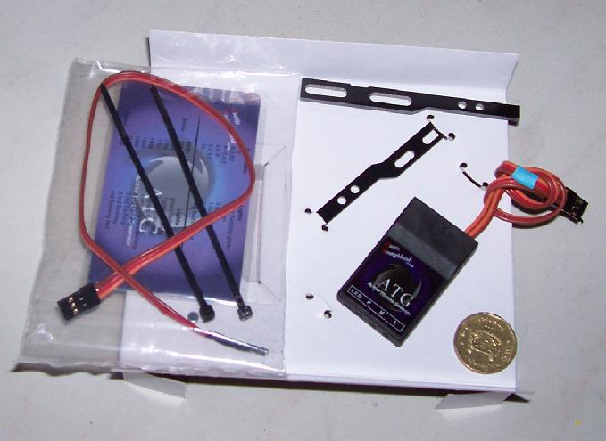

        #33
        As a sucker for governor .. i grab a set of ATG (Active Throttle Governor from CY product) from RadioControl-Sports!
        Here are some of the pics..

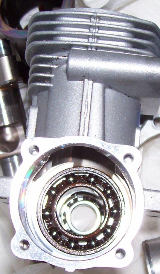

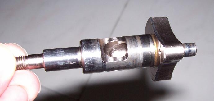

                    Updates
                    Rear bearing rusted (not obvious in pic) after 4 gallons of CP 20%!?
                    Replaced with new bearing and did crankshaft mod .. will see how long the bearing last

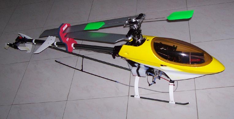

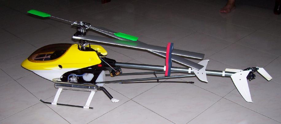

                      #40
                      squeezing one more titan into my heli pad

                        Mine is also rusty after 3gallons+. In fact, I have been getting a very consistent 5gallon lifespan out of my bearings. I usually just change the bearing after around 5gallons, since they always come out rusty and notchy. I tried NTN japan, NSK and EZO, all japanese made bearings, but still same result. I am not using Coolpower though. My piston and ring always comes out shiny and clean, while my current plug has been around in the engine for almost 4gallons, so I guess my tuning is ok.
                          #42
                          tried the ceramic or SS bearing they suggested at RR?
                          wanna see if crankshaft mod works so i replaced with original bearing (OS aka NTN..whatever)

                            #43
                            Don't tell me you paid the $20 for the original bearings ah? I got NTN japan bearing from kian hoe bearing shop, 2 for $7.50. When buying ntn bearing do be careful, there is a NTN japan and a NTN taiwan. My thundertiger engine came with the taiwanese bearing. Difference between the two? I don't know, just the word japan sounds more quality
                            I wanted to try SS since they are quite cheap at local bearing shops, should be less than $8, but when I was at SLS bearing the other day, they don't have SS ones, so I just got the standard type. As for ceramics, I remember it wasn't cheap, but SLS also don't have.
                            There have been flyers in runryder reporting similar failure rate using the Stainless steel and ceramic bearing, but I think SS might be good for our humid climate.
                              #44
                              yes i paid a premium price
                              didnt know where else to get bearing that operates beyond standard working hour..
                              btw, how did u shut the engine after the last flight of the day?
                              pinch the fuel line and let it run dry?
                              can manually shut the carb?

                                #45
                                Besides pinching the fuel line and letting it run dry, did you apply "After-run" oil into the piston and bearings via removal of the backplate ? ....I remember this helped prevent rust in my 1/8 onroad car's engines inbetween outings (1-3 weeks) .....any periods longer than 1 month, I'll strip out the engine and do a through clean up !
