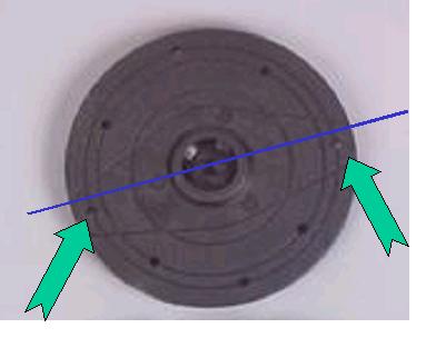

    just a quick question does it matter what hole you put the ball link in on the servo horn becuase in the instructions it had a template to cut out and i drilled holes on but i saw this pic and the ball link is on the out side
    so i was just wondering does it hake a difference(more pitch)

      When i was setting up my RJX hurrican, Frank told me the 2 rods should be equal lengths and parellal. I forgot whats the resons thou
        #48
        The most important is that the two links must be EQUAL in length. the wider or narrower distance on the servo horns will affect speed, torque, mechanical exponential on the resultant output.
        Do also check there is no binding.

            Servo horn
            So, what does it means? Should the ball link screw inner or outer from the center hole? The servo horn diagram in the manual seems to look smaller than the HS635 round servo horn. I used the existing screw holes on the servo horn. Although don know whether its is right or not.
            Can don use this round servo horn? Does the normal "straight" servo horn works on this setup?
            Also, don understand why servo horns affect speed & torque? Is it something to do with the blades pitch?

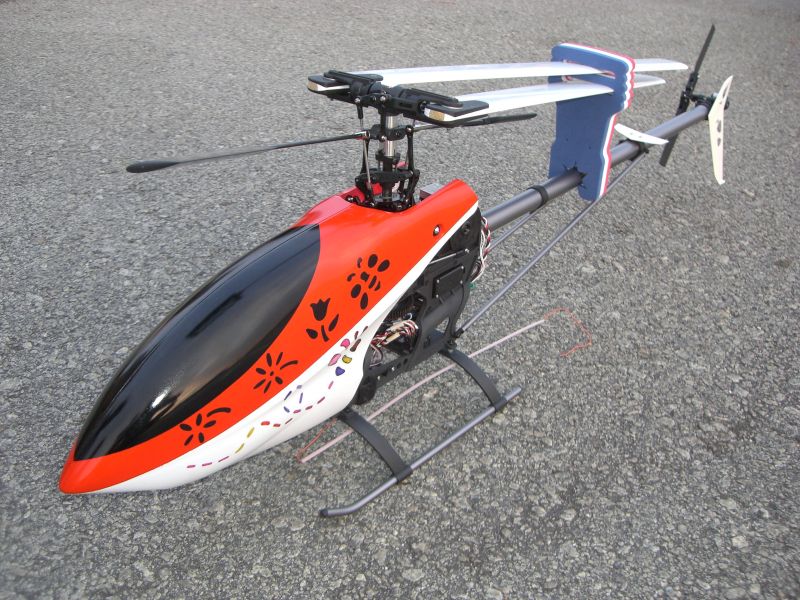

                                GUESS WHAT GUYS as soon as i got home from school i rushed up stairs and got my hurricane and went straight to the garage to fly. i took a few minutes setting up the gyro in rate then HH, lifted off the gound and started spinning i nearly shit my pants and thought thats it. All i had to do was put it in reverse.
                                I HOVERED it from left and right, did a few punches. THIS THING HOVERS WITHOUT YOU HAVING TO HOLD THE TX it stayed in the same spot and to finish i did a little auto from 2m and landed beautifuly right in front of me.
                                CANT WAIT FOR BISHAN ILL open up the throttle a little.
                                oh and my flight time was about 4.5mins and but if i didnt have to set up it would be around 6-7mins
