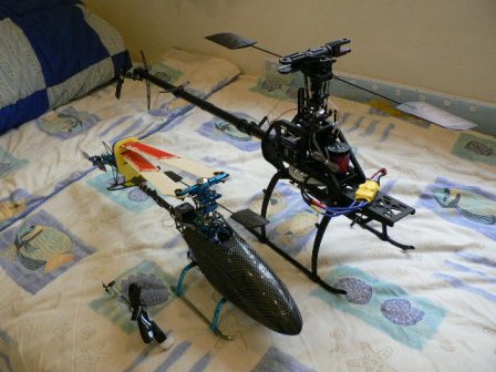

    Hey ppl here's a simple build thread on my recently acquired century swift (electric .30 size equivalent) from radiocontrol-sports.com
    My mildly powered sport setup:
    Hacker A30 8-XL
    Hobbywing 60A ESC
    Emolis 4S 3000mah
    Chopper comes ARTF but there are a few things to note. Rotor head rods linkage lengths stated in the manual are wrong (use those provided at swift-tuning.com).

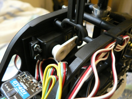

    The provided screws for the elevator servos are too short, so i had to use 3 x 20mm bolts and nuts to secure this.
    Also need a longer servo arm for the elevator servo in order to obtain a 90degree normal at the 0 pitch position.
    Some pics:

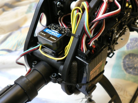

              are you using a BEC or separate RX batt

                        I'm using the integrated BEC on the hobbywing ESC. It is as capable as an external BEC and can take up to 6S.
