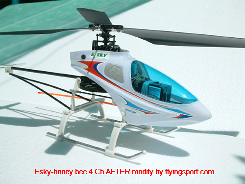

    I have a Honey bee Mark 2. i have just put some align skids on and it weigh's the heli down abit. i need more power, (bigger motor). what should i do.

              Think should be a 4ch honey bee fixed pitch heli with added reinforcements.

                    My Honey Bee uses the training skids with 2mm carbon rods and pin pong balls. The weight should not be too heavy for the heli to manage. Not sure the size of carbon rod you have.

                      here is a pic
                        Hehe! TRex landing skids! That is heavy for that bird.

                              Sori....I misunderstood your Align skids for training skids.
