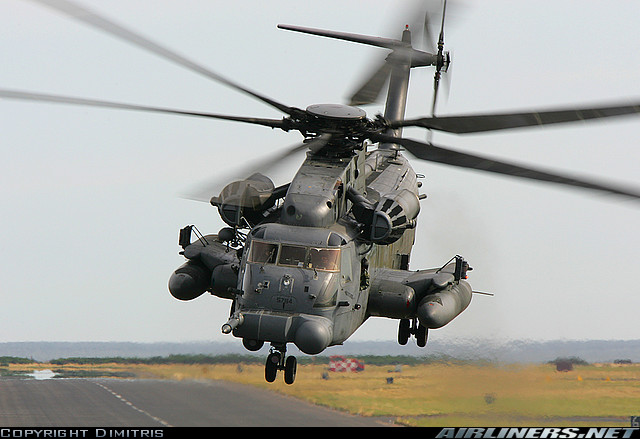

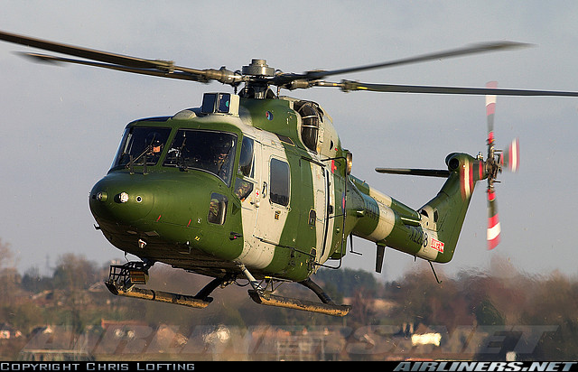

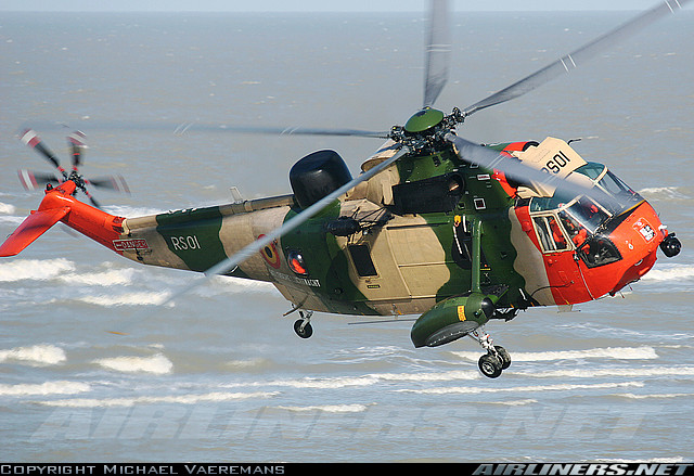

    Here are some of the pictures. (Sea King, Lynx, Super Stallion)

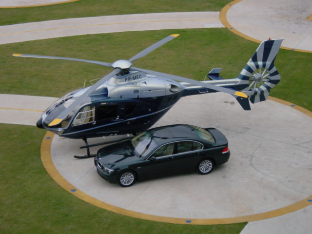

                Eurocopter does that too. I think they are only used on helis with 3 blades and more.
                It it said to help with aerodynamics. When you think about it, those huge american helis with tons of blades end up having enormous rotor hubs.
                Maybe it also protects them against rain and sand while the helis are parked... Not sure.

                Most of the time it just covers components around the rotor hub like blade fold accuators, pitch locks etc. On helis with heated blades, it covers the slip ring that powers the heated blades. On the 53 and 61 you can see a small cover in the center of the "bennie" that is a plexi cover to view the service level for the blade damper resv accumilator. The small holes on the 53 is access for servicing blade hindge pin resv on each blade.

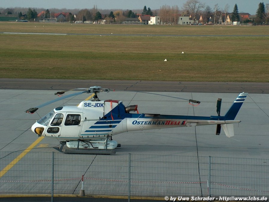

                i've always wondered about that too. helicopter express out of atl has a swirl on the top of their a-star and bell 407s that looks neat when turning.

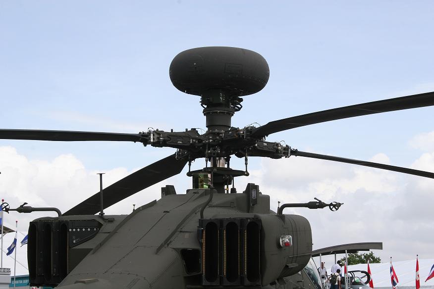

                              Here are a few more other heli that has similar dome.
                              As for U.S. Heli with dome, not only U.S. heli has it.. Sea King, Lynx (both British Heli), Eurocopter also have it.
