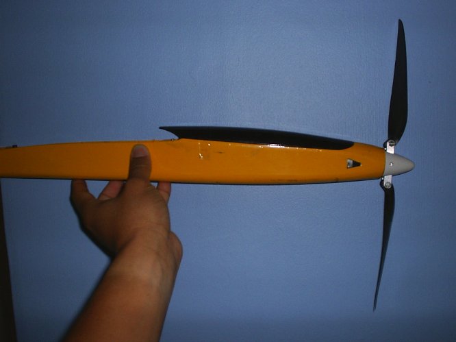

                            For your reference, my Maestoso's downthrust is pretty pronounce. In fact, I could even add another degree or 2 to cancel the last bit of pitch up tendency. But I decided to fly it manually instead.
                              wow very nice !!!!
                              must be fast!!!
                              may i ask how do you use spoilers? and when do you put the throttle on a switch instead of the throttle stick?
                                In the contrary, this is not designed to fly fast at all. It's a very lightweight HLG with a powerful setup to achieve very powerful climb, rather than to fly fast. The prop velocity is quite low but the static thrust is impressive enough to achieve close to vertical climb. For LMR competitions, you are allowed about 50 secs of power to climb and the rest fo the flight is done without power. This design is based on that.
                                I don't use spoilers for power gliders so far. I only use it on my scale gliders so far to dump lift when landing on the slope. For that, I use the throttle stick to control the spoilers. For powered gliders, you can only use a switch. For some computer radios, it has the landing function which you can setup for elevator,spoilers,flaps and ailerons by a flip of the switch. It takes some experiment to find the sweet spot for every individual gliders.
