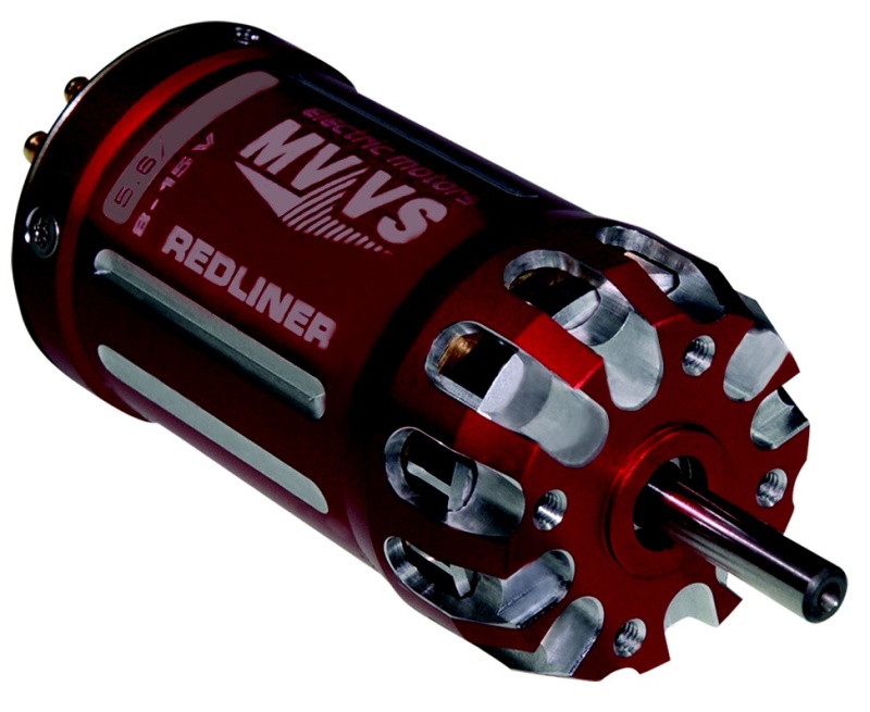

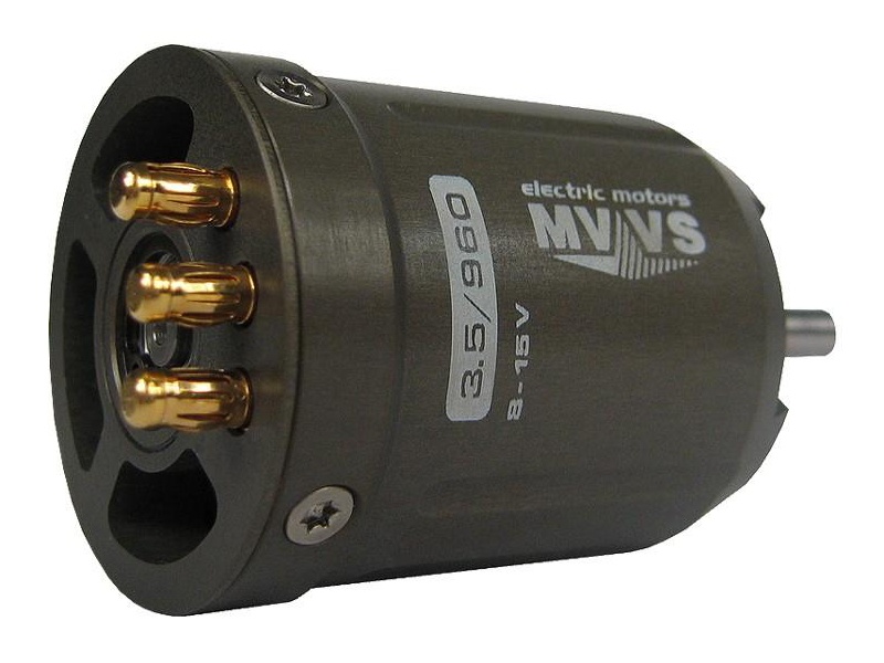

        mvvs motors
        Hi bro, you can try looking at mvvs motors. They have outrunner motors built specially for gliders. No cables and the bullet connectors are placed behind the motor.
          My favourite outrunner
