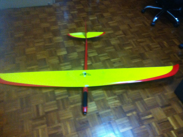

  • JYZoom
    replied
    Just Happy to see this again

  • JYZoom
    replied
    Originally posted by jumat View Post
    Bro it look good !
    Need paint n will look like new !
    Bro...thanks again for the tips....
    here is what I got done just now, I should have sand it down before I spray....but I decide to leave every single piece of FG on it so it stay strong as safety comes first then look.
    Jonathan

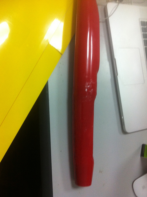

  • JYZoom
    replied
    Stay Positive and continue
    I always take positive learning out of everything and continue to move forward.....I have crash my helis even after flying for years especially when I try new things like new FBL or new heli...or new acrobatic moves....one thing for sure I continue to come back for more.
    My saga of composite continue, taking advice of not getting a new expensive high end glider to start. I went for o 2nd hand to test it out. But some of you know , luck were not on my side when I try out on a 2nd E-ginger. Even when I maiden it I have buddy around, not their fault at all I still make the mistake of programming the elevator the wrong way. I was so sure but I end up programing the elevator in according to how a heli swash plate wok....tilt up to nose up.....how wrong is that for a glider or plane. Just one of those day for me.
    Like I say, take positive out of everything....now I can learn about fixing it. And thanks to bro Jumat and Kiply for helping to fix it, I decided to do it myself so I learn something new. This actually further confirm that I prefer to work on fiberglass then foam. Here is my attempt....any feedback on my work and advice on next step to take are welcome...I will probably proceed to spray paint on it or put a Kevlar on it. But I have no idea where I can get Kevlar in Singapore.
    I am using 1.5oz outside and 6oz inside.
    Before :
    Progress :
    regards,
    Jonathan
    Leave a comment:

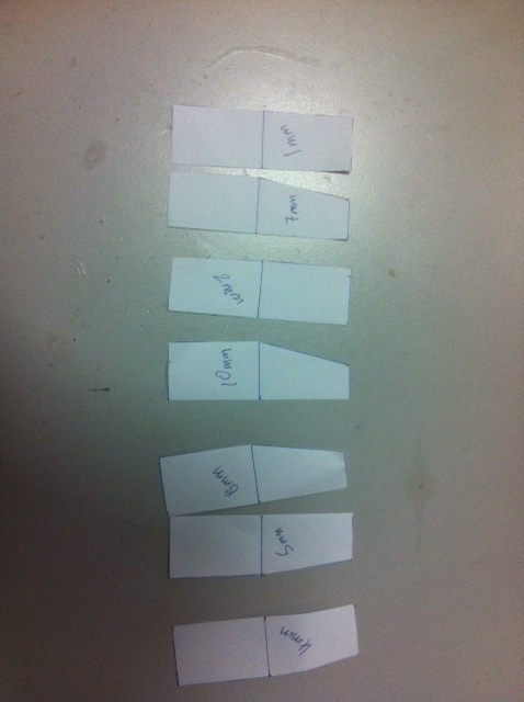

  • JYZoom
    replied
    Originally posted by James Lee View Post
    Hi Jon,
    What RT was doing with the templates is necessary for the Vladimir ships because there is no other way to determine the neutral point on the control surfaces. Supra, Sprite and Blasters do not have a fixed portion on the wing that you can align the moving surfaces against. It is also set in degrees not mm.
    Mm of control surface movement is a factor of degree of movement and chord of surface. You're much better off getting a simple device like the Great Planes Accu Throw. Cuts your throw setting time in half and much better accuracy too.
    Templates also lose their effectiveness if your aileron trims have to be off center.
    Hope you have lots of fun with your gliders!
    James,
    Yup you are right, I found out trying to program it that I need to measure it directly which is easier.
    Jonathan
    Leave a comment:
  • James Lee
    replied
    Hi Jon,

  • rt9
    replied
    oh.. did you jus said ready to program for the look weekend?
    Leave a comment:
  • rt9
    replied
    you ah ! hahaha..
    Where are the 3, 6 and 9mm?
    Leave a comment:
  • JYZoom
    replied
    I am definitely impulsive and can;t wait when I want something....but for sure I am not afraid to learn and pick up tips when I see one.
    Learning seeing what Ron and Kenneth were doing last weekend.:smile3::smile3::smile3:
    Getting ready for programming....for the long weekend.
    Jonathan
