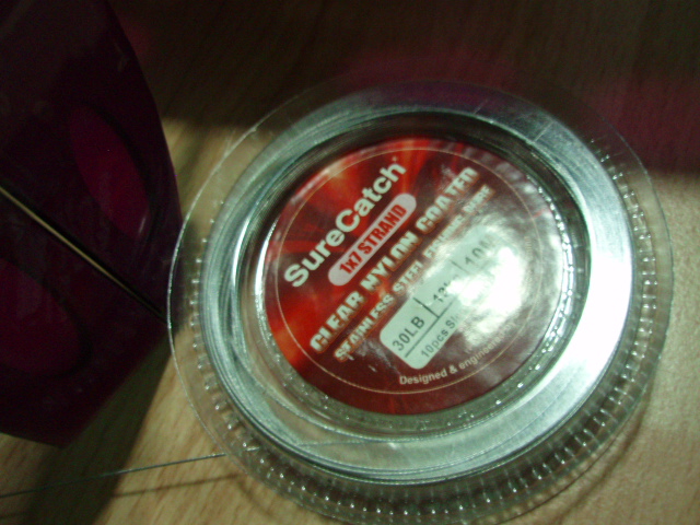

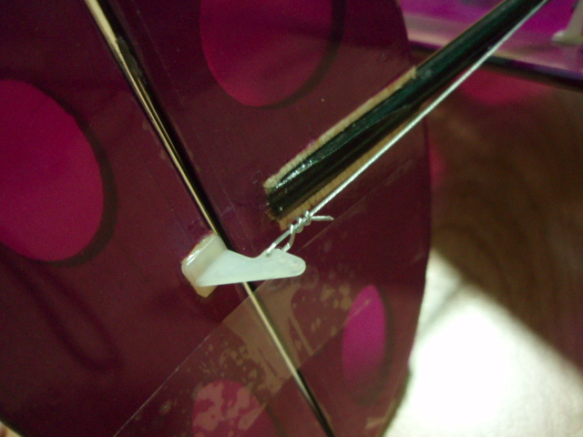

          So, what to do when you have a glider sitting there, and not flown? Well, with my itchy fingers and trying to make improvements, I changed the control pull thread to steel wire from the dental floss that I was using.
          There were some stretch from the dental floss, with the steel wire, there were none!
          I managed to find the steel wire from the fishing tackle section of NTUC hypermart. It is very thin, about 0.3mm and weighs close to nothing. The best part is that it is non-stretchable and cheap. Cost only $2.15.
          I changed the controls in less than 1 hour, and was able to see the good results of positive controls.
