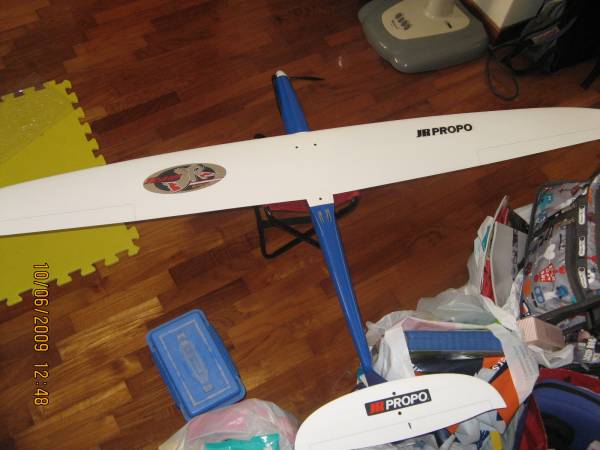

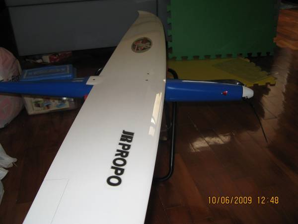

    well, i pick this bird up a couple of weeks ago locally and started building it.
    its a simple 1.7m long 1 pc wing ( looks strong ) powered by a china made brushless with gear box. and 12x 10 prop.
    gonna see how it flies...

        Looks hot
        More pictures pls, show the profile

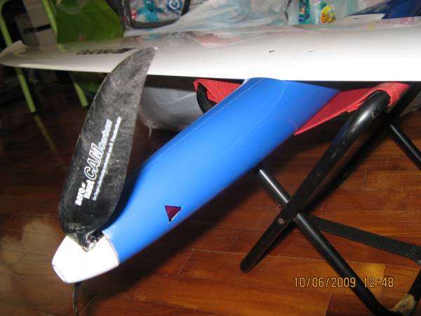

          Motor and power train info?
          Looks hot...and cool at same time.
            2 pack 2250 30c 3s rihno lipo.
            Cc 80 (everything off - no limit)
            Gs motor n gear box (from jet hobby)
            Rfm 38mm spinner 0 deg
            Aeronut 12 x 10 prop
            3 x mks wing servo.
            Estimate abt 90 amps wot.

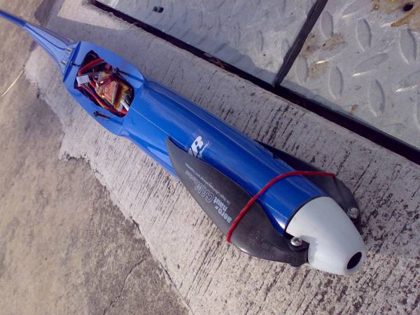

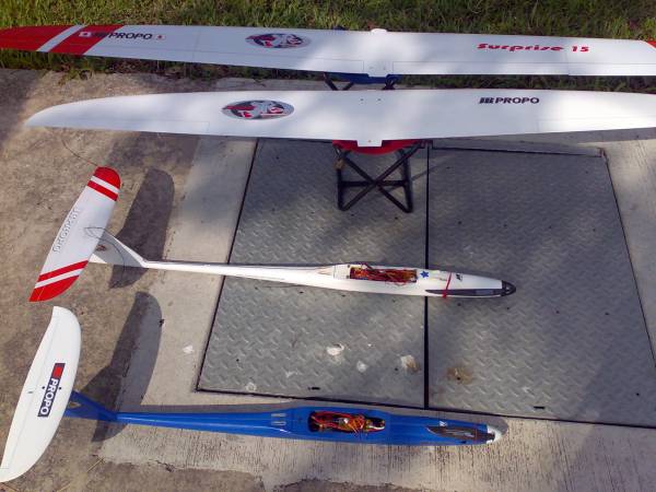

            Maiden today and flew very well!! Fun glider to fly. Slows down well to land as well. Somebody told me its the sam plane hobby lobby is selling called the tiger. I name mine pussy cat wahahha.
            Vertical climb to good height abt 6 sec and vertical dive test survive. The wing is pretty strong . Overall nice performance motor glider.
              i flew back to back with my other motor glider , the pussy cat does hold energy well and very tame to fly.
