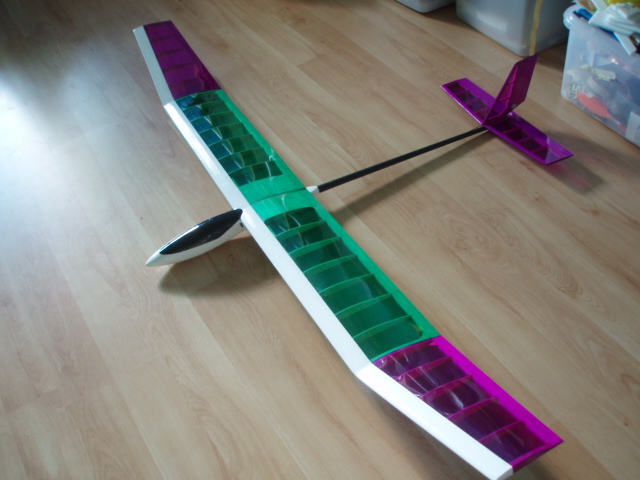

    Just completed mounting the servos and the dead weight in the nose. This cheap glider is only 2 channels. Very simple to assemble. I think that the fiberglass pod is a bit too thin though.
    Need to find the suitable wind condition to fly it at TBP.

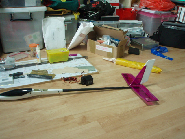

                The ELF has a new tail!!
                Have not touched the ELF since the last outing at TBP. Due to the sluggish responds from the rudder, I decided to give the ELF a new rudder.
                I tore out the original and trace the outline on a 3/16 balsa. The width of the rudder was widen by about 5mm and I give it about 1" more height. Shaped the small piece of balsa into a wedge shape, thinning at the trailing edge.
                Covered the new rudder in white (I think it looks better) and tape the rudder back.
                Charged the Ni-Cad inside the nose of the fuselage.....now, all I need is for the rain to stop and the Northernly wind to start blowing consistently.
                MS
                  Way to go, Kah Marn. Adding the width may not do much but increasing the height should do the job. My Buttercups have tall, but very narrow rudders which is good enough to make them do barrel rolls.
                    Thanks. I'm a bit KS, both width and height increase for me.
