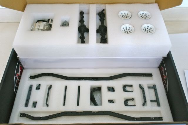

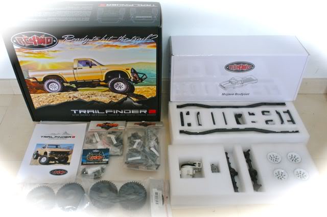

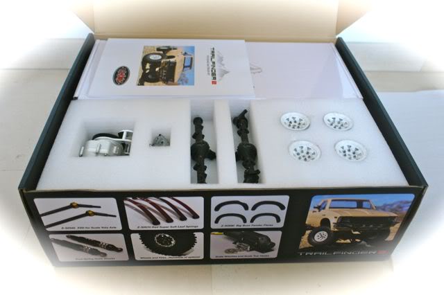

          Time to look into the Box. Now here's what I saw.
          The RC4WD Trail Finder 2 User Manual, the all-new 2-speed Tranny and Transfer Case, a pair of the very Popular Scale Yota axles, and a set of 4 nice 1.55 Beadlocks, nicely arranged and well-protected in a foam Tray. Lifting the top Foam Tray, I caught sight of a beautiful black aluminum chassis, unassembled but laid-out in a logical way.
          The Mojave Bodyset is inside the sealed white box. Let's open the box later. we got the Tires, bumpers, driveshafts, leaf springs, and shocks in plastic bags. And screws sorted and individually packed.
          Next, Let's get-on with the Build!

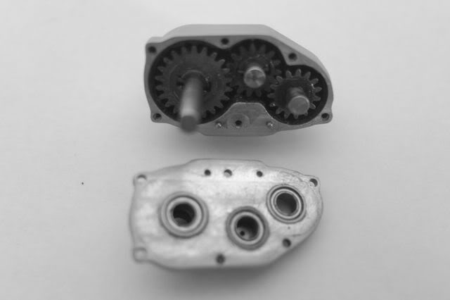

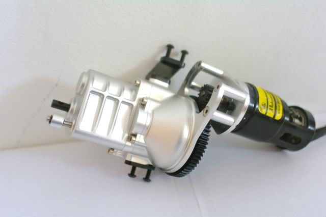

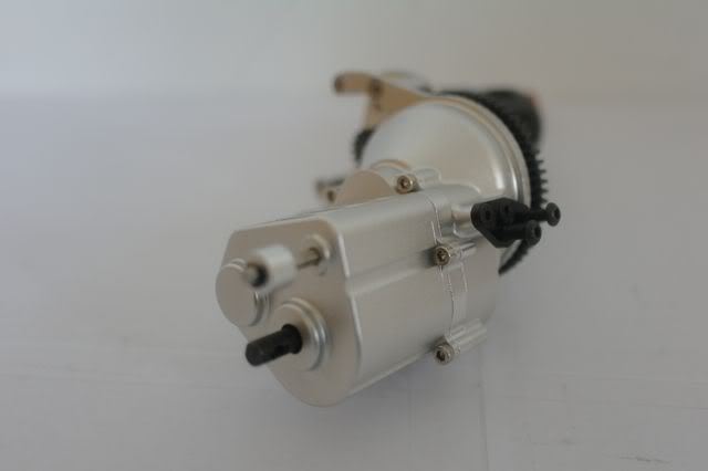

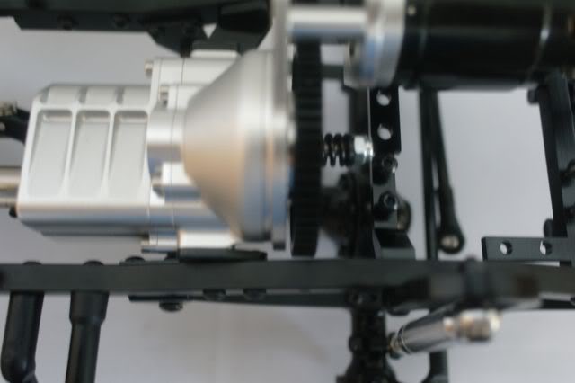

            Just love the new 2-speed tranny. The casing is made out of aluminum and with hardened steel tranny gears. The tranny gears mesh nicely and are well greased. I added just a bit more grease when I check the gears and the tranny worked quietly and runs very smooth.
            Shift to low gear or high gear for Best Performance using a standard servo and a 3-channel controller. You will need to set 3rd channel to 2-Position switch and adjust the EPA. The tranny also got a built-in slipper clutch. Adjusting the tension of the spring is reachable/easy and will get the slipper to engage/disengage at variety of torque settings.
            The 2-speed tranny mounts get the transmission to mount nice and firm on the chassis with just 4 screws. Adjusting spur/pinion mesh is quite accessible and easy. I am not certain if it is a 32 pitch, but it is very robust and a great choice for the off-road.
            The 2-speed tranny clears the steering servo quite nicely, the spur clears the chassis by just a millimeter or two -- everything is well planned and laid-out.

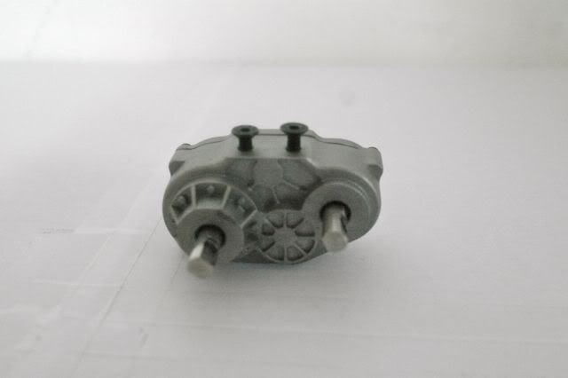

              Transfer Case is compact yet solid and nicely scale-down.
              Aluminum Casing with Hardened steel gears inside.
              The clearance is very nice. The transfer case mount is quite compact and nicely designed, as well.
              Transfer Case and mount attaches quite precisely to chassis without a problem.
              TIP: When installing the transfer case, be sure that 2 outputs are facing forward, and the transfer case mount screw holes on the right side.

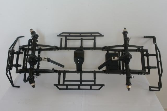

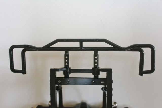

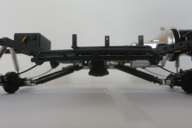

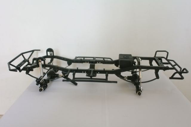

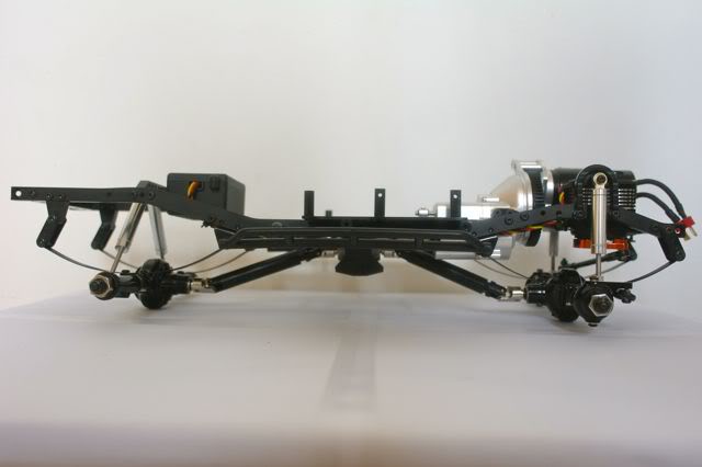

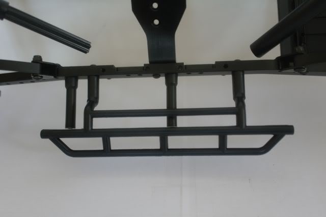

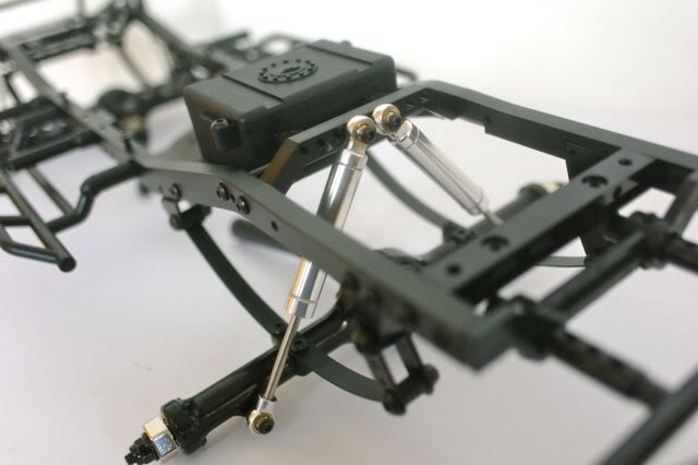

                One of the Best Features/Milestone of the RC4WD Trail Finder 2 is the Billet Aluminum chassis. Had the chance to build most of the Tamiy 3-speed trucks, and the Trail Finder 2, I believe is certainly the nicest. The chassis mounts all components to perfectly align, each mounting hole located at precise points.
                The TF2 kit comes with a complete set of front and rear bumpers, sliders, and body mount.

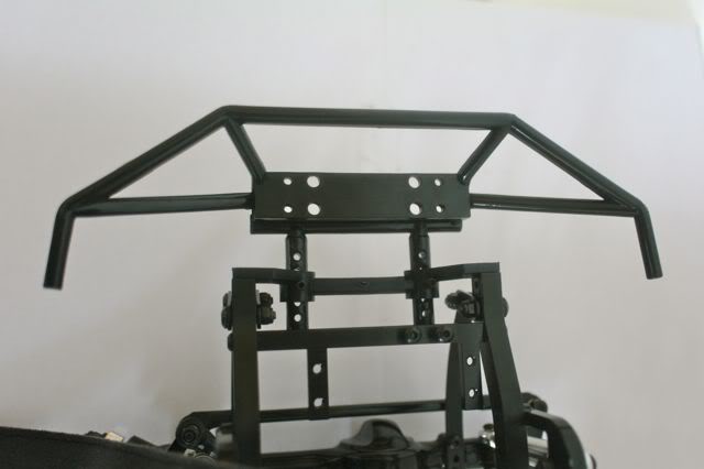

                Both Front and Rear Bumpers are quite adjustable. .
                The front bumper has a mount for a scale winch.
                Everything fits quite nicely. It took me less than 3 hours to get the kit to a roller. Building the Truck is easy and a lot of fun.

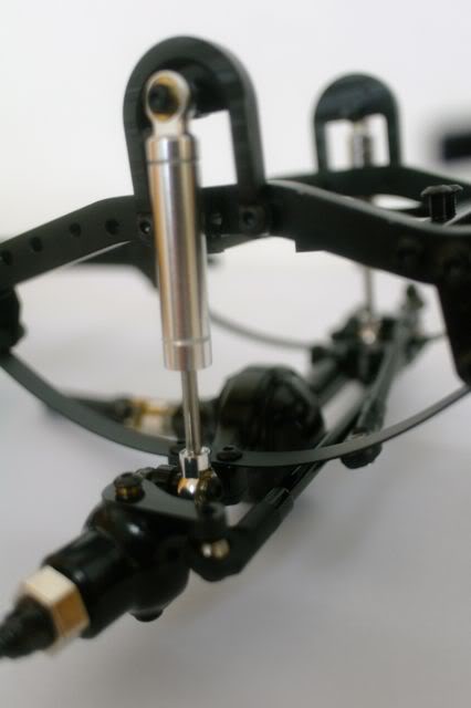

                Glad that the TF2 comes with the RC4WD Scale Shocks instead of plastic shocks. These shocks compress quite smoothly.
                The rear bumper can be installed in a way that it perfectly hug the rear end of the bed.
                Getting a very scale looking overall geometry is easy with the scale shocks having the exact shock lengths for the front and the rear. I like the shock hoops, they look very realistic and are very solid, as well.

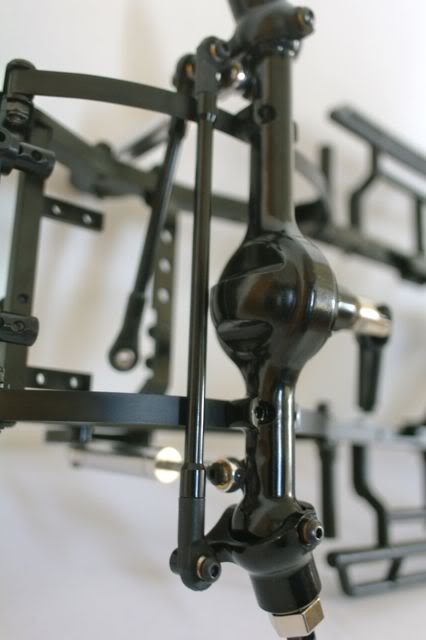

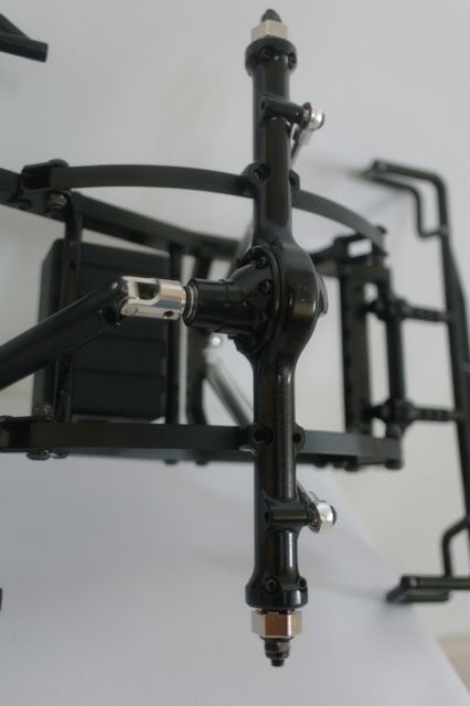

                  The Scale Yota axles are the perfect choice for the TF2 and Mojave Hardshell. I have the BlackWidow, Blackwell, and K44. It is my first time seeing the Yota axles in person. I must admit that the Scale Yota Axles look and feel Great, as well.
                  The Ring and Pinion mesh quite smoothly. I also like the steering/drag links. These axles mount under leaf spring quite easy.
                  The drag link when installed, does not bind on the leaf. BTA configuration for the front axles is also possible if desired.
                  The new driveshafts feel quite solid and capable.

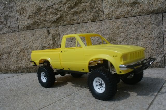

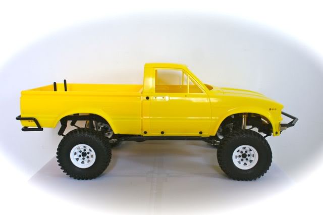

                    I decided to start building from half past midnight. I got things to a roller at about 4:30 am.

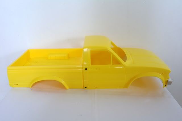

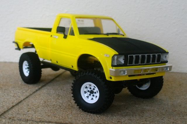

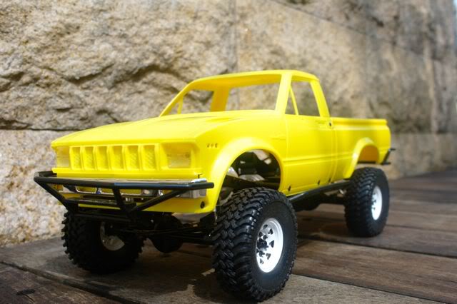

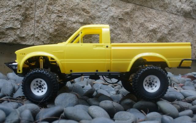

                    The Mojave hardshell is a very nicely art piece. I truly love the square lamps and grille, the defined chrome bumpers, side mirrors, lenses, glass, dashboard, and dropped bed. With the wheels and tires installed, the RC4WD TrailFinder 2 with the Mojave body is looking really good.
                    I really like the Mojave BodySet. True Scale details executed in Top quality ABS and very fine finish. If you like yellow, your all-set without having to paint cab and bed.
                    I really like how each component fits snugly, to form a unified one. Thanks to RC4WD, this Mojave will look very scale once I get to install all the embellishments -- the glass, dash, steering wheel, door handles, other accessories and accents.
                    2013 RC4WD International Team Driver

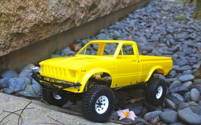

                      Here are some outdoor pictures.
                      Some paint just to have some accent.
