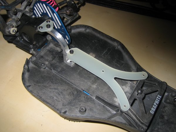

    Thought I'd start this thread to share my project.
    Here's what I've been working on in the little spare time I have...
    not finished yet.
    It's a custom modification of a Losi XXX buggy. Just playing around with some ideas and at the same time picking up the basics of CNC.
    Many thanks to HZM for his help in getting me started in CNC.

        The CNC is capable of 3-axis machining but I'm still a relative newbie so what you see here is all 2-axis work. The aluminum brace was more challenging to mill as I had to figure out how to clamp the piece while milling it. The other FRP pieces were easier.
        Cutting these parts with CNC is a lot faster. The top brace took me a total of about 1.5 hrs on the computer working out the design only about 15 mins to drill and cut out.

              er... I'm no expert but that's not necessarily the case. CNC setup also depends on the software.
              Currently the software is capable of 2.5D... which means the Z-axis is only capable of cutting simple cuts. The slightly more complex curve cutting is handled on the x and y axis.
              HZM, please correct me if I got that wrong.
              Can't remember how much I paid for everything liao... bought most of the stuff separately and assembled it together. HZM provided me a lot of help on the stuff to get and how to get started. Drop him a PM if you want more info on that.

                BC setup is a full 3 Axis / 3D setup. Like he correctly mentioned, currently his application is limited to the software he is running - Sheetcam which is a 2.5D
                To achieve full 3D capability, you need to have a software to generate 3D G-Code

                          Yes, clamping is the biggest puzzle whenever designing or cutting any parts. For the center metal brace I designed the part with portions uncut by CNC... then milled these out and finished them by hand.
                          The FRP parts are like how I saw you cut your heli fins... run program 1 to drill holes, then I use a dremel to deepen the holes to screw the piece down. Then run program 2 to mill out the shape.
                          Any tips?
                            From the looks of your shape, i guess thats the most standard method already.
                            1) cut/drill the holes
                            2) Pause program, clamp the stock down using those holes
                            3) Continue with cutting with you make a pizza. (provided u have a vacuum system because FRP is very veyr bad for health)
                              btw, whats your cutting parameters?
                              Mine is:
                              Cutting bid: 3mm solid carbide 2 flute
                              Feedrate: 100
                              Depth: 2mm per pass
