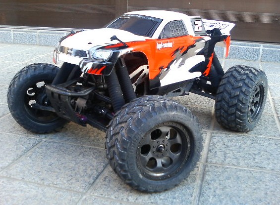

                              HPI MT2 shell
                              Got one for my e-savvy.. juz need to ream new holes
                              garage:
                              E-savage basher
                              TLT-1 rock buster
                              TT-01R/D
                              area: jurong, any kakis?
                                Originally posted by ^ZEd^
                                HPI MT2 shell
                                How did you get your wheels black?
