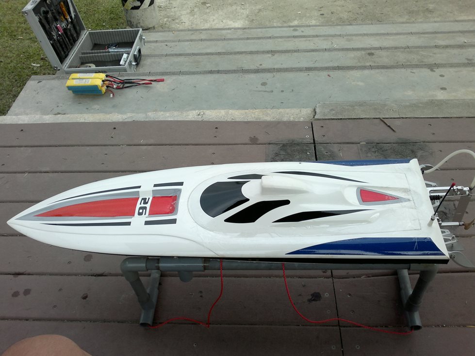

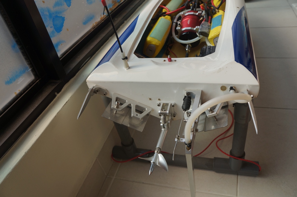

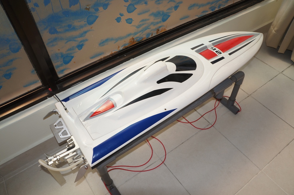

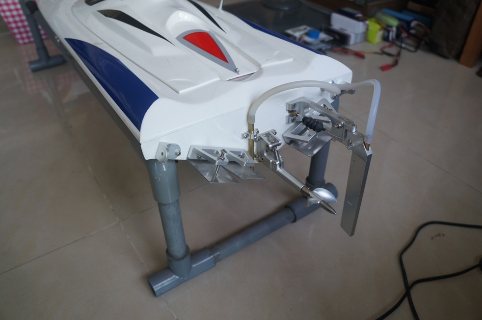

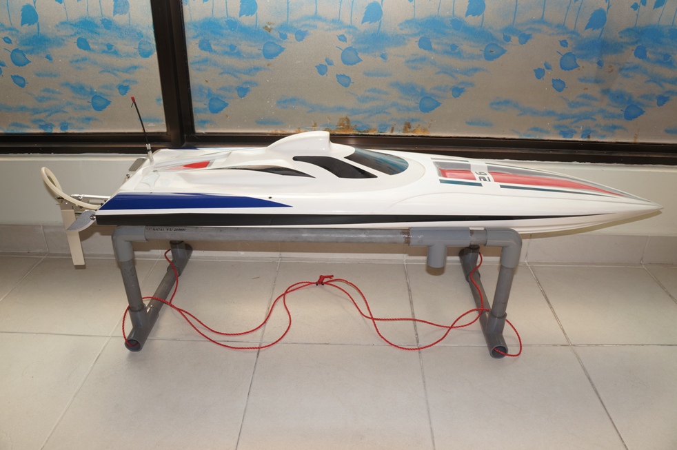

    Bought this Vanquish more than one year ago and it has not touched water since. The original setup has flaws so decided to upgrade her before even driving her. The boat in its original condition when I got her as used condition.

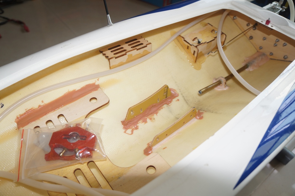

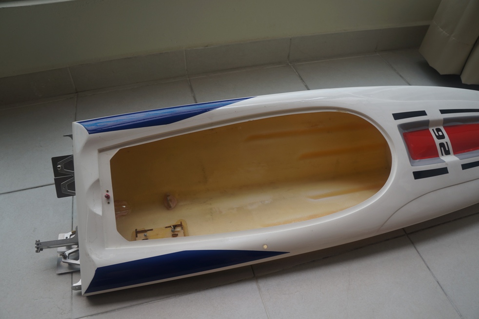

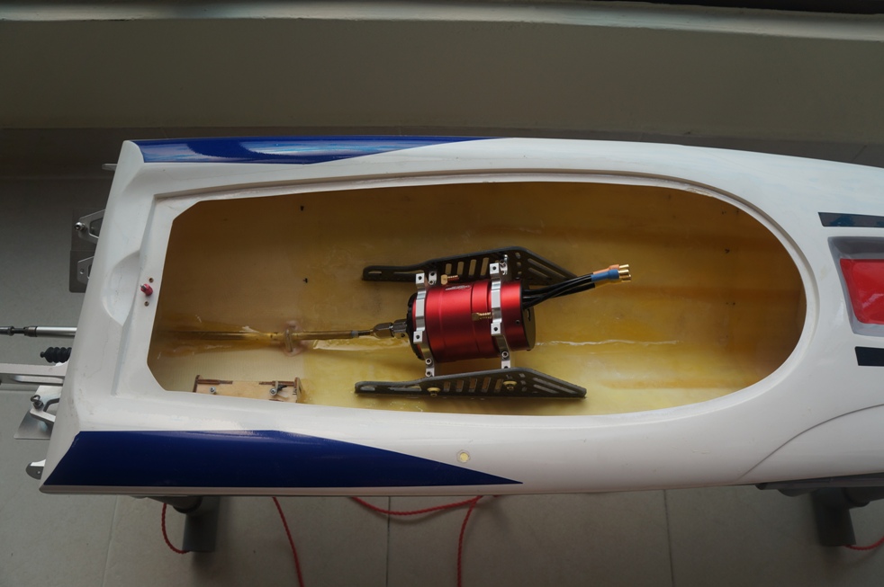

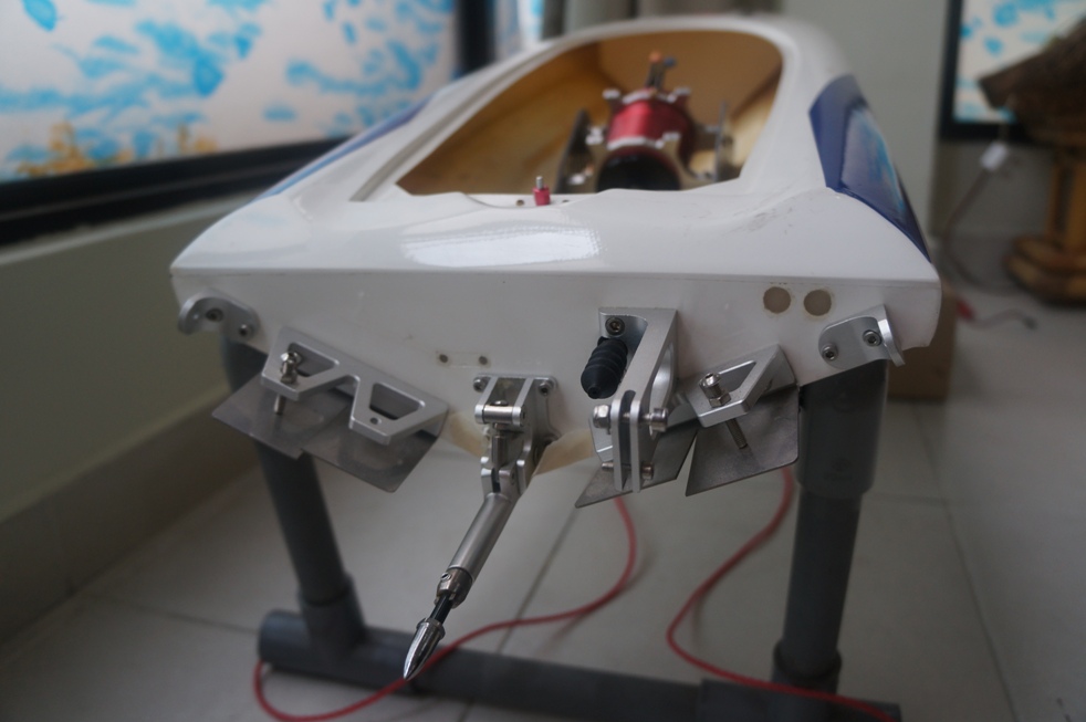

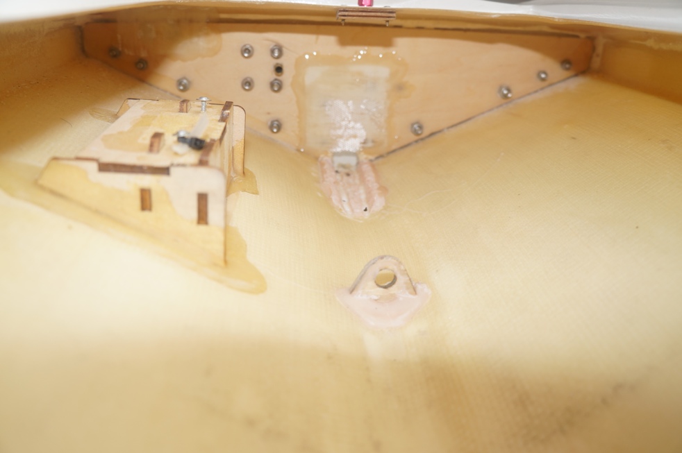

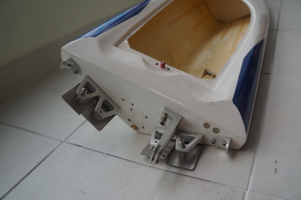

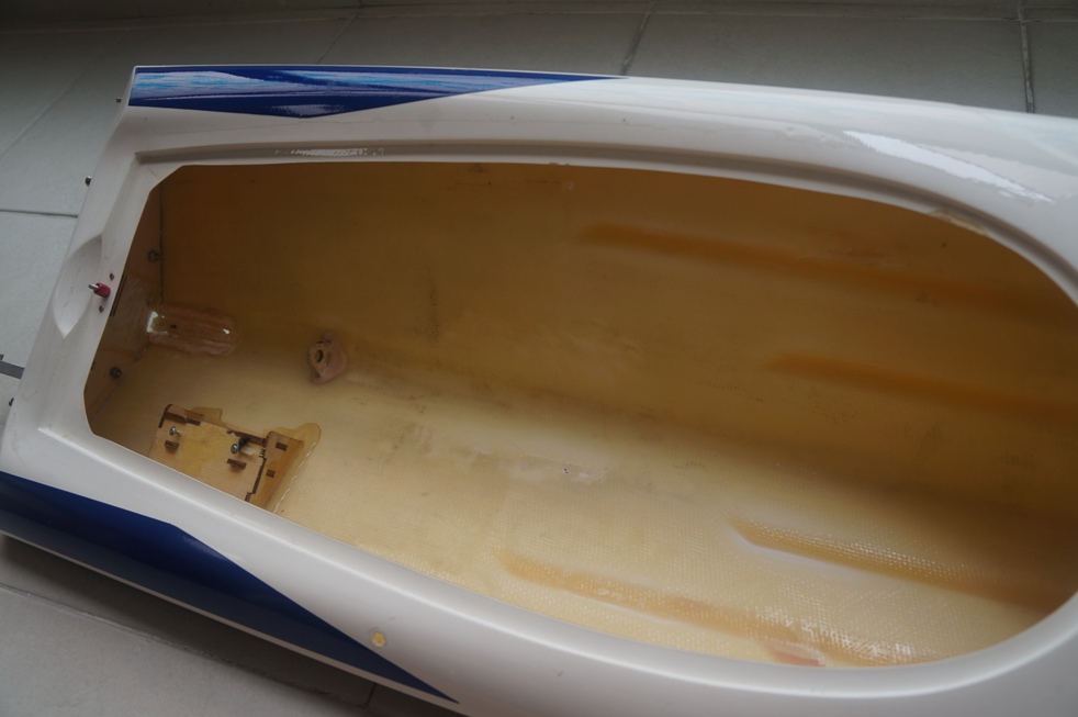

    Gutted the inside and sand it down. Removed the stinger strut to be re-positioned higher and removed the water pick-up.
    Also removed the antenna holder, water inlet and outlet.
    Epoxied and fibreglass the holes to seal them up.

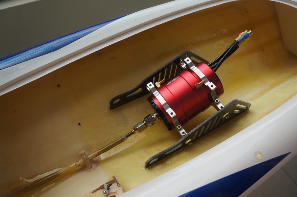

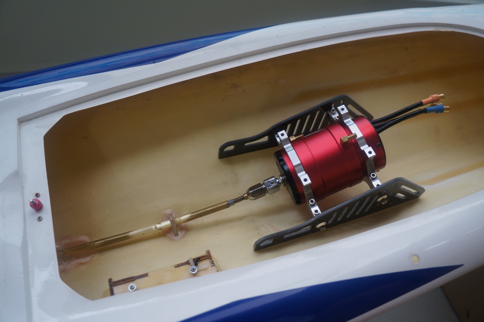

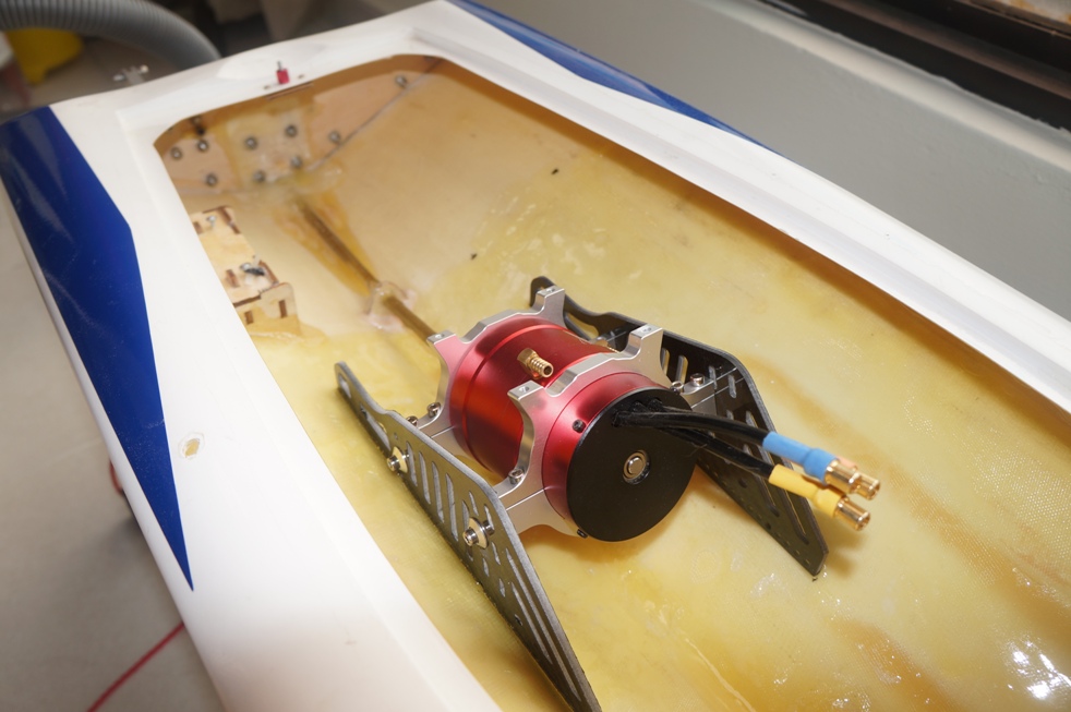

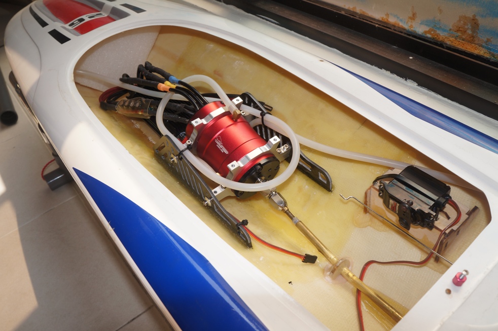

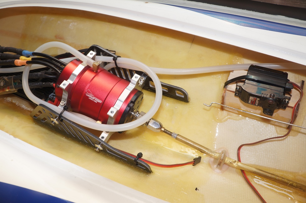

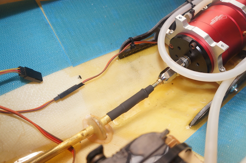

      Install the stinger strut and stuffing tube with motor mount and motor to get the alignment correct.

        Lay one layer of fibreglass and epoxied the motor mount in place.

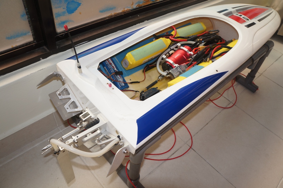

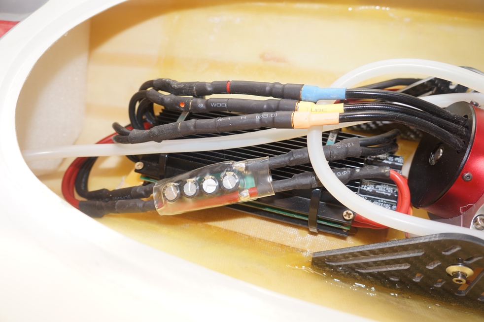

          Install an esc tray, esc, servo for rudder and run the plumbing.

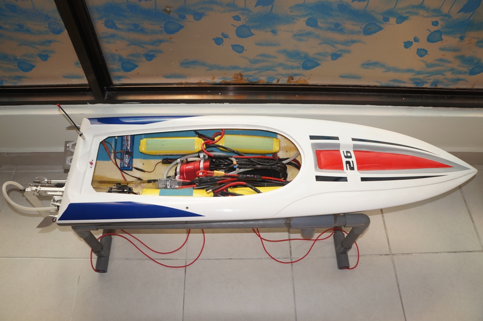

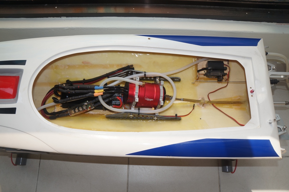

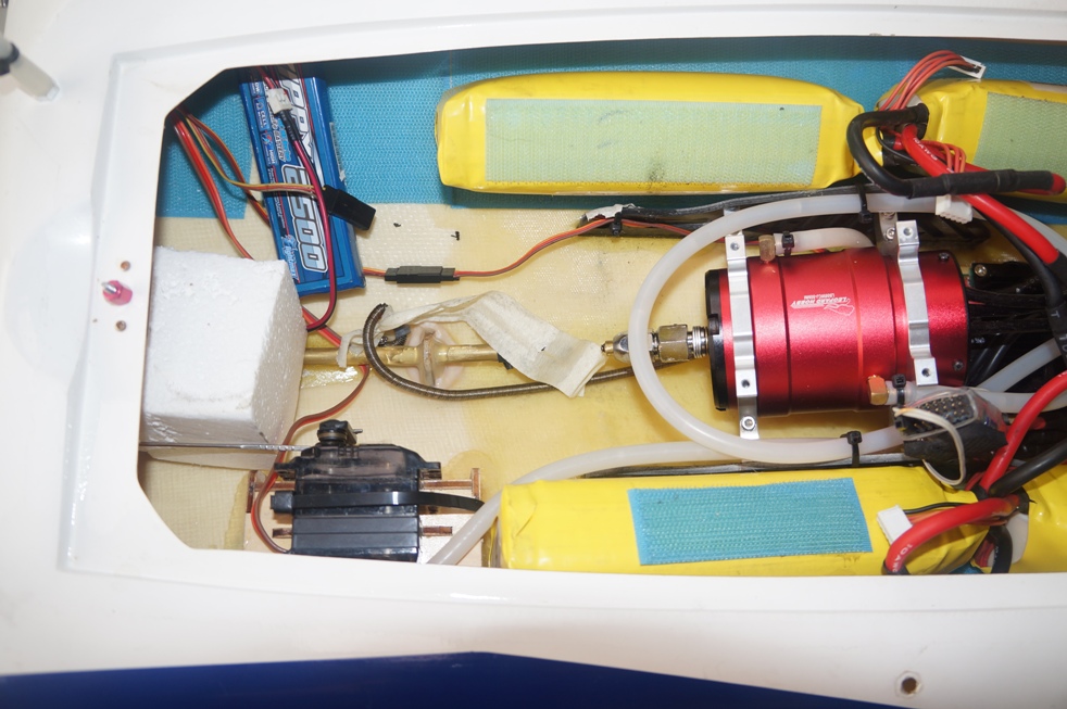

            Put in the batteries, connect to rx, first time powered up the motor and finish all the tiny little bits.

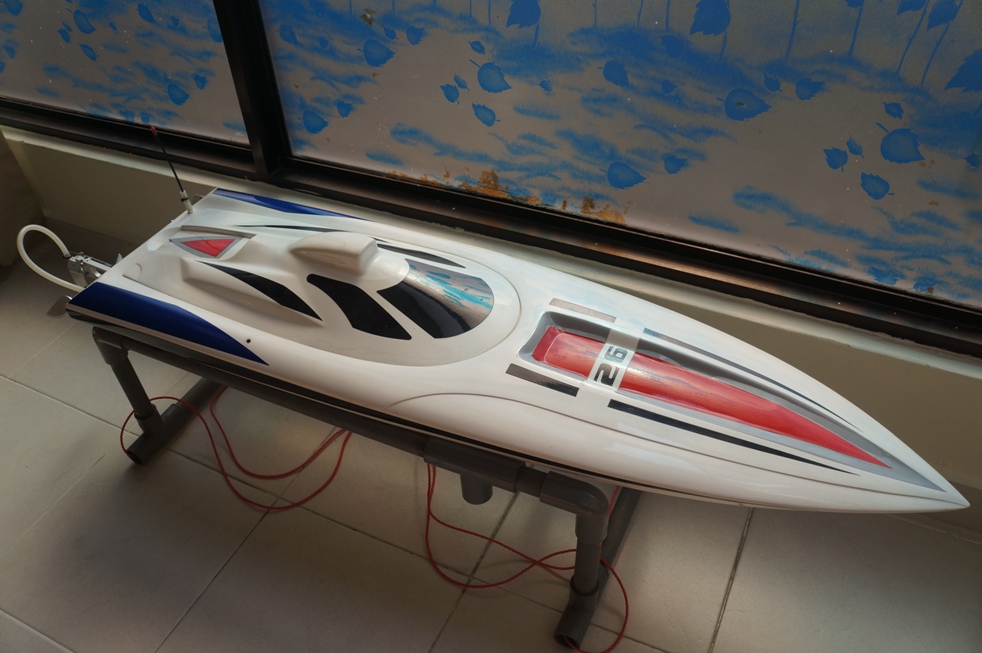

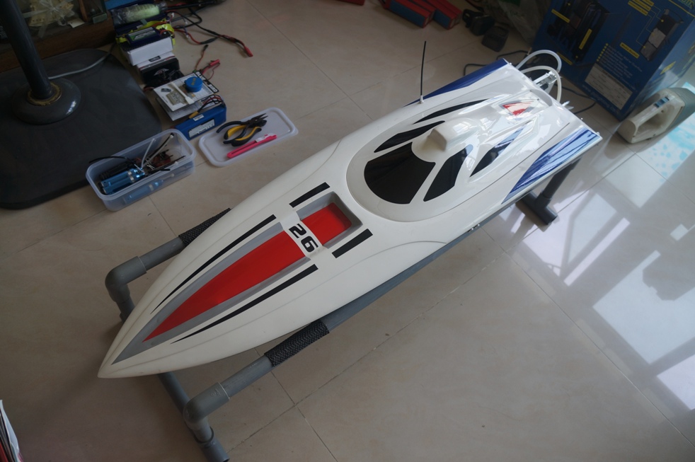

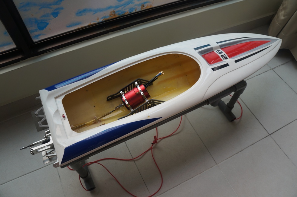

              All done and she is ready to hit the water. It looks the almost the same on the outside but its what hidden under the hood thatz different from stock.

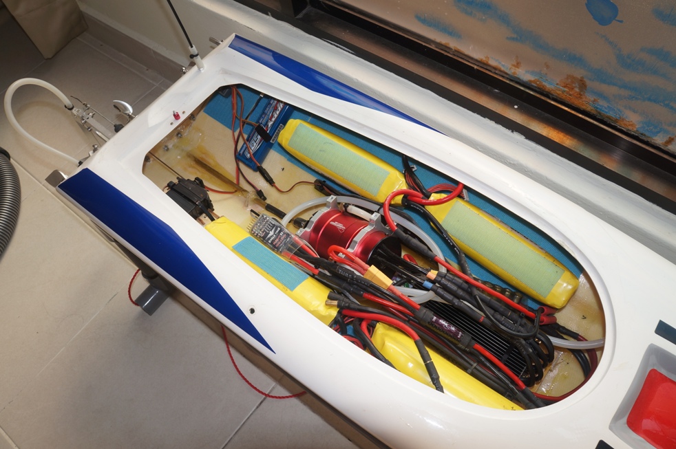

                Here is whatz under the hood :
                Motor : Leopard 5692/2Y 1090kv
                Esc : 200A HV
                Batteries : 8S2P setup
                Prop : starting off with 50mm
                Expecting around 50mph speed for sport running.
                Total AUW is 7.2kg

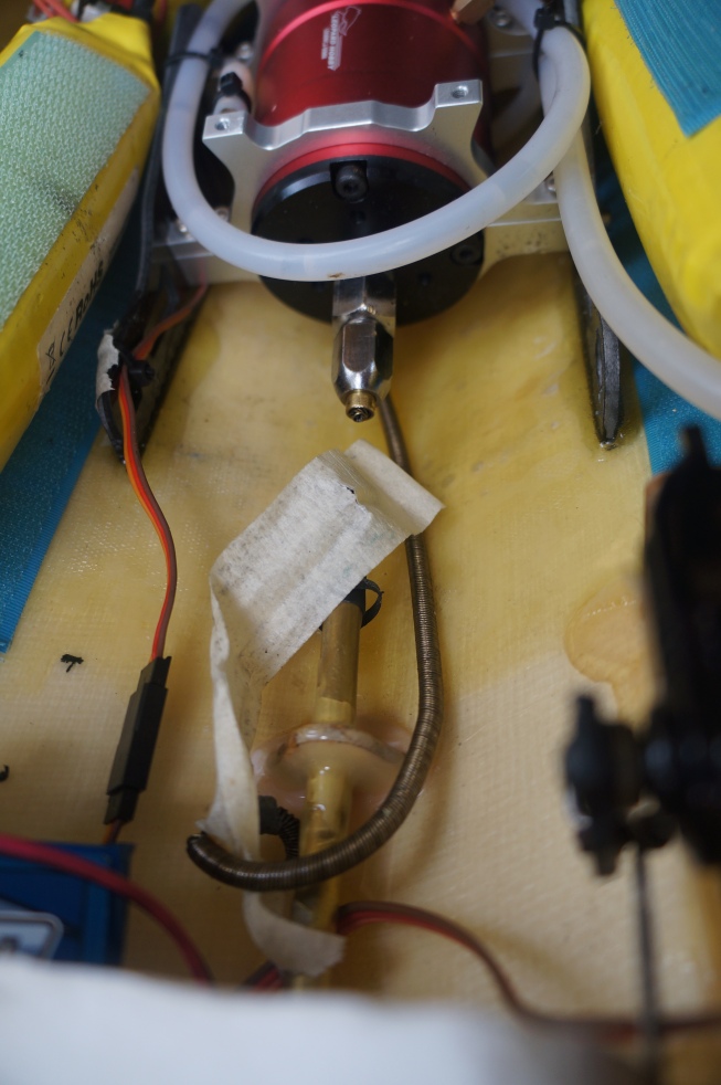

                    Maidened my Vanquish. But not a nice maiden. Given the amount of power the motor possesses, the weakest link got to give way.
                    Back to the drawing board..............

                      1/4 flex to go

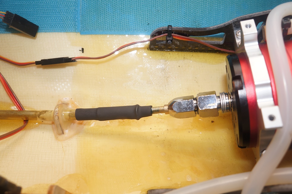

                        New flex cable arrived and installed. Cant wait for re-maiden. Keeping fingers crossed.
                          I shifted the cg to the rear of the boat as it was running too wet thus I guess that was the cause of the cable to snap.
                          Then the cable was slipping on the stock coupler.
                          Went OSS, bought a Octura X452 prop and Octura 6mm to 3/16" coupler. Ran it last Sat and at last, managed to clock some speed, 53.7mph. Need further running to dial in the speed.

                            Ran my Vanquish this morning, check out the video of my run :
                              So far, still not very happy of how it ran although its as fast as I wanted but its a little uncontrollable. Think I will be dumping this hull and move all hardware and electronics to a proper Delta Force hull. The flimsy hull of this Vanquish make the runs very unpredictable, nearly sending it to shore this morning. Lucky managed to turn in time.
