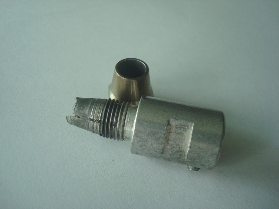

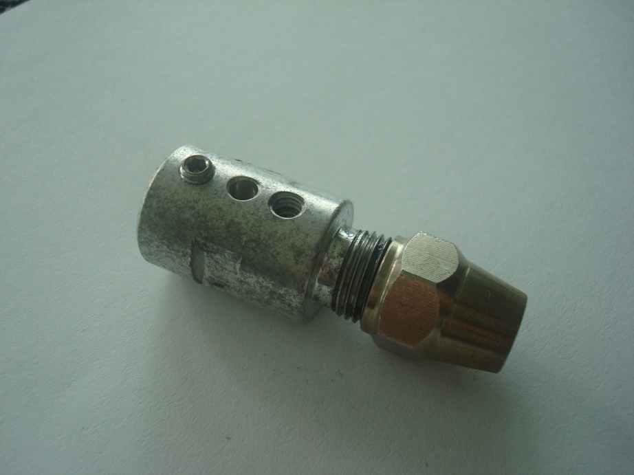

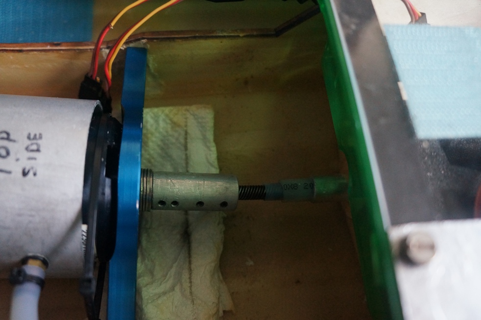

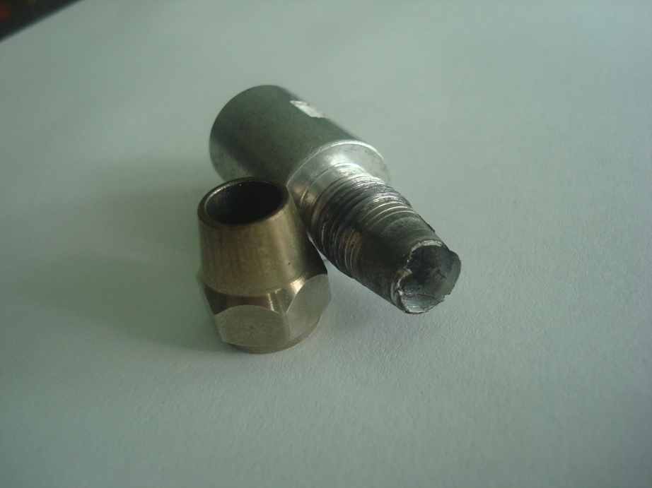

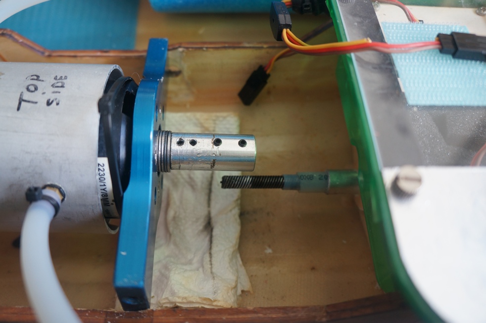

          Last long weekend, managed to make time to remove the defective coupler. The alu coupler doesnt look good for this setup.

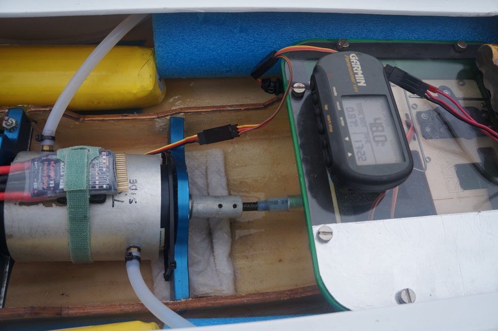

            #50
            Installed the older coupler using setscrew to lock the flex cable n motor shaft.
Name:	P1 Snap 028.JPG
Name:	P1 Snap 029.JPG

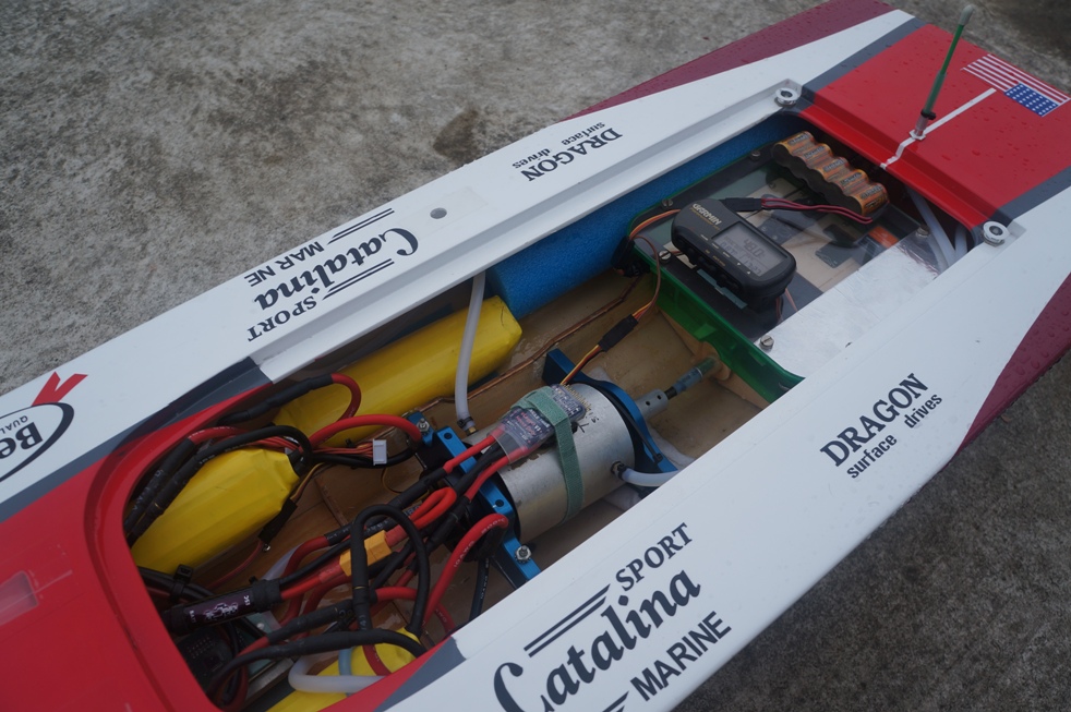

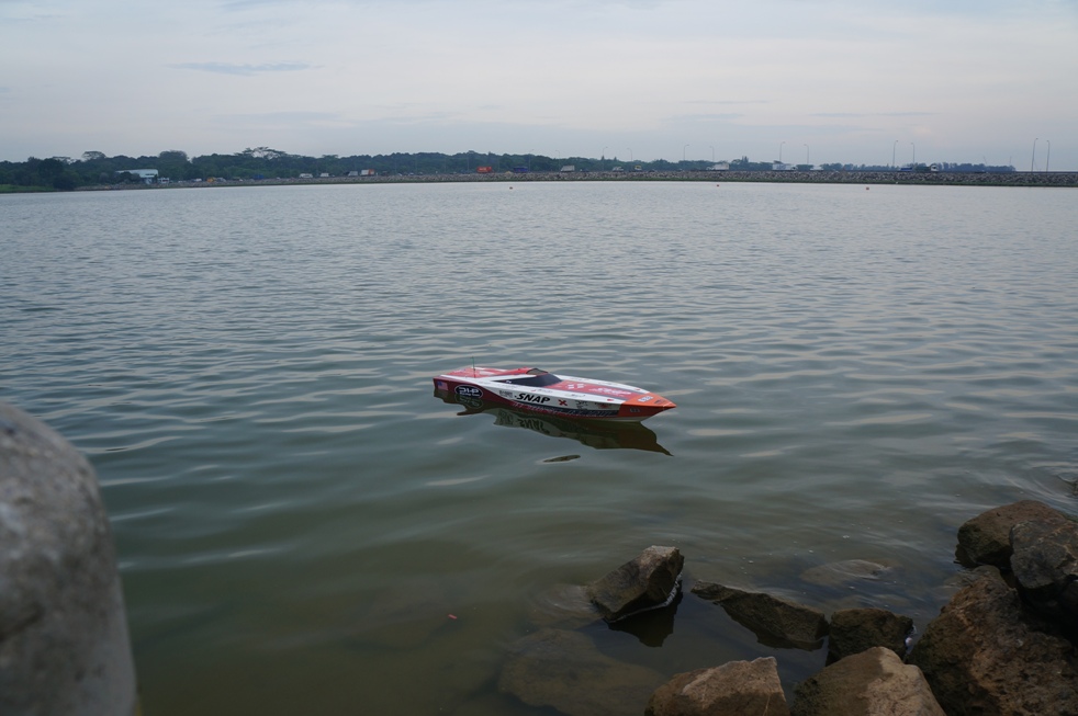

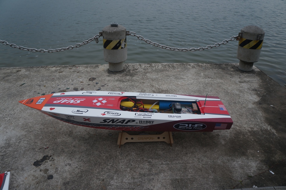

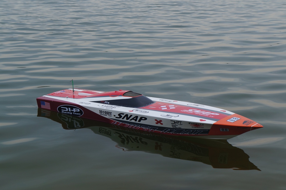

              #51
              Went for her maiden run this morning.
Name:	P1 Snap 030.JPG
Name:	P1 Snap 031.JPG
Name:	P1 Snap 032.JPG
Name:	P1 Snap 033.JPG
                #52
                Video of her maiden run. CG was out, need to shift batts towards the rear. Prop was cavitating n on turns, prop was exposed due to her shallow draft.

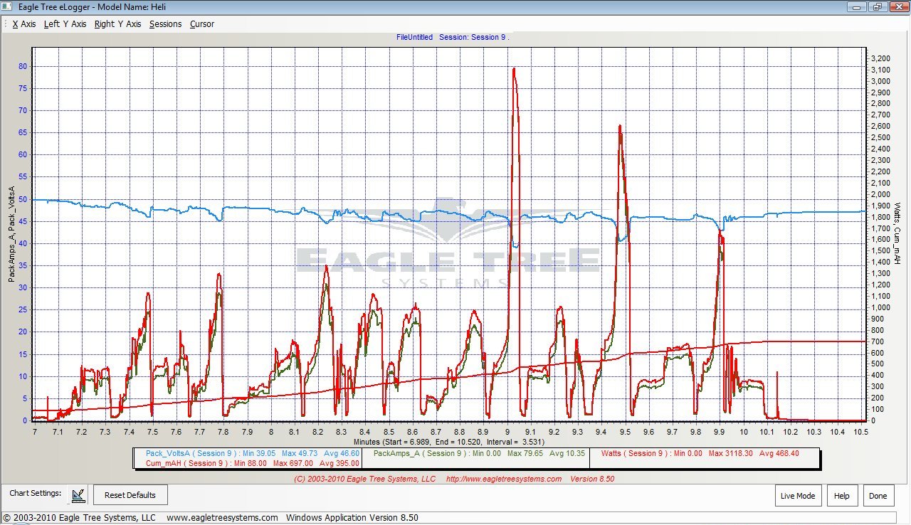

                  #53
                  Check out the recordings on one set of the 12S lipo by Eagletree :
Name:	P1 Snap 12S Lipo X458 001.jpg

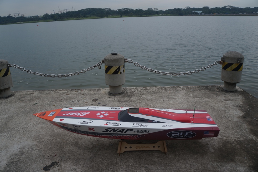

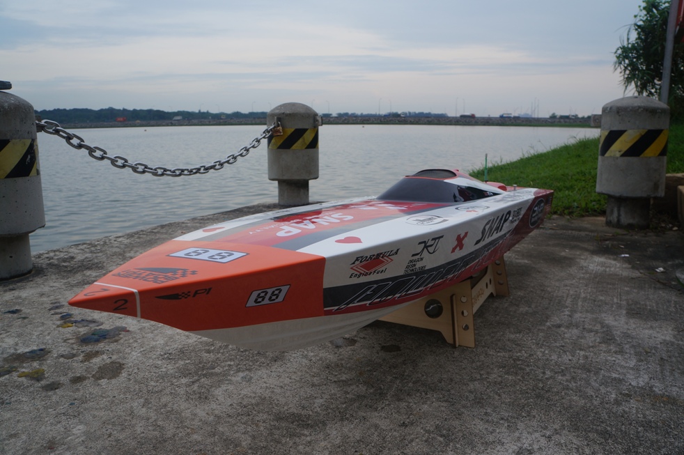

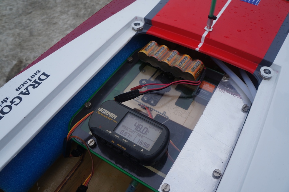

                    #54
                    Top speed was recorded at 48mph. I have not squeezed the throttle fully yet and these are very old set of batts.
Name:	P1 Snap 034.JPG

                        I am using this :
                        [ATTACH=CONFIG]116326[/ATTACH]
                        From here : http://www.fastelectrics.com/hardware.asp
                        but no matter how much I tighten, it just doesnt grip the flex cable. Probably too much torque for it to handle.

                          Originally posted by Siggy View Post
                          Hi! I got a bottle of the Loctite 648 Retaining Compound. Used a few drops to secure the prop shaft to the drive cable for the HPR. You are most welcome to have some.
                          It is not the problem between the prop shaft and drive cable. Its the coupler problem. Has been resolved, changed to my older coupler. It just ran last weekend.
                          Will run it again this coming weekend. Only have one set of old batts for one run.
                                bro..use the mbp coupler, high quality and well balanced
