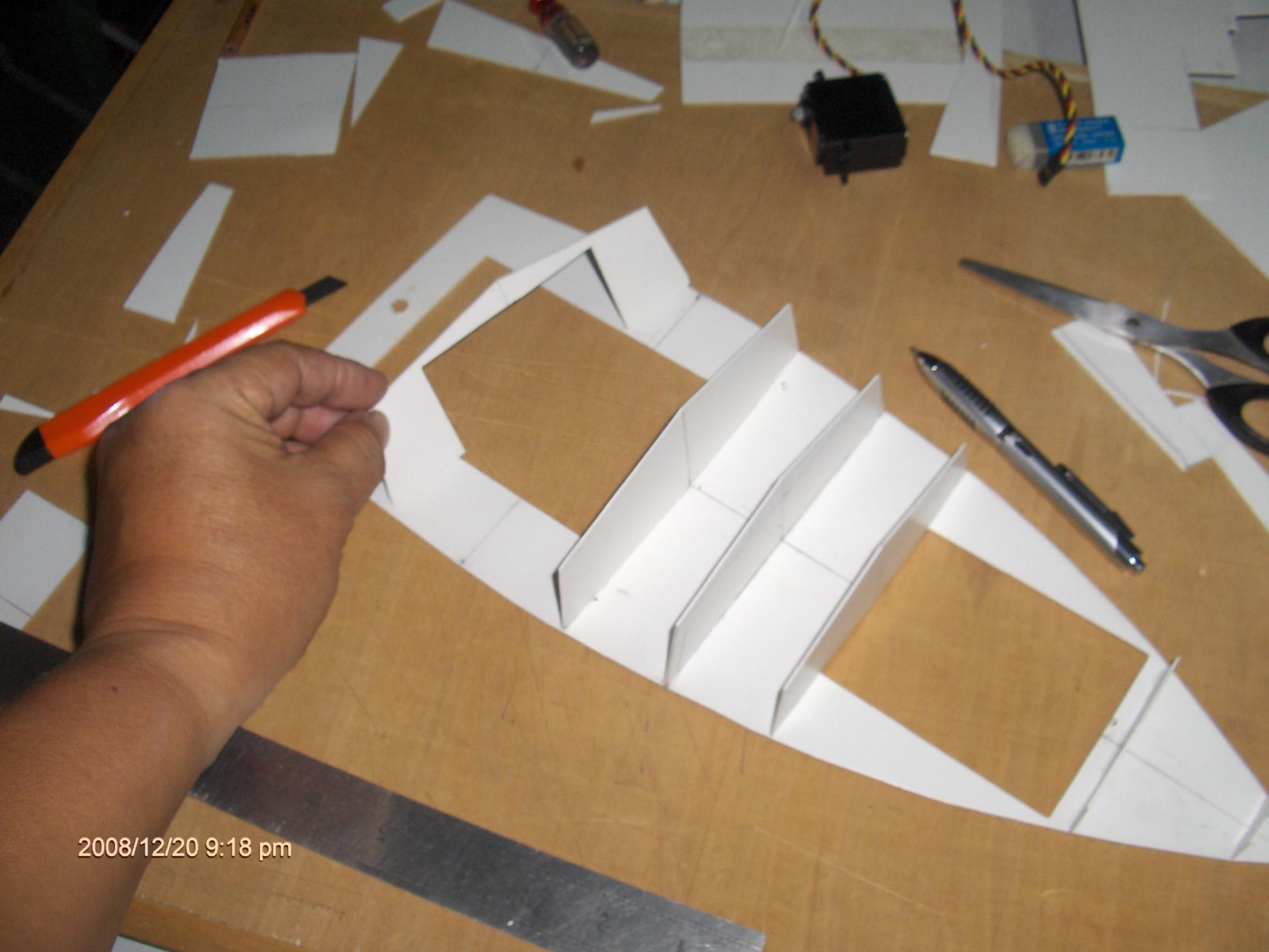

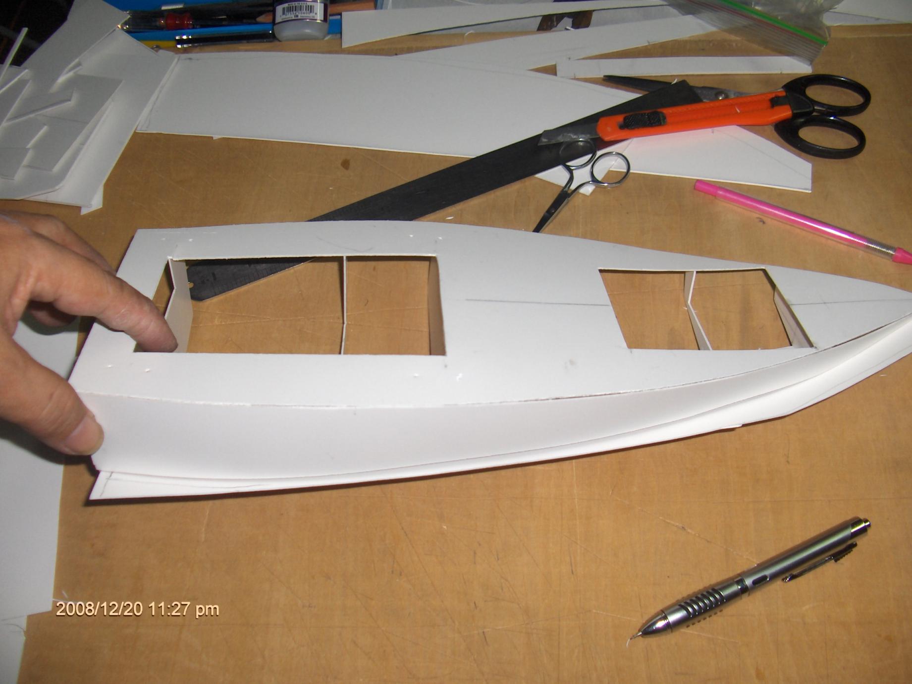

    Hi Bros, Hv posted recently to buy used Hull but no sellers so decided to DIY one.Here goes...this boat still build'g in progress ..taking sweet time n construct it at own time own target not rushing n no stress.which is it supposed to be stress free since it's my hobby.
    there is no drawings to follow just cut and paste any mistake made jus redo ...so relax and build ..to be continued.

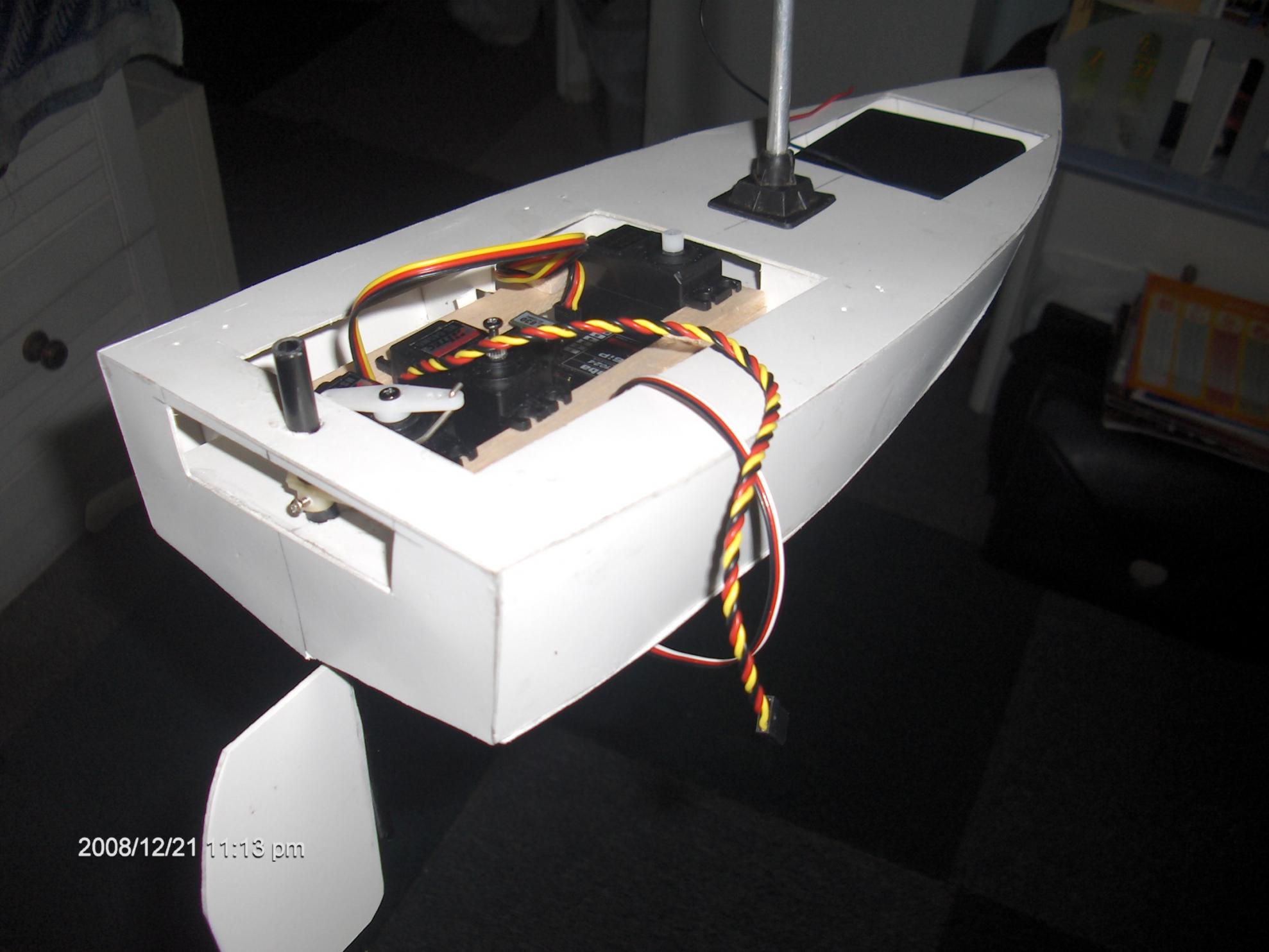

    Continue....painting the first coat with unwanted orange color spray can n finish it w black and wood lamination.....next will be making the mast n sail....any recommendation as this is my first attempt diy boat. BLESSED MERRY CHRISTMAS n HAPPY NEW YEAR 2009
      nice!! how big is it?
        Well done bro ! ...looks lovely
        ...one suggestion thou, ...you may need a keel ! ...otherwise when the wind blows, she'll "keel" over and not recover !

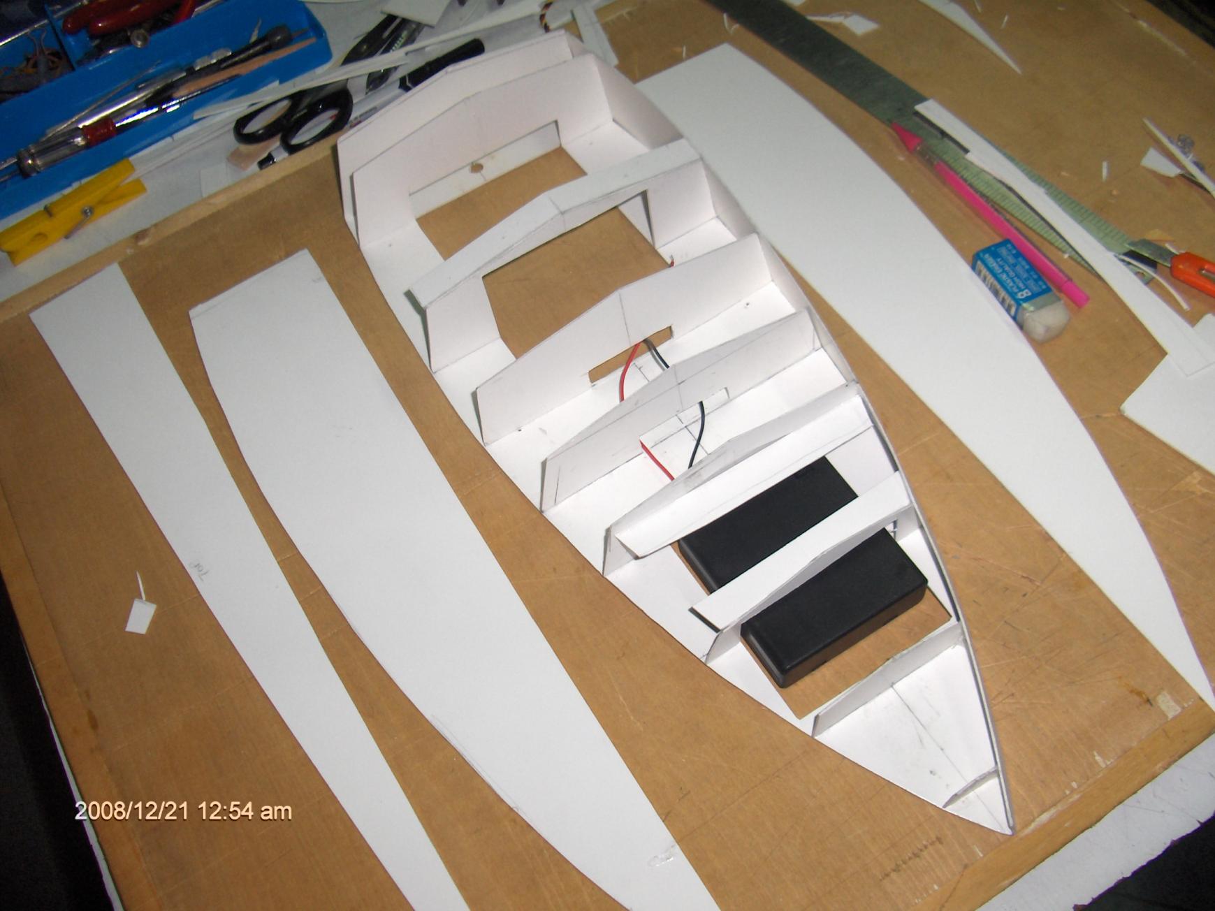

          Looks like u are using only Transverse Framing System. Why not use a combination of Longitudinal and Transverse Framing System???

          Sorry ah, me marine engineering by trade. Learn a little bit of naval arch only.

            Fuse ,the lenght of the hull is only abt 400mm and wide 130mm it could be estimated by comparing the size of the spraypaint can.

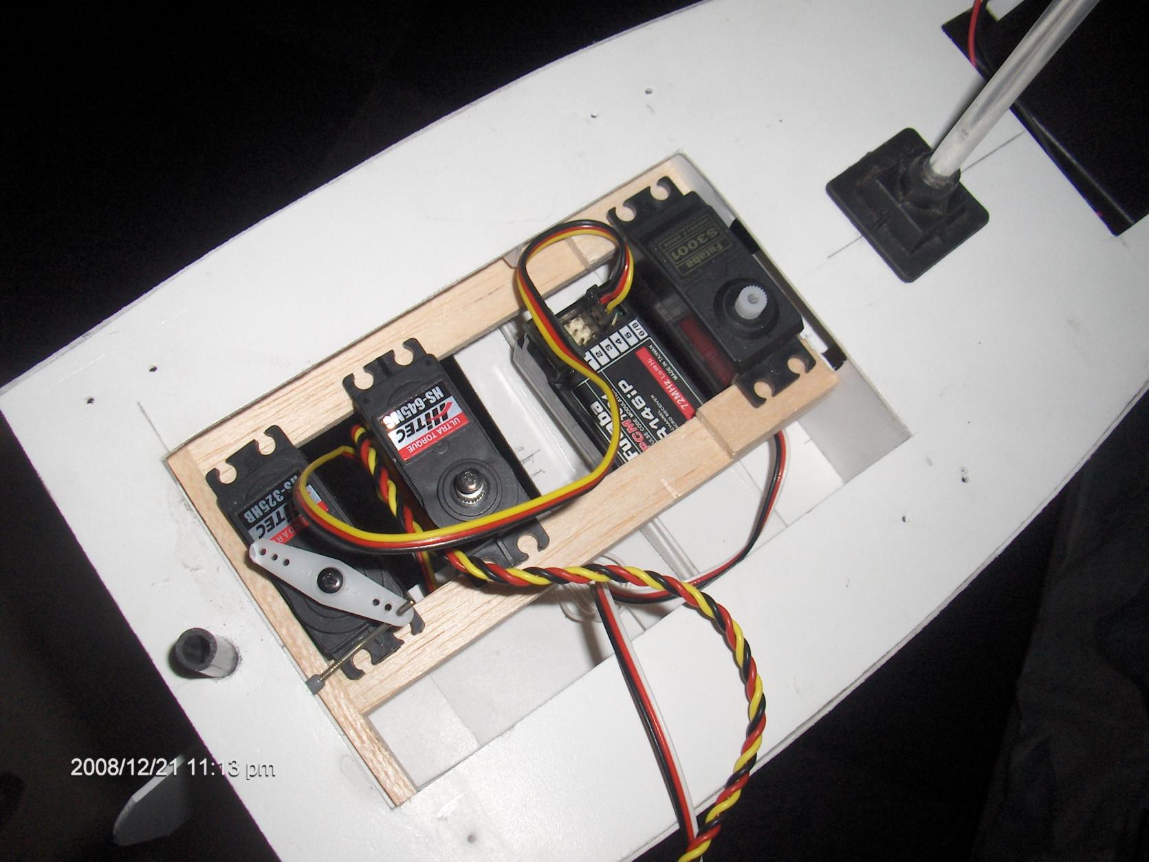

            2.The crewman that swing from port to starboard n vice-versa does any one know exactly how the servo n radio should be programmed. It definitely required 3 servos if I m not wrong.
            3. Do u think the weight of the man is critical in order to balance or counter-force correctly when she sail at strong wind. I intended to add two side floats to keep it afloat at all times.

              something is missing from your sailboat.
              the bottom cneter fin aka keel and the counter balance weight .. else it might just sink when the man sway from left to right.

                    Nice looking laser. If the figerine is heavy enough, you wont need a keel/buld counter balance. But for longitudinal stability, a short keel will suffice.

                        Hi Bros,thks for all the feedback n info.stage 3 in making the mast.using 3mm thick Aluminium Angle Bar and rivert pin to make the bracket. next to continue on th keel...
