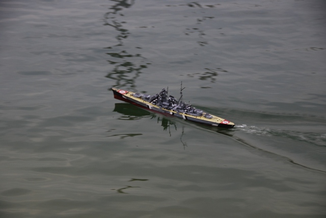

Q1: did you test your boat in BR?! the rocks seem to be like those on shores of BR...
AWS: Yap ..its proved
yon eyes are sharp
Q2: Heys just wondering...did the Nazi swastikas on deck have a red background or dark grey? some models did a dark grey overlay...
AWS: Even Bismarck only has a v short operation time before she was lost, but it has many paint scheme through that short period of time.
Lyon's attachment explan everything very well..be a player its good to knew all the history of you project before starting...the kind of respect will effect u to come out more idea...
Q3:looks like you have fix the 3 pcs deck into one large pc which make it easy for the gun control right ? However, I cant see any mechanism for the attachment of the deck. Just by snap no ?
AWS:its my first time to do ship, i used to play car and plane...so my idea may not be the best
1ST fix the 3 pcs deck into one large pc (before that installed ur gun rotation linkage and control servo the length of linkage must be pre set or ajustable : but one you glue the 3 pis into 1 no more chance to redo!!)
Q4: BTW how do you attach the deck to the hull ?
this is bigest problem for everyone who make a rc ship...
my way : dwll two hole on the each side of deck,and make the attachment on the hull, after that just used bolt and nut......
but stll not safe enough so !!! USE chewing gum to seal the edge from inside!!!!
