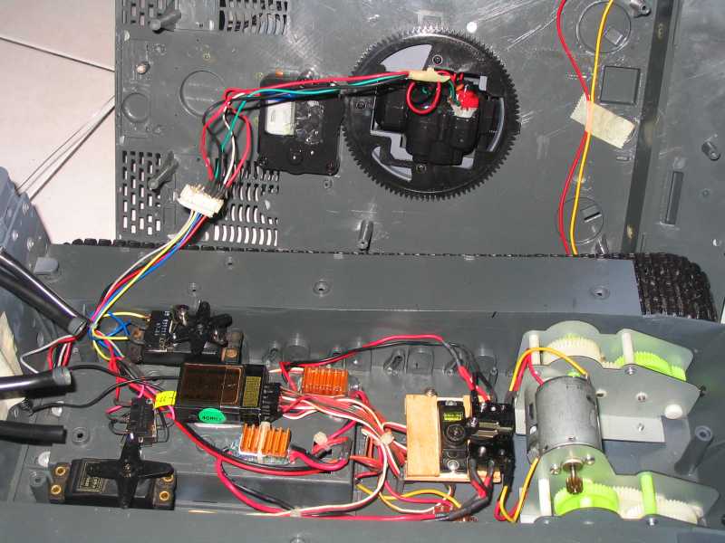

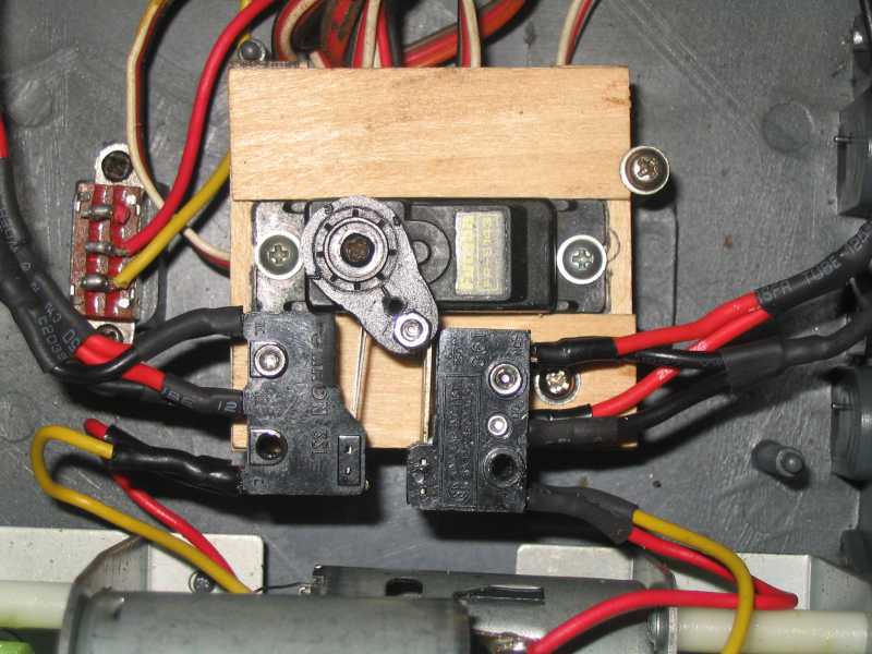

                        #56
                        Bi direction control is always an issue.....
                        single direction esc is so much cheaper....
                        So this is what I did to get a cheap bi direction function .....
                        nor esc (gws) + a mechanical limit switch....
                        Pic of my toy tank with such arrangement ......work fine for me

                            #58
                            Originally posted by BabyBoy
                            Have check out GWS ESC but it dun have a reverse function(may b I'm wrong). Tug boat need to be versatile to be able to do rescue and tugging... he he, that it should have forward and reverse capability... As for prop and shaft can get from NTC(got my self one). Then again need to Mod the connection between the motor and the shaft... any idea?
                            ya me have the same problem with all those plastic model ship.....
                            as the "join" is all of rubber tube ...... well just for a toy boat function it is ok but long term rc operation is ......totally unacceptable......
                            cant find super small ball join for 2mm shaft......so stuck with rubber tube

                                #60
                                that's cool...but ship got space mehs?
