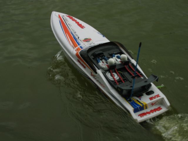

    This is my Villian Ex with a cockpit set I took from my Tamiya rally car. I cannot tahan the look of these open cocpit boat anddriverless! Ghost ship?!?!?!

    For a while I was wondering how come your Villain EX is different from mine.

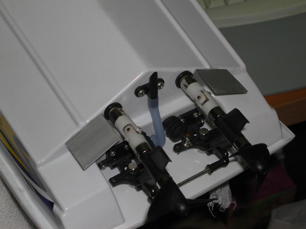

    My mods are
    1) Cooling coil over the motors.
    2) Trim tabs to reduce porpoising.
    3) The said 'condom' to reduce water in the hull.
    4) I've also lined the hatch with some foam to further reduce water seepage.
      My mod (akang datang):
      1. Trim tab / turn fins
      2. Motor cooling
      3. Auto bailer
      4. Octura Props
      5. Apex twin motor ESC (My EVX got fried )
      6. Blinking lights

        Sounds cool but there's not much space for the turn fin. However, I think it will definitely help the cornering. Mine tends to oversteer.
        You'd also have to be a bit careful about the autobailer. The hull looks like it's a double layer abs with space in-between the layers. Not sure if an autobailer will work well in this case.
