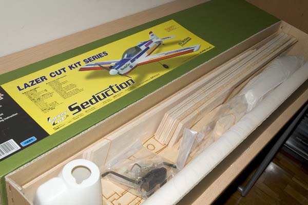

    Nicely packed planks of laser cut balsa, all nicely bundled together. Hardware neatly packed in individual bags and rolled plans is what greets you when you take off the lid.

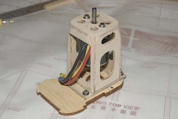

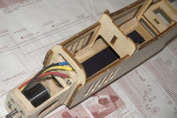

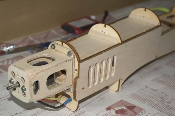

    To house the Axi 2820-10, I made a motor mount from 3mm ply. To allow for the possibility of a rear mounted Axi 2826-10, I made the mount removable. Here is a picture of the mount, sanded and ready for fibreglassing.

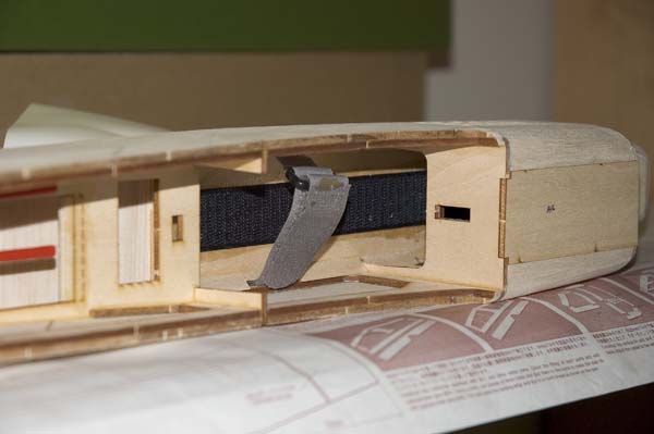

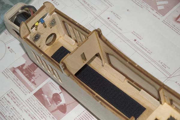

    Besides the motor mount, the next area that will require modification is the provision of a battery mounting tray. Here, I used a laminate of 2 mm balsa with 1.5mm birch ply for lightness and strength. Slots were cut to allow velcro fasteners to be looped.

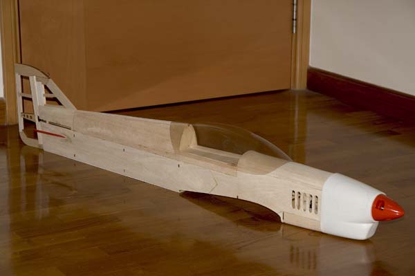

    To provide adequate cooling for the cell pack, I cut slots on the fuselage sides.
    The finished battery mounting tray complete with velcro loop.
    Fuselage ready for final sanding. Wing construction begins next. Weight with Axi 2820-10 is 17 ozs.

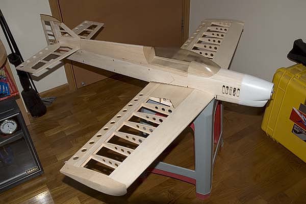

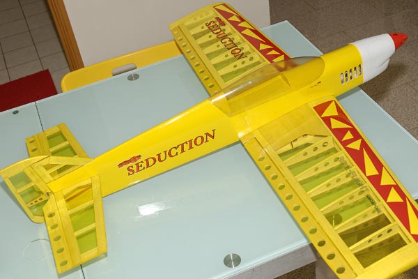

      Progress very slow due to limited opportunity for building this month. Finished the wing (well almost). Still needs carving of wing tips and final sanding.

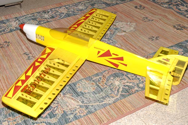

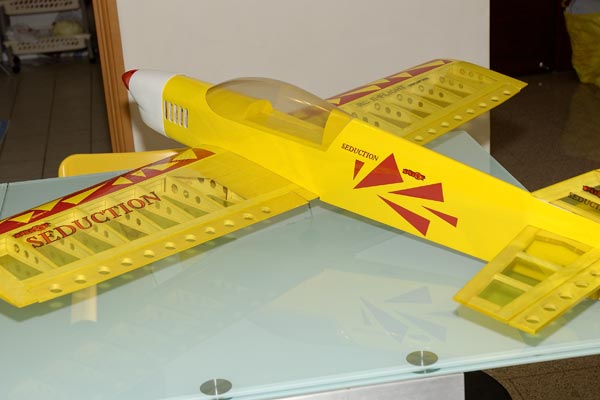

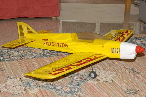

        Its been almost two months since I've done any real building - the Jazz was a slap bang job with two slabs of foam bundled together with strapping tape. Missed the smell of balsa dust and scorched Oracover Lite. So with a couple of free evenings, here she is.
        Monokote trim and self made water slide transfers finished the job.
        She'll start with an Axi 2820-10 on 10xGP3300 and APCE 12x6 to begin with. All up weight with the above set up is 60.5 oz or 1.716 kg.

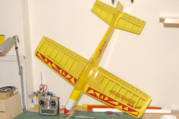

        To give an indication of relative size, here she is with a JR9x TX

              your motor mount is the most amazing!do you have a jig saw to cut it so nicely?
                  Yup. Used a Dremel jigsaw. Noisy but a good workhorse for over 10 years.
