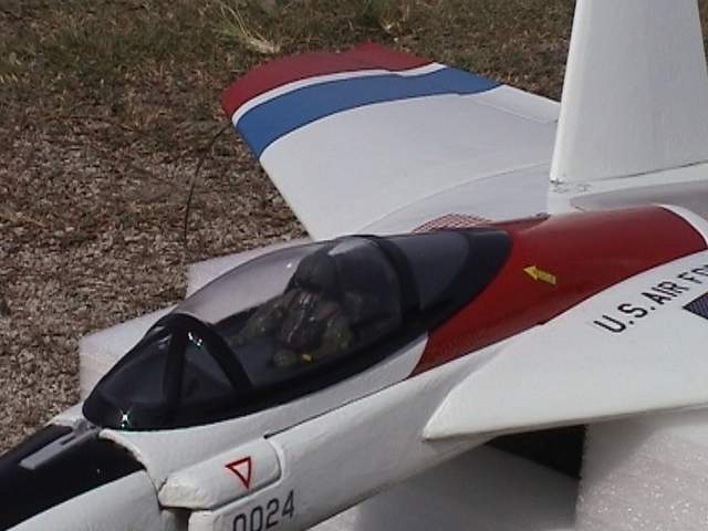

    It fly and roll better than the EP10 pusher coz the wing span is smaller.
    The best set up for this plane I had tried, is with a wemotec 480 and 2 turns BL motors..
    I am using the Rcer warp4 2turn, with 2p 3s1800 drawing 42amp at full throttle and its doing at 132km/hr . (taken with a speed trap device)
    Attached with pics of my interceptor..
