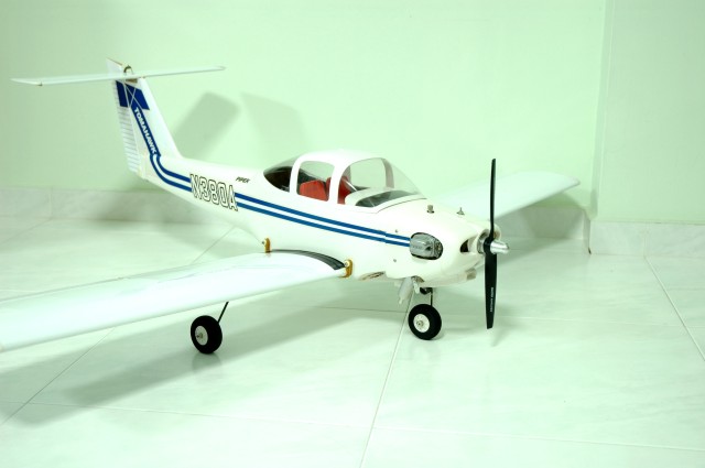

    The plane is now 2.1kg with Enya53 4C without cowl and still feels a bit tail heavy and cannot float well during approaches. It also has obvious resonating yaws when power is induced but quickly fades once accelaration is peak.
    It used to be 1.8kg with 0.28 engine n without cowl.
    For now I am doing hot landings but most of the time prop hits ground and halts....

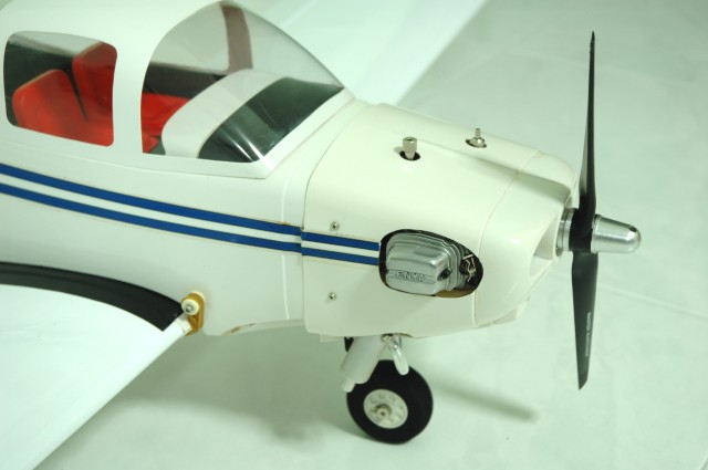

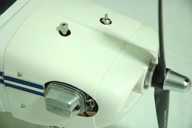

              Had some time to finish off the cowling. The engine is oversized, so naturally, there's a lot of projection.
              The cowl is retained with four servo screws, fastened to the ply firewall.

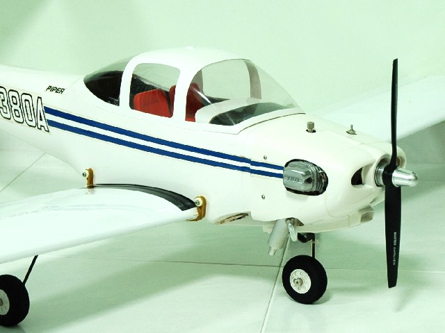

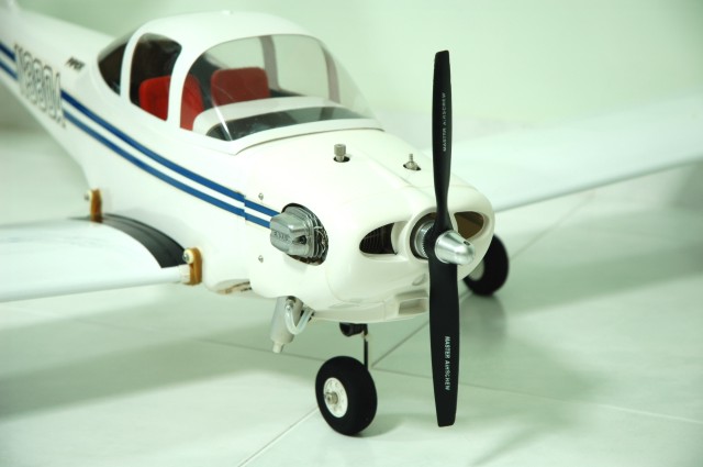

                Somemore pics of the cowling.
