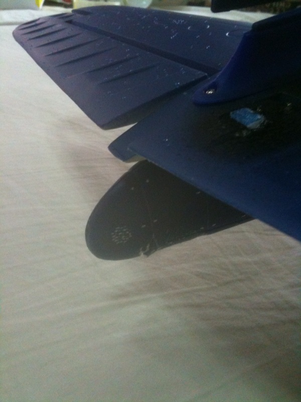

    I think Corsair F4U is the all time best looking WWII plane ever, maybe cuz its the way the wings look,...kinda like the minimoa just inverted...anyway, this is the tail section of my Corsair,..wingspan 1m by Art Tech, this is how much elevator I have to adjust to make the bird fly level,...I was wondering if this problem is common throughout for this particular model or maybe just by this particular manufacturer...(my CG is balanced perfectly so I know its not nose heavy)
    hi, a couple of stuff to figure out:
    -Did your CG location come from the manufacturer's website/book/manual etc? if so, check on RC groups or simply google the aircraft for its actual CG location via forumns or reviews, because occasionally, the manual gives a nose heavy CG location.
    -Try moving your battery back 0.5cm at a time, after afew flights, you'll get the right CG location. Either that, or add a weight on the aircraft's tail area (i dont recommend this if you can move the battery around). Its not really safe, but its what i do. and its kinda working on my edge 540.
    goodluck =) but you really shouldnt be flying with so much trim...
      If the elevator surface is aligned into the groove and mounted right, I would level the elevator fin with respect to the surface.
