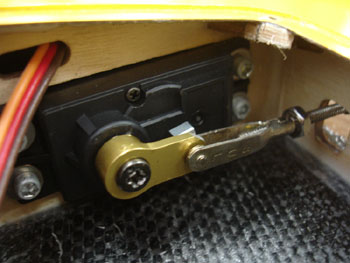

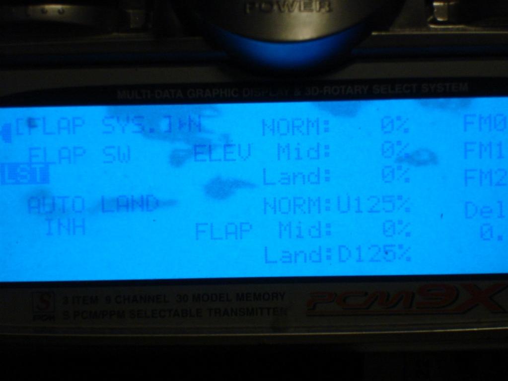

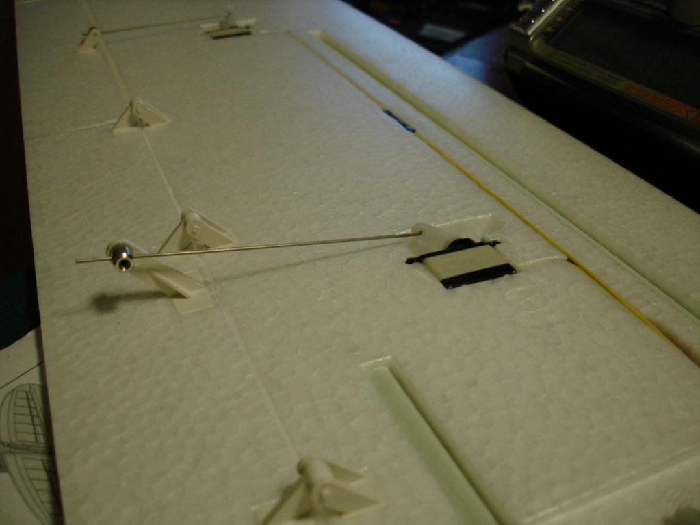

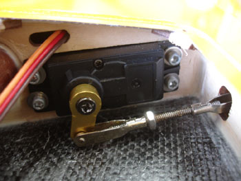

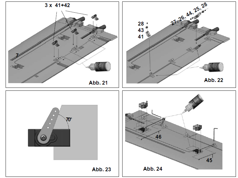

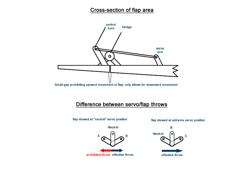

The manual states that we should set the flap servos to “neutral” and fit the control arms at 70 degree position before securing them to the wing. My question is, to achieve more flap throws, would it be more logical to set the servos to a maximum throw and fitting the control arms at 70 deg; instead of setting it at “neutral”?
Are there any negative set backs for using this setting?
