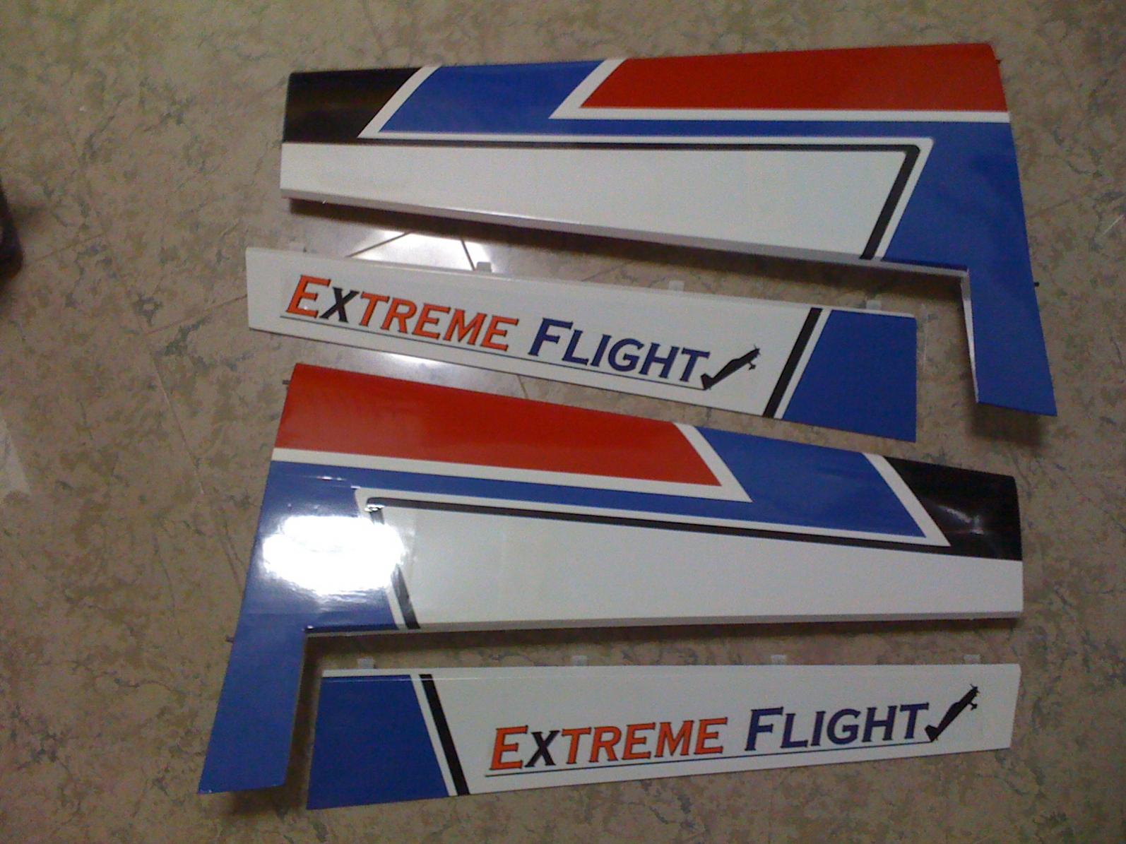

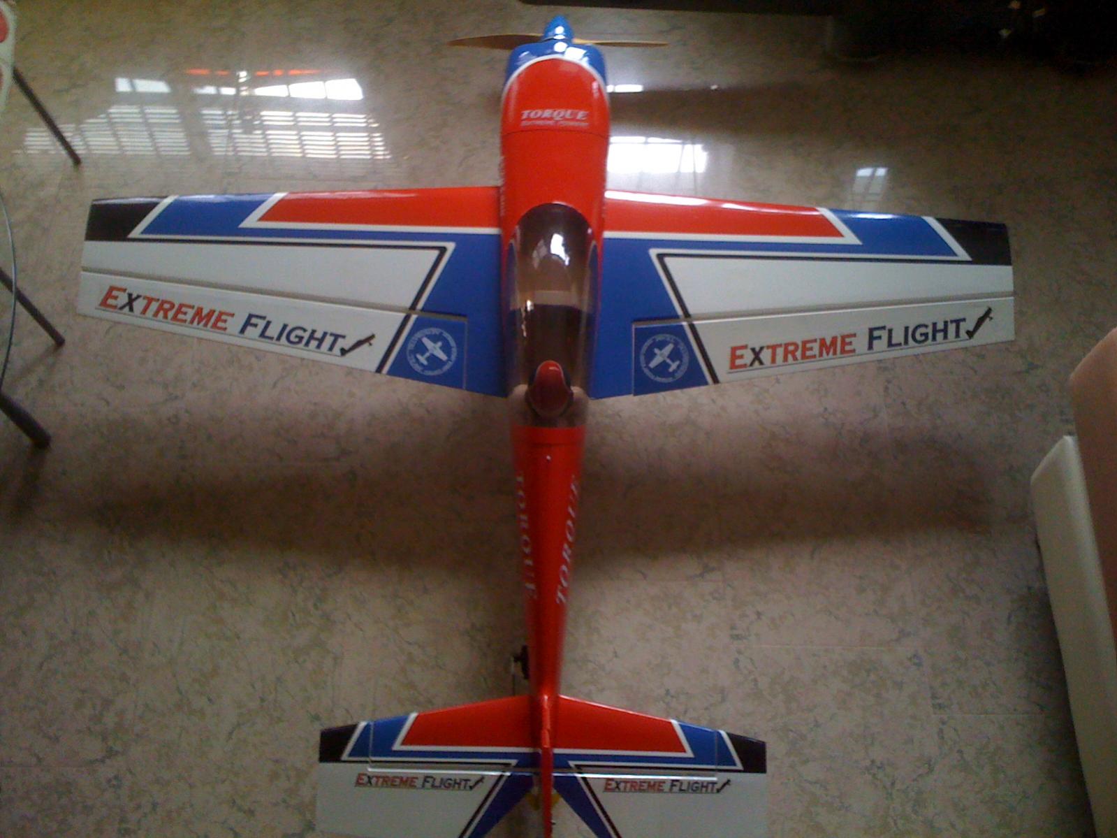

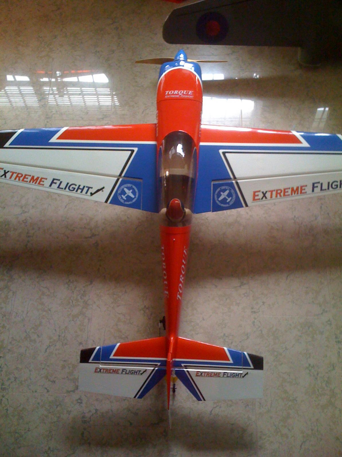

    extreme 58"
    i got tis babe, i can say 'EXCELLENT'
