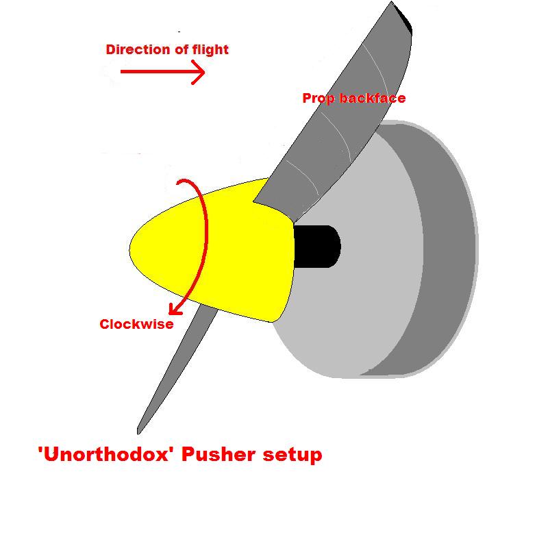

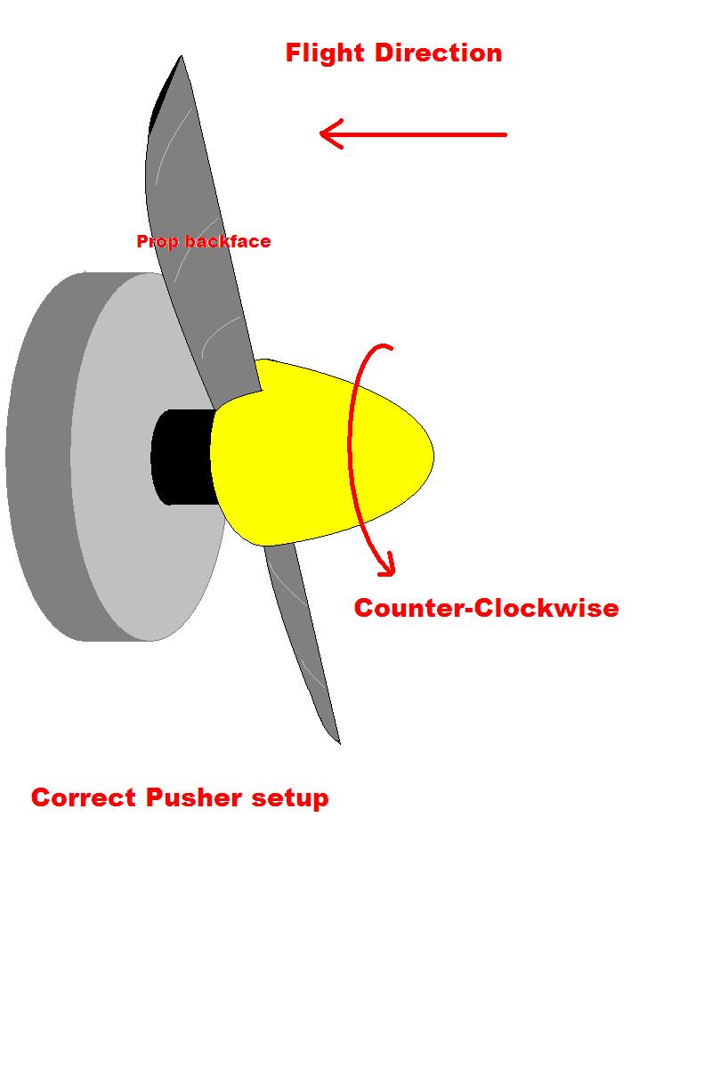

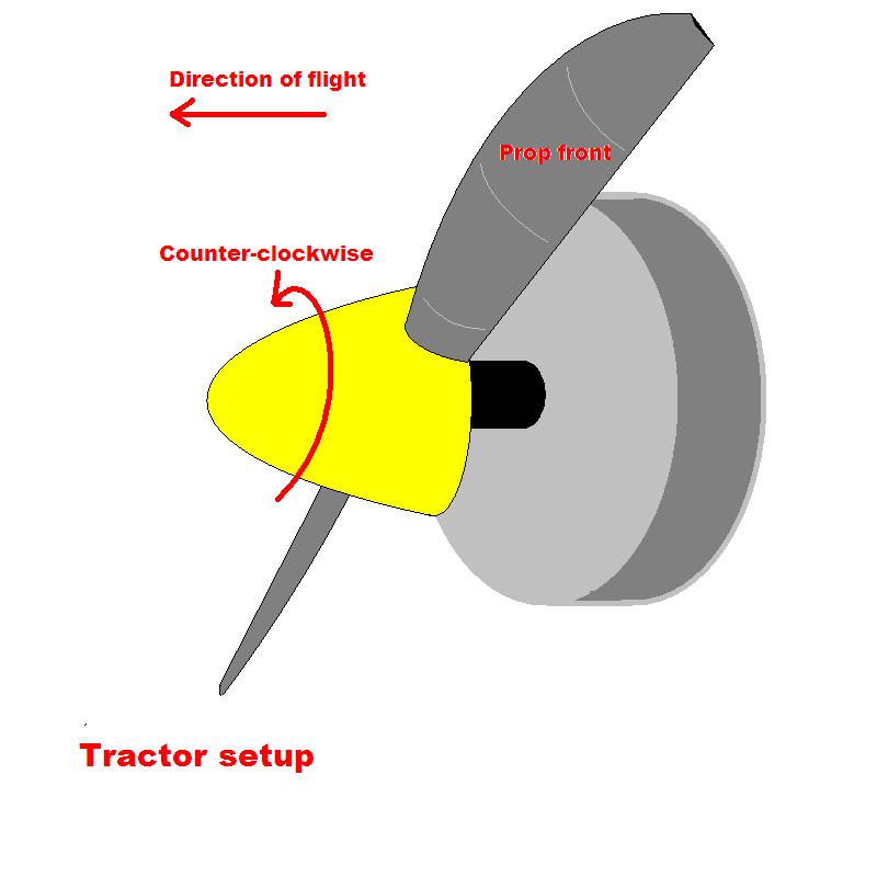

              Errrr.....before more and more confusing and irrelevant factors come in, I think I better show you the sketches. Forget about torque,weight, paraglider or not at the moment, and just to talk about how to make things work. It is the same for any fixed wing aircrafts, hovercraft, etc.
              See for yourself. Pay attention to the prop orientation and rotational directions.

                  Nothing confusing. What Joe showed is correct.

                    So Joe if my setup for pusher is like drawing 2, my prop rotation will have to be CCW, right??? with the prop nut locking in CW direction?

                      Yes. that is right. Sketch #2 shows the commercial pusher prop used for pusher setup.
                      However, I am not very sure about your actual setup. It is best that you post a picture to verify.

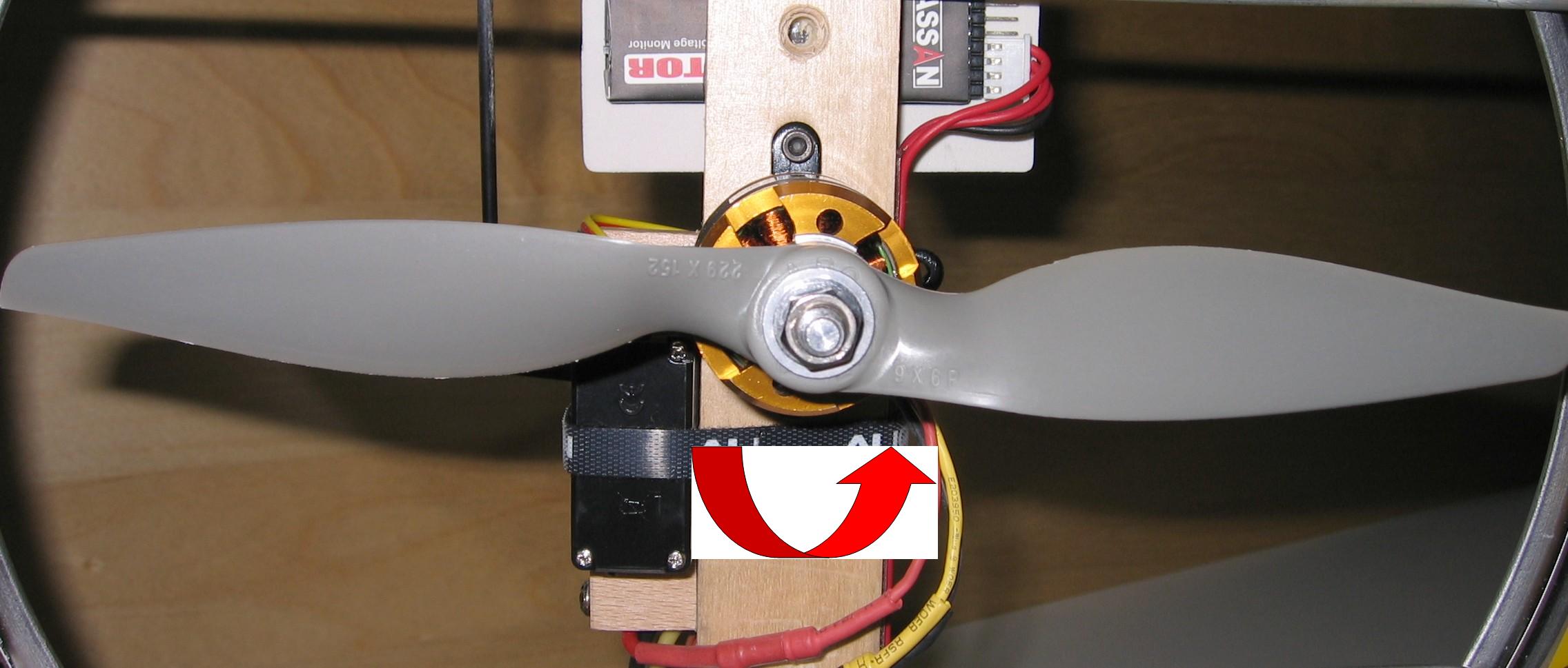

                          Bro Joe, pic of my pusher, CCW (arrowed), is this correct?

                              Yes, you are using the setup as per sketch #2. Thus, the rotational direction is also correct. However, your prop is still mounted the wrong way. In this view, you should see the backface of the prop, not the numbers.
