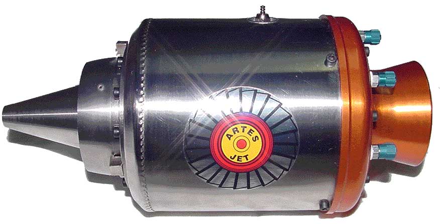

          Nice picture Albert that 's the old Artes Jet turbine? the new one should be the Rhino 36lbs. BTW, awesome picture on the other post on the F-15 by SM

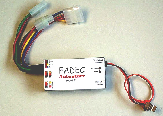

              Re. stall -Jet turbine works like a automatic transmission car. it wont stall!
              During the start up, either a manual or auto start turbine will ramp up to 55K rpm, if it is a successful fire-up with the input of starting gas, the ECU will bring the turbine to idle stage with ard .5lbs of thrust o/p. At any events, if the rpm fall below idle stage, the turbine will cut off, as this should be signs of malfunction parts or fuel lines problem. Normally 35k rpm is the standard cutoff point if the turbine rpm go below idle rpm.
              For any flyers, it is necessary setup procedure for TX to operate the installed turbine, The lower throttle stick will learned the idle stage of turbine output, and the higher throttle stick will learned the max. stage of turbine output. Therefore nothing beyond this range is attempt when throttle stick is! This logical because what you want is min o/p to stop a model or full throttle at max. o/p to lift-off a model.

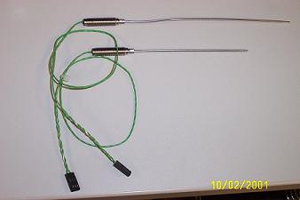

              Re. overheat.
              There a temp probe hooked to the rear exhaust cone of a turbine, this is to detect the o/p temp, normally operating temp is ard 550 oC to 650 oC.
              Any temp higher then stated temp, it will automatic cut-off by ECU. Therefore dont touch any turbine after flight, and sometimes you will see some flyer using ext blowers to shorten cool down time.

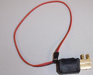

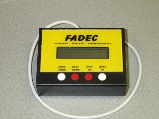

                Various keys parts!
                ECU-Turbine CPU
                  Gas & Fuel Valve!
                    Hand Held Data terminal!
                      EGT-Temp probe for exhaust cone
                        RPM sensor! Hall Sensor type!
