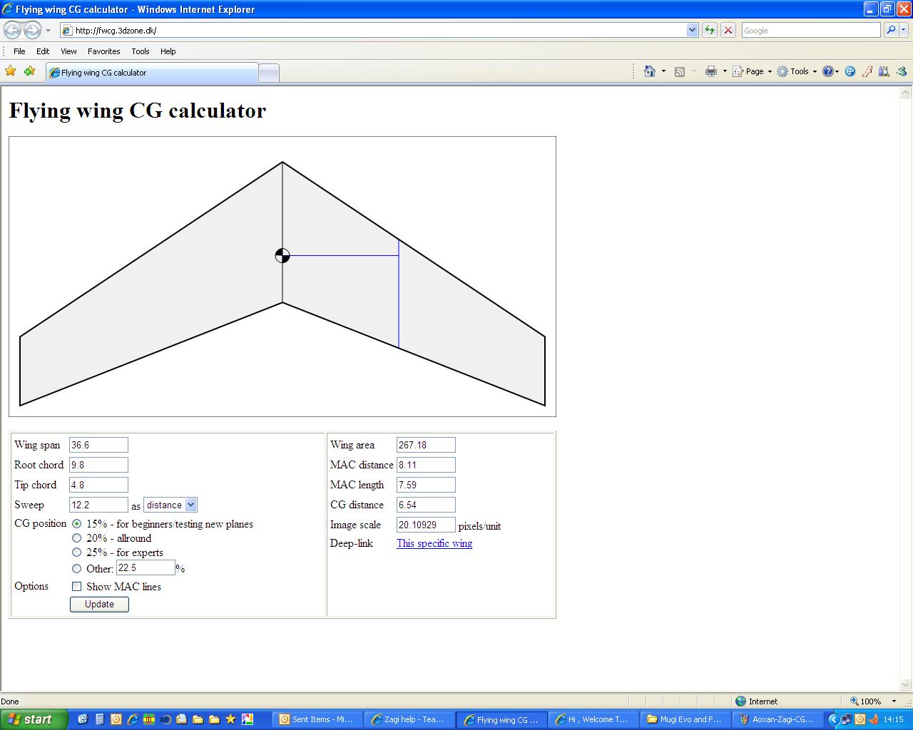

                  I have two problems, where is the CG and what motor is suitable?

                        1)The trust line of the motor is wrong need to be till with little angle because as you power more than 30%, the wing nose heading up. It must fly in level flight as speed increases. (wrong C.G on the zagi wing will cause the model to fly with the nose up dwn, up dwn like dophine fish). C.G. far back will keep flat spin. Nose heavy will have to keep pulling up elevator or very much up trim.
