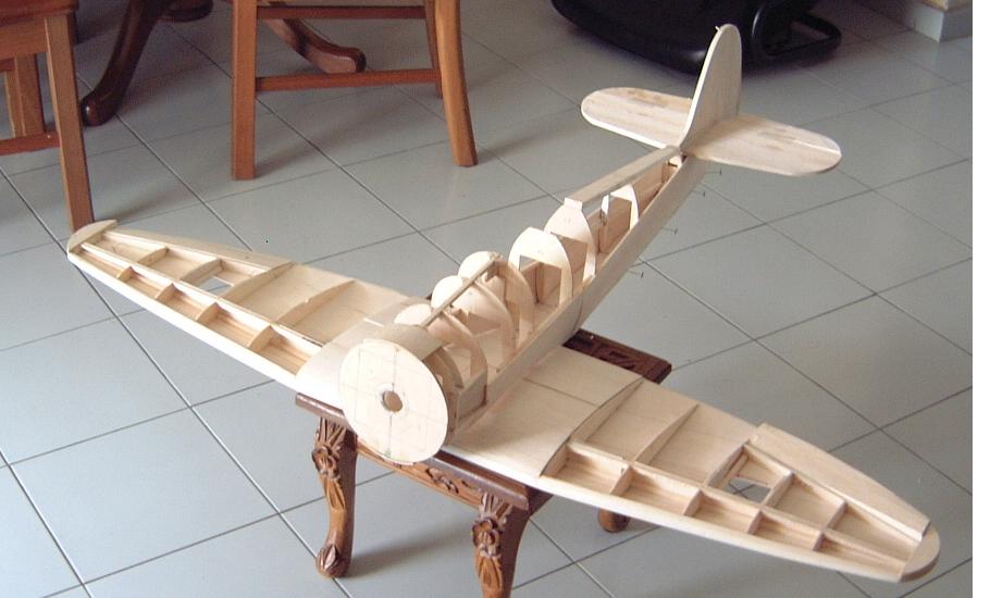

                the marjor construction of the wing is done.. had an accident and broke a rib.. which u can see in the pic.. now wats pending is.. i trying to figure out where to mount the wing servos.. haizzzzz oh y and i also did a pre fuse construction in 3d just.. for a preview .

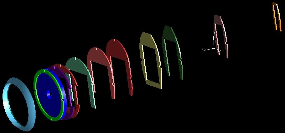

                  update on the CG_Furry .. maan alignin the parts took more time than drawing them out!
                    #39
                    hmmm...the polyhedral wing looks prettly well aligned, great effort. ....but seems difficult to visualize the fuse from the 3D model..

                        been a while.. the damn fuse was a real challenge to align not sure if its dead straight but i tried my best to align them.
                          #42
                          Very nice... ...maybe build in the retract mounts so that u only need to open the wheel wells when ready to install retracts....
